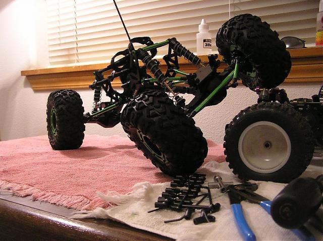

Chassis is together...took about 8 hours to do though. I'll put up some pics in a bit. Everything looks pretty good on it but there are definitely a ton of mods to do. I am going to 4-link with longer uppers and going try some kind of partial droop shock setup...not sure what yet. Probably a soft outer spring combined with an internal spring under the piston. I still can't figure why they send the stiffest springs with the kit...they are rediculously stiff:rolleyes:
Here's the pics everybody has seen a million times already

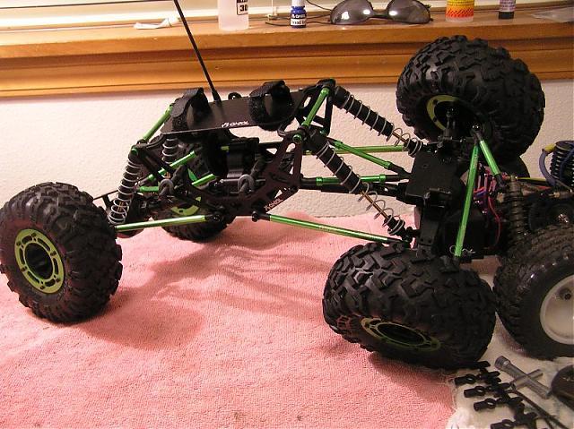

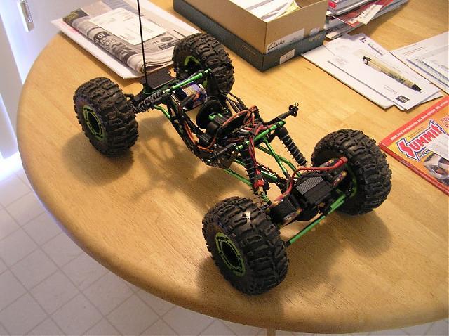

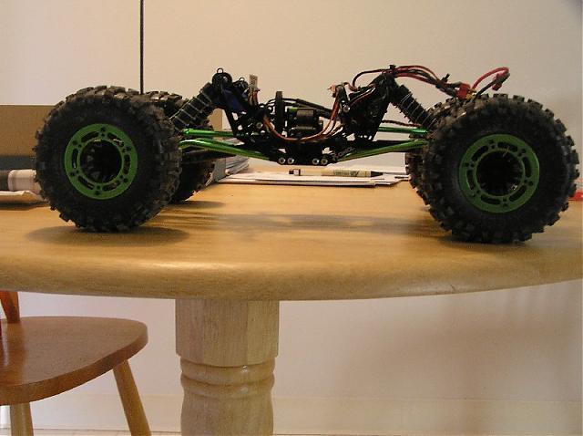

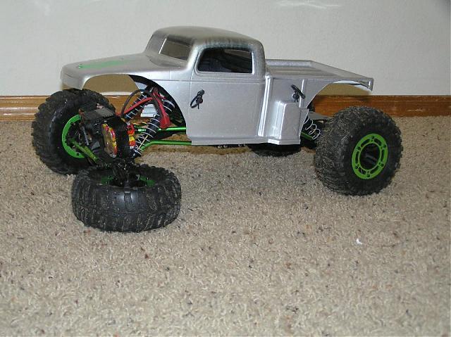

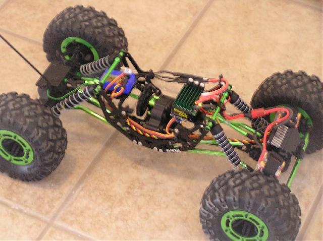

Alright...building time on this has been few and far between but it's in a little more respectable state now. Electronics are installed and seem to be working fine. I need to see what update is on my Mamba Max because it is a little glitchy sometimes but that could just be me trying to get use to a brushless motor. The shocks got some medium springs in the rear and super soft springs up front with internal springs all around to lower the ride height. I kept the upper y-links for now and just extended the links stage 2 style and inboarded the lower links. It has quite a bit of rear steer when flexing and seems to be some torque twist when really bound up but not sure if it will affect it yet. I also need to flip both my plates that the electronics are installed on upside down to get things a little lower. Throw some better tires in the mix along with some weight on the front wheels and a body and she should be ready to go. Not real wild about the Betty body though
Here's the gratuitous household shots as it hasn't seen any rocks yet

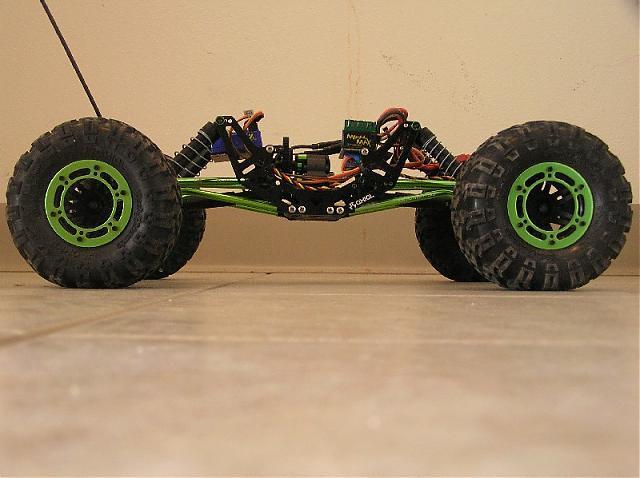

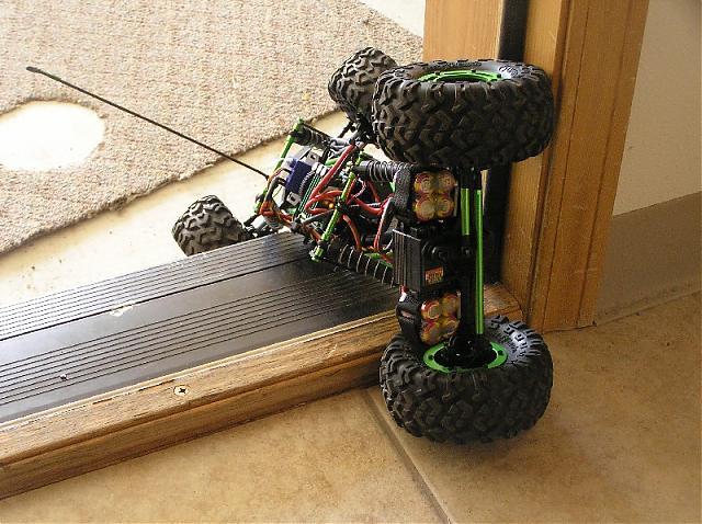

Alright...well I've been tweaking like crazy trying to get this thing to crawl better and don't know what I did wrong but it's worse than before at least indoors. I lengthened the upper links and inboarded the lowers. I added 6oz of weight to each front wheel and 1.5oz to the rear wheels. Also threw on a set of Losi Claws and modded the foams a little. What happens is if I pull straight up to a vertical surface (like a wall) it won't pull itself up but if I back up to it the rearend shoots right up it. Almost like it's too much weight on the front to get up it. Any ideas?

you have too much weight up front. Go with 3oz's on each tire up front and 2oz's of weight on each tire in the rear.
I knew somebody was going to say that...time to take the beadlocks apart again...hahaha
I was reading that people were putting up to 7oz of weight up front with good results but that just seems like too much to me. Especially after I did it :haha:

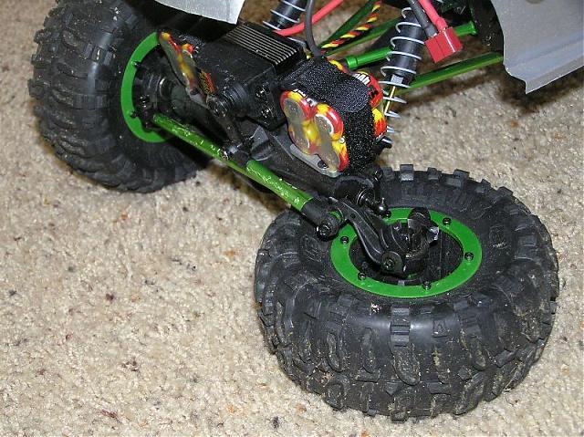

Another update.....1st CARNAGE!!! (well second but the first was a measily rod end). Finally got it out on some rocks to test things out. Found a wicked place that runs along the river down here. Dropped the front end in a hole and was walking the front wheels back and forth trying to get traction and bam...exploded C knuckle. Overall it seems to work pretty good. The belly drags alot at 2 3/8" ride height but I like the stability of sidehilling it has. I am going to convert to a traditional 4 link with the next round of mods to help with the flex steer and maybe tone down the torque twist a bit. Still doesn't climb the way I would like but maybe I was expecting too much. Radio got two new pushbuttons installed for a hot new addition that should have this thing pretty much comp ready. I may try to hit the next ORCRC one out by me if the parts get here in time. Damn this thing is addicting :D
