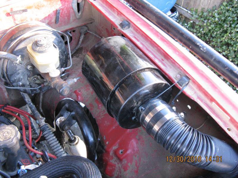

As for your question about the air filter, I haven't nailed that down yet. I have a filter I just need to get a tube bent up.

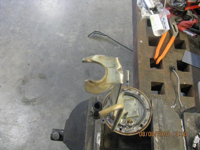

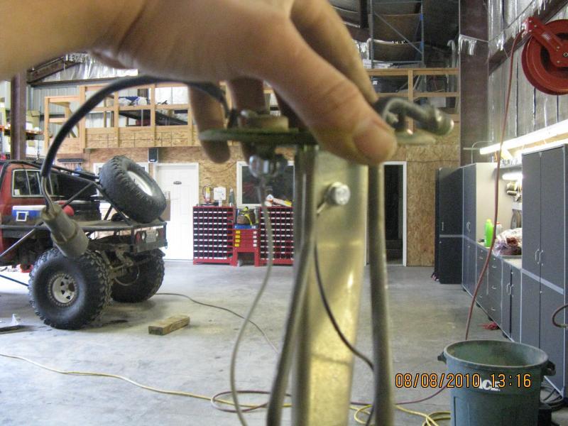

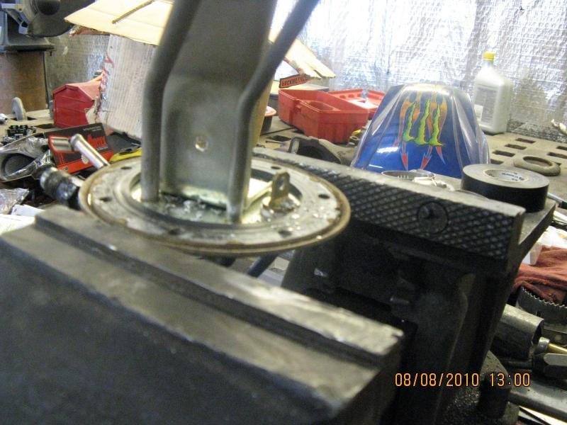

Ok so I took some pics since this is a "build thread" just in case someone else wants to mount the pump this way.
After removing the Toyota pump I drilled out the rivets that the wires attach to.
Then I spread out the bottom of the mount so the new pump grommit would fit. I ground the sharp edges down so they wouldn't cut the new strainer.

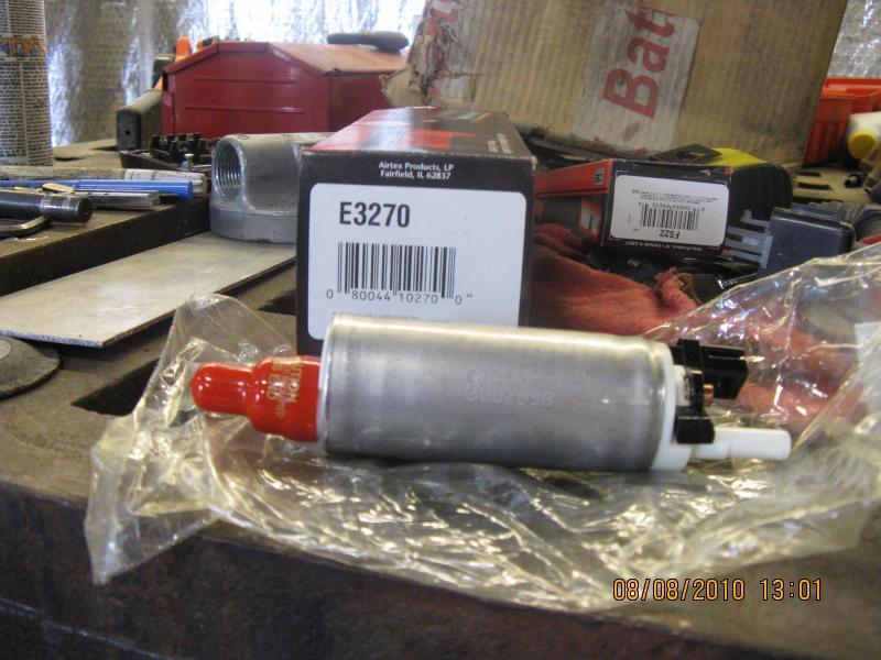

I used an Airtex pump. A stock replacement from a 95' S10 Blazer.
I put a piece of fuel hose behind the pump and added a hose clamp to secure the pump to the mount.
I attached the GM wires using 6mm bolts and whamo I have a new GM pump in my Toyota tank

So I installed the new pump and checked the fuel pressure. It builds to 60psi and holds when the key is off. I hit he key and it started within 5sec:cheer:

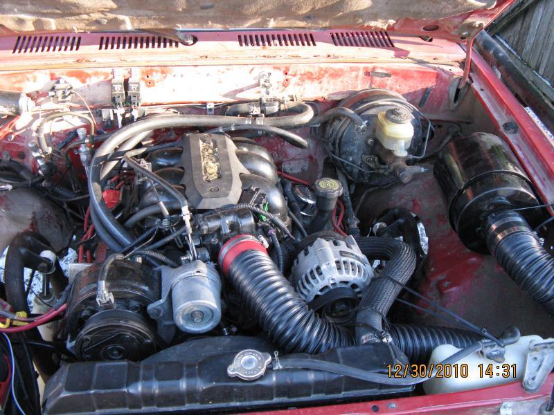

Just a couple of pics.

I guess we'll find out tomorrow! She still doesn't seem to run purrrfect. But I haven't really opened her up to clean the plugs off. Spent a lot of time idling running very rich.

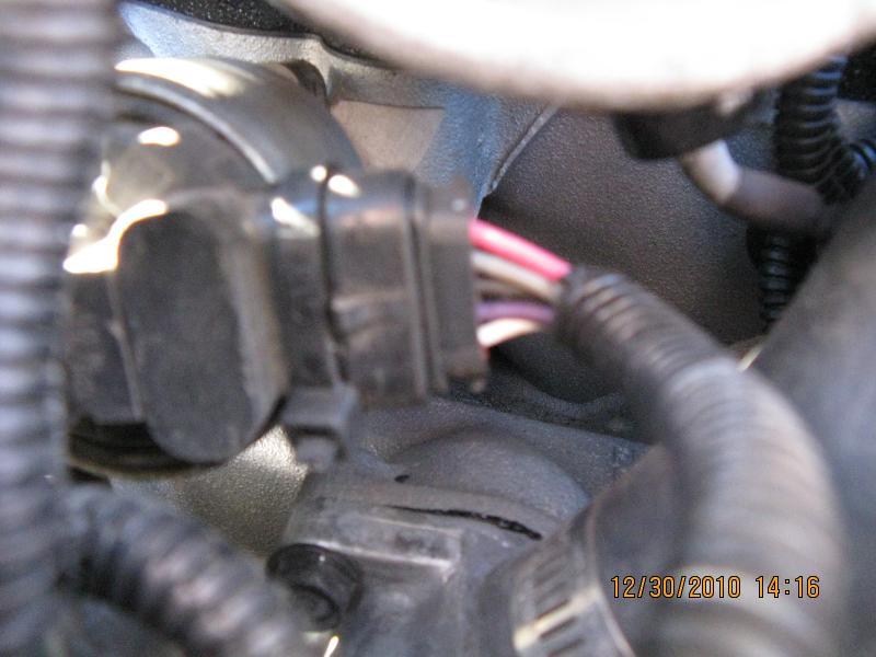

Crash do you have a wiring schematic for the EGR? The plug on the howell harness is backwards. I called Troy and he said it's a 92-93 not a 94-95 motor and the plugs were different but the way I have it plugged in should work. Notice the lock tab is on the back, opposite of the lock.
Also, WTF is supposed to be hooked to the vacuum port under the throttle plate? I have it plugged now.
For a 92'
Terminal A egr control (A3)
B Sensor ground (A11)
C Pintle position signal (D8)
D 5v reference (C14)
E Ign feed (A6)
Is the port like 1/2"?
Thanks :awesomework:
No, it's the 1/4" nipple sticking out the bottom below the TPS. You can see it in the pic just to the right of the EGR wiring.
Edit: the hole may be 1/2" but there is a black bushing pressed in to neck it down to the little metal tube.
