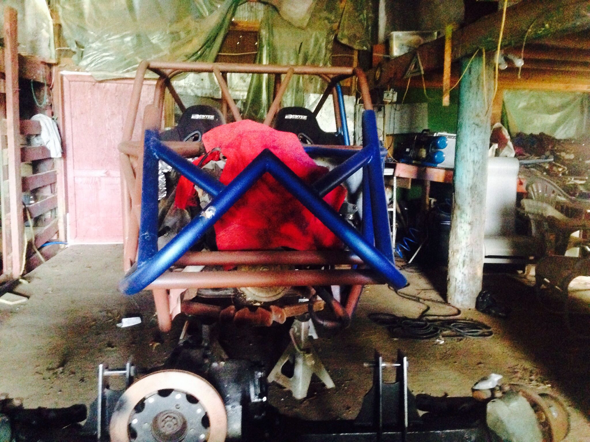

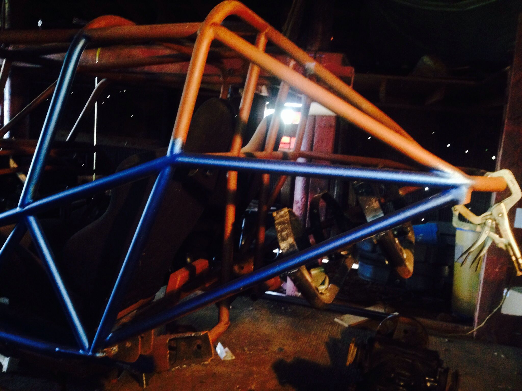

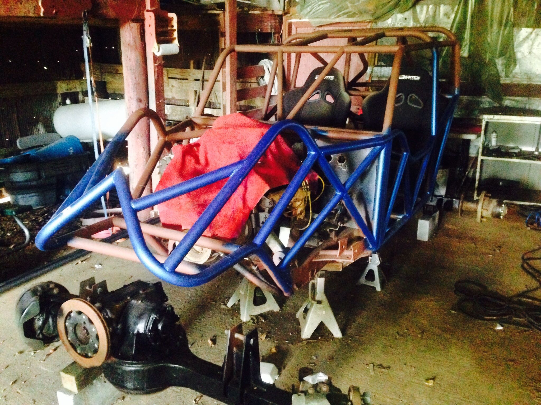

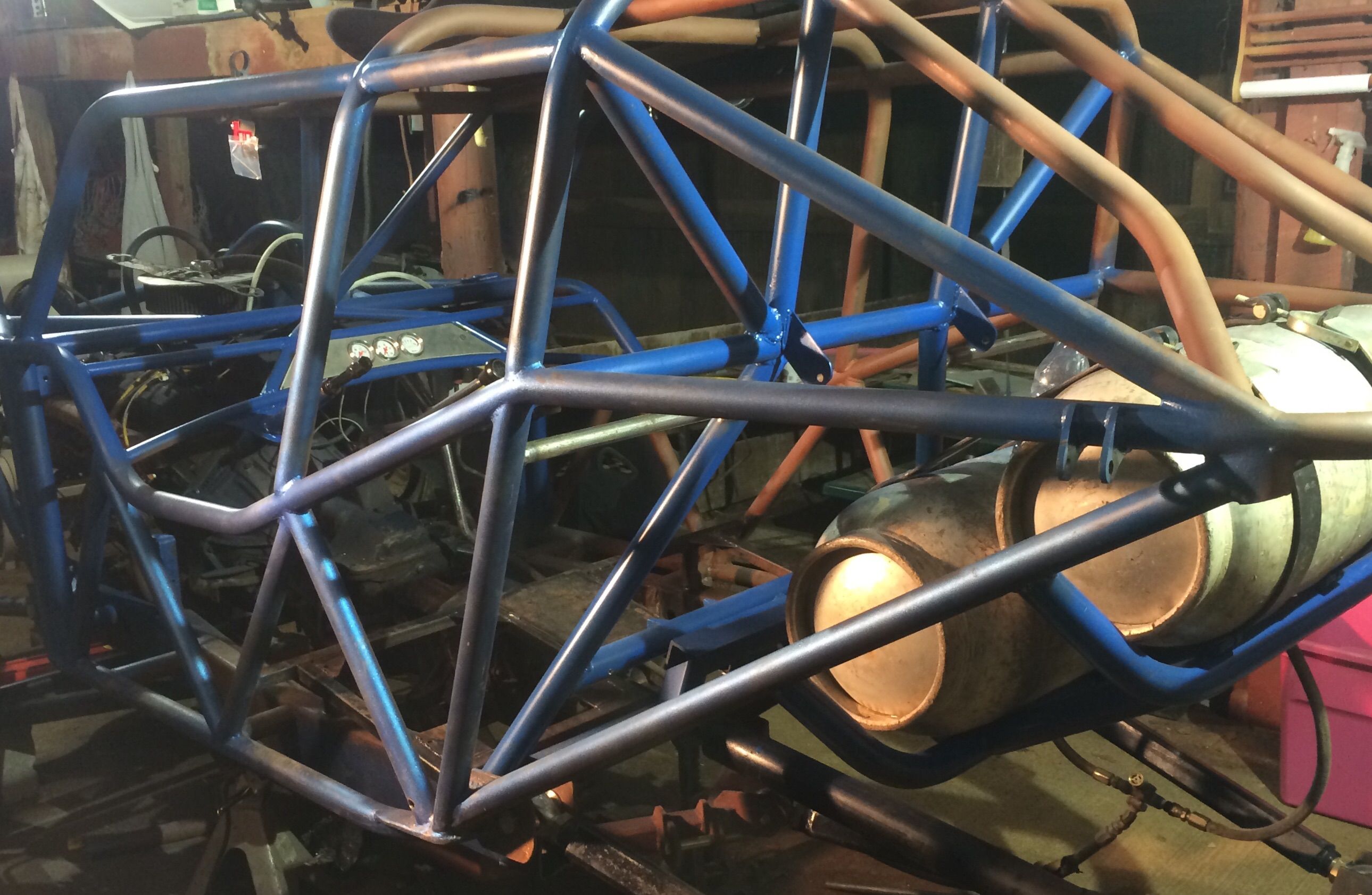

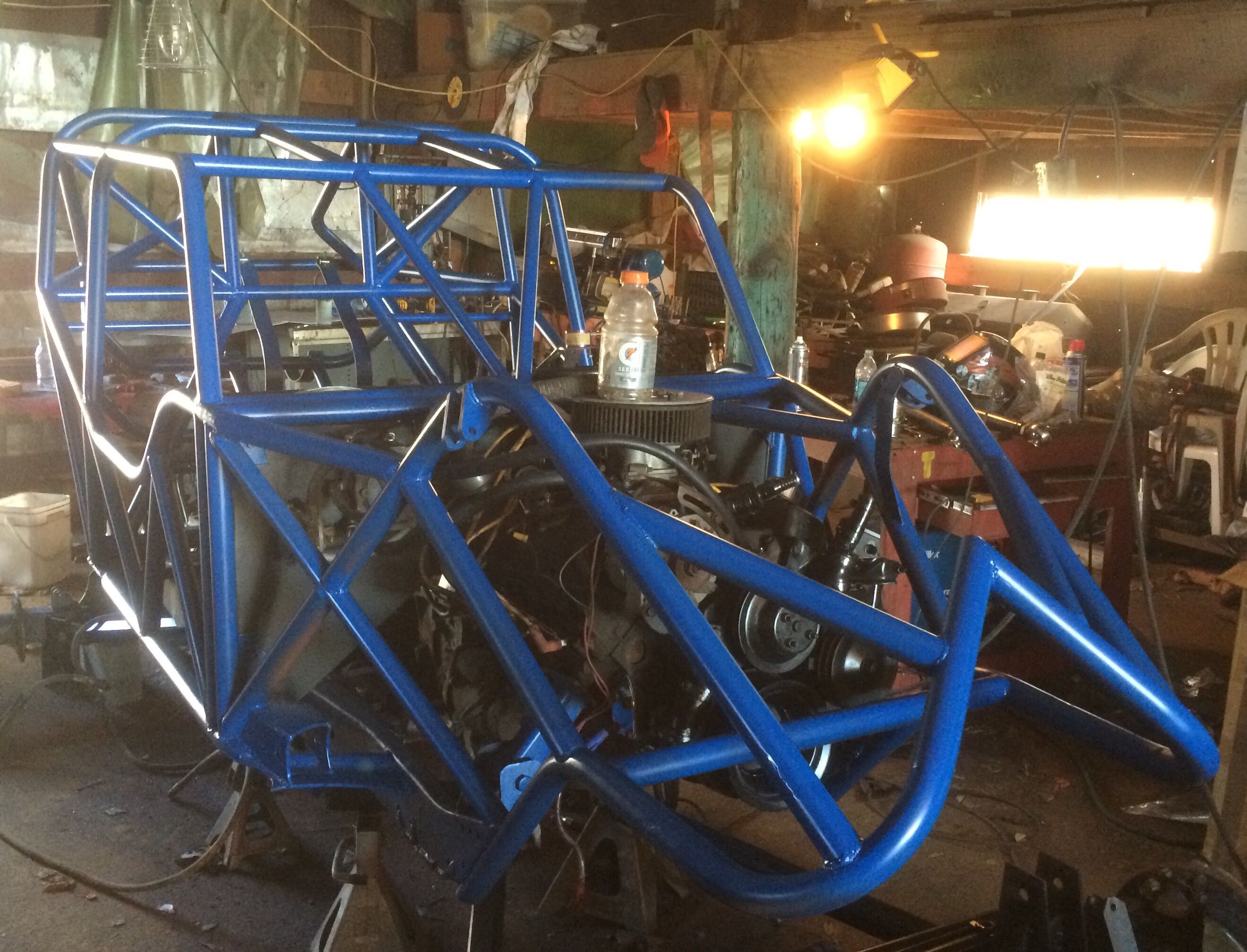

So my build got put on hold for 4 month. But I'm back at it here's how I left it.
I know I probably violated some buggy building code, but considering it was going to be left for month I primed it and sprayed one can of blue on it.
I let my 5 year old daughter pick the color she went with sparkly blue.

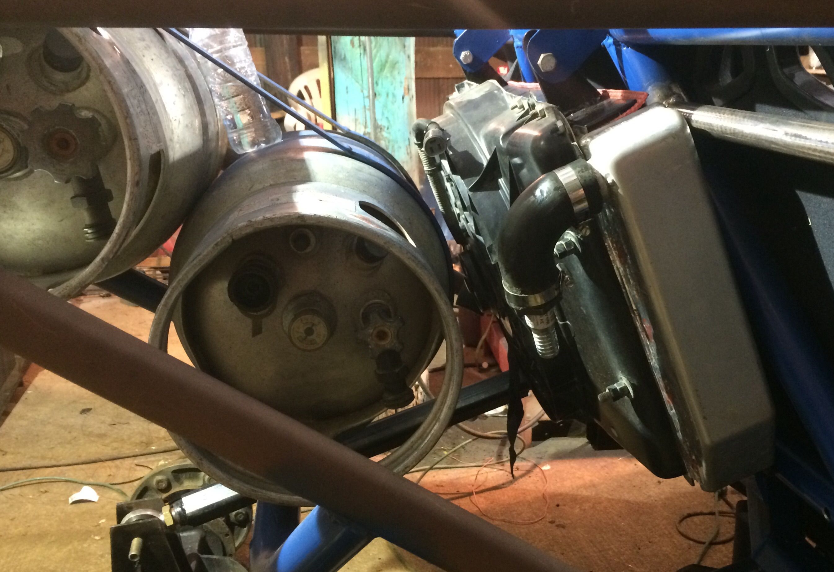

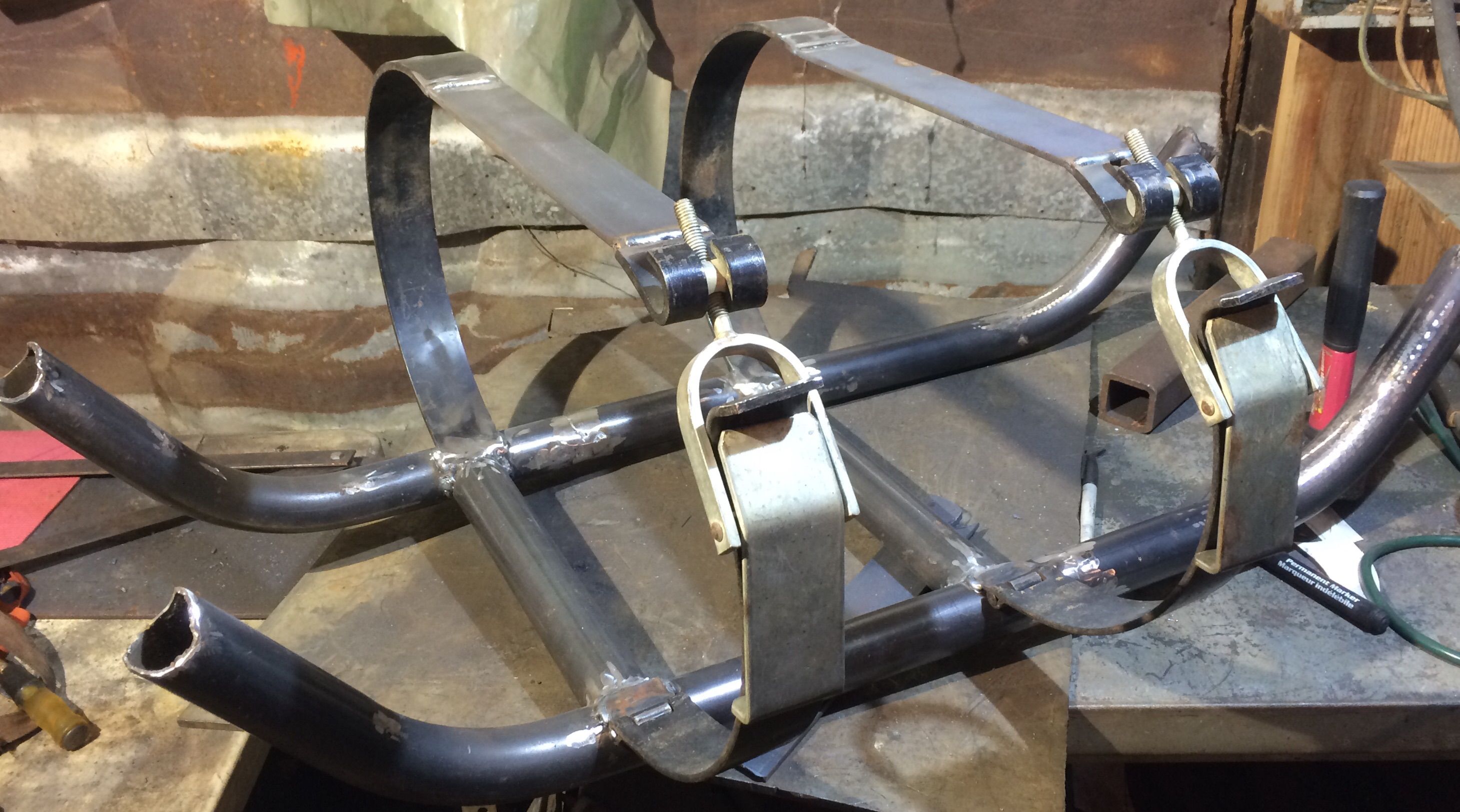

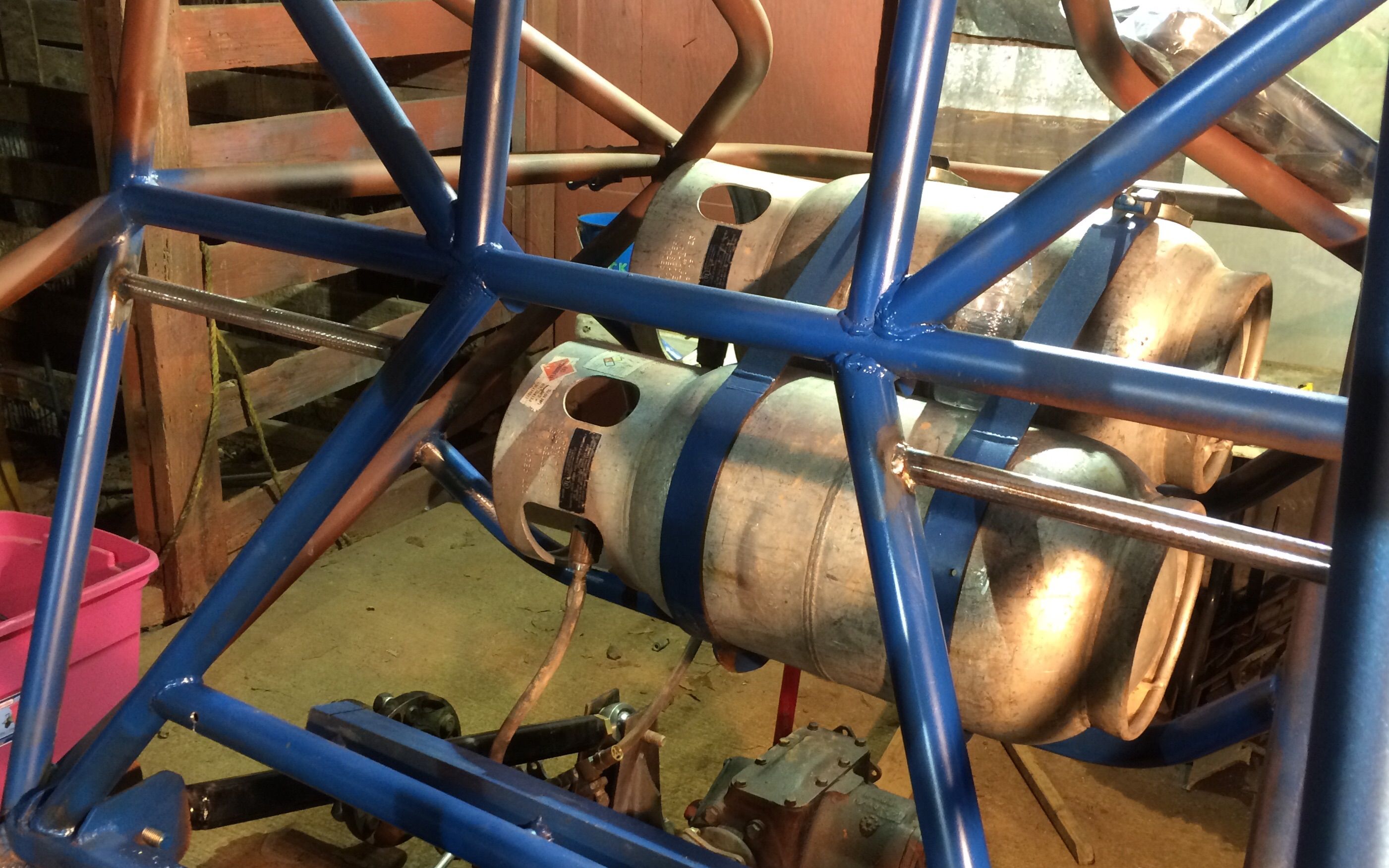

So the last thing I did was make propane bottle racks. The bottles will set at the same angle of the lower bar with valves pointed rearward. After thinking about this I'm unsure if on a steep climb if they will starve for fuel.
Set my axles at full bump it looks like axle center line will be 5 inches higher than the belly. So if it's on a flat floor at bump belly should be about 12-15 inches off of floor.
Then mocked up 16 coilovers, pushing the axle mounts all the way out towards tires. It looks like the axle is going to max out at 22 degrees of flex on front. I have no ideal if that's good or not. But it doesn't look that impressive. But should be able to get a little more out of rear. :dunno:
