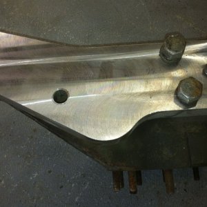

Picture of my new Rock Racer truck that Patrick of Those Guys Customs is crafting for me.

Like the bottom of the frame allowing the axle to travel up farther?
yes, buts its hard to tell from the pics without the links motor etc.
Because from the pics shown I have no idea where the axle tubes are going to sit at ride height compared to the belly pan lower frame rails/tubes. But if the rigs going to sit low with relatively flat lower links I'd think you'll need more.
Whats your planned ride height and up/down travel?
In that pic there is 9" between top of axle tube and frame, travel will be 6-7" up, 8-7" down. Full compression the axle will be at 3-2" from the front tube.
