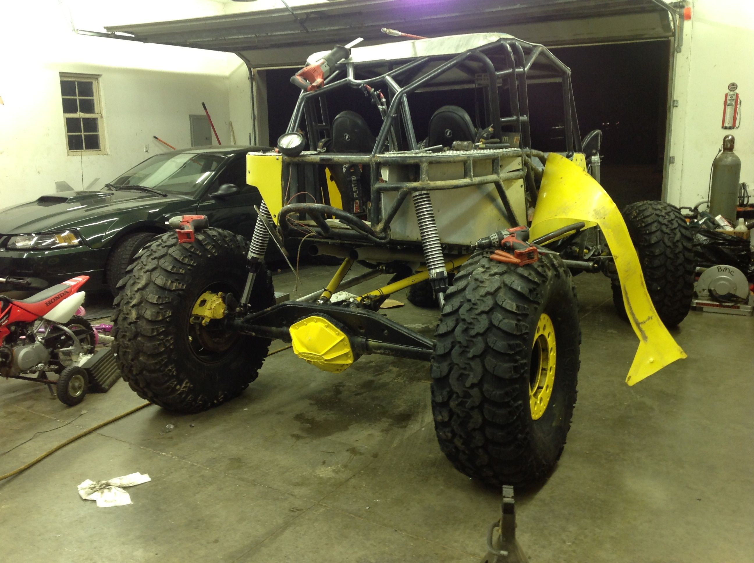

Went to pull the buggy in the garage today to get it ready and it was out of gas due to a cracked weld seam on the bottom of the alum. tank >:(. pulled it out tonight and welded it up. Will be putting it back in tomorrow. Seems like its always something.

What are your skins made out of that they can bend like that?

I had the same thing happen to my fuel cell a while back. Tig'd it back up and all was fine for a while and then is started sweating fuel from the same area again. Pretty sure my problem was related to stress on the tank from the way I had it mounted but anyway, I repaired it a second time with that fuel tank putty and haven't had a problem since. Pick some up and throw it in your trail bag, it's handy stuff to have and makes for a quick fix. I believe the stuff I used was "Permatex 12020 Instant Gas Tank Repair, 1 oz. stick"

I'll be sure to pick some up today. Thanks for the info.

We rode with a guy and he had a hair line crack on his alum fuel cell that was leaking fuel. rub it up and down the crack and it sealed it right up. He rode two days with no more leaks.

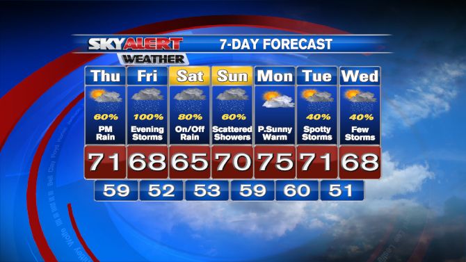

Heres the latest forcast for Eastern Kentucky.....= CRAPFEST....

100% evening storms for Friday, which would be when we'd get there....and rain off and on all day Saturday. Fawking mother nature. :indianajones:
