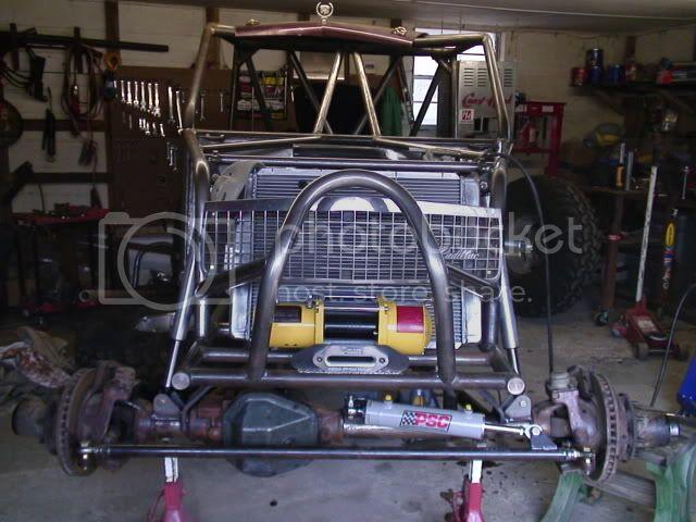

OX-UM ... Not alot visually to show but man I got a ton of little piddle stuff knocked out that needed done. I am close to actually focusing on plumbing stuff ( brought my fuel cell in to run by Gdale perf. for some fittings... )
Relocated and mounted the lowers cuz that was gayness and killing me.
Figured out the front driveline and guess what ........ NO 2PC needed!! ( for now Im gonna try it and see if I can keep it under the rig...long story )
Got both front and rear drivelines measured, ready to go out, ( using existing stuff I already have shorten rear, lengthen front and sleeve ) should get them back next week if I can get my dad to hook - it - up through his work.
added 4 structural bars to the front of the chassis ( for flex / engine bracing ) and also put tube in for the forward hood mounts ( hood 100% mounted now )
Built a tierod, mounted ram , and all that business. Just need to plumb sturrin and its done. Wasn't able to use the big nasty so the tierod is only 1.5 x .250 wall DOM until I can afford sturrin arms and flip it up higher. Gonna suck having the tierod down low but I have no choice at the moment. ( does me no good to spend money on **** that wont make the rig go right now, My budget is enough to finish it and get entry fee's and gas... so Im down to doin some things dirty and re-do upgrading later. )

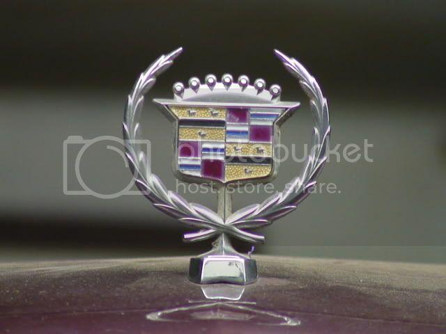

Got the roof plasm'd to fit the "brow" on the windshield. Brought it in to work today to clean the edge up real nice so I can final mount it as well.
Playin with the Sharpie LOL
The more I'm seeing it the more I'm liking that "broke penis" stinger........remember how you did that so you can duplicate it on my replica buggy!

I like the front stinger a lot also, looks angry. Love the PSC bling man, you will be mucho happy with that setup! :drinkers:
this is DEFINITELY NOT me telling you you don't know how to build a buggy or any hate or **** talking. sometimes I get ahead too. I'm just asking
are you going to put a bar in this angle in to keep the front from folding up? it transfers the force that the air bump and shock (via the vert bar the yellow one dies out near) are pushing up to to the A pillar.
if it is in the works, disregard.
