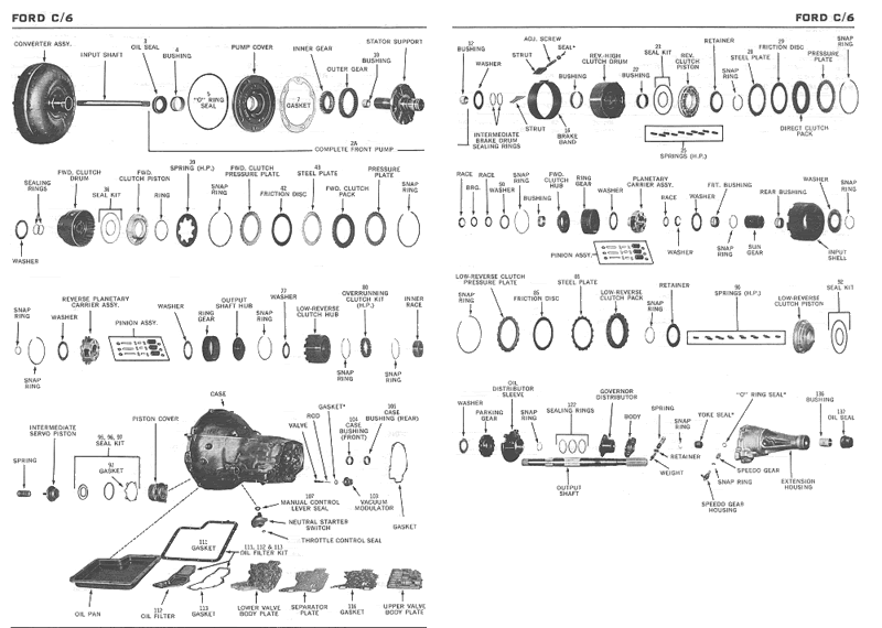

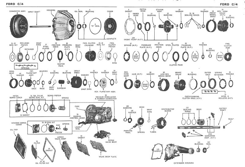

Refresh my memory on the difference between C4 and C6. I think I know C6 is longer...

Anyway, ford C4/C5 is 25 (Ranger) or 28 (EB) spline output, and C6 4x4s are 31 spline output.
