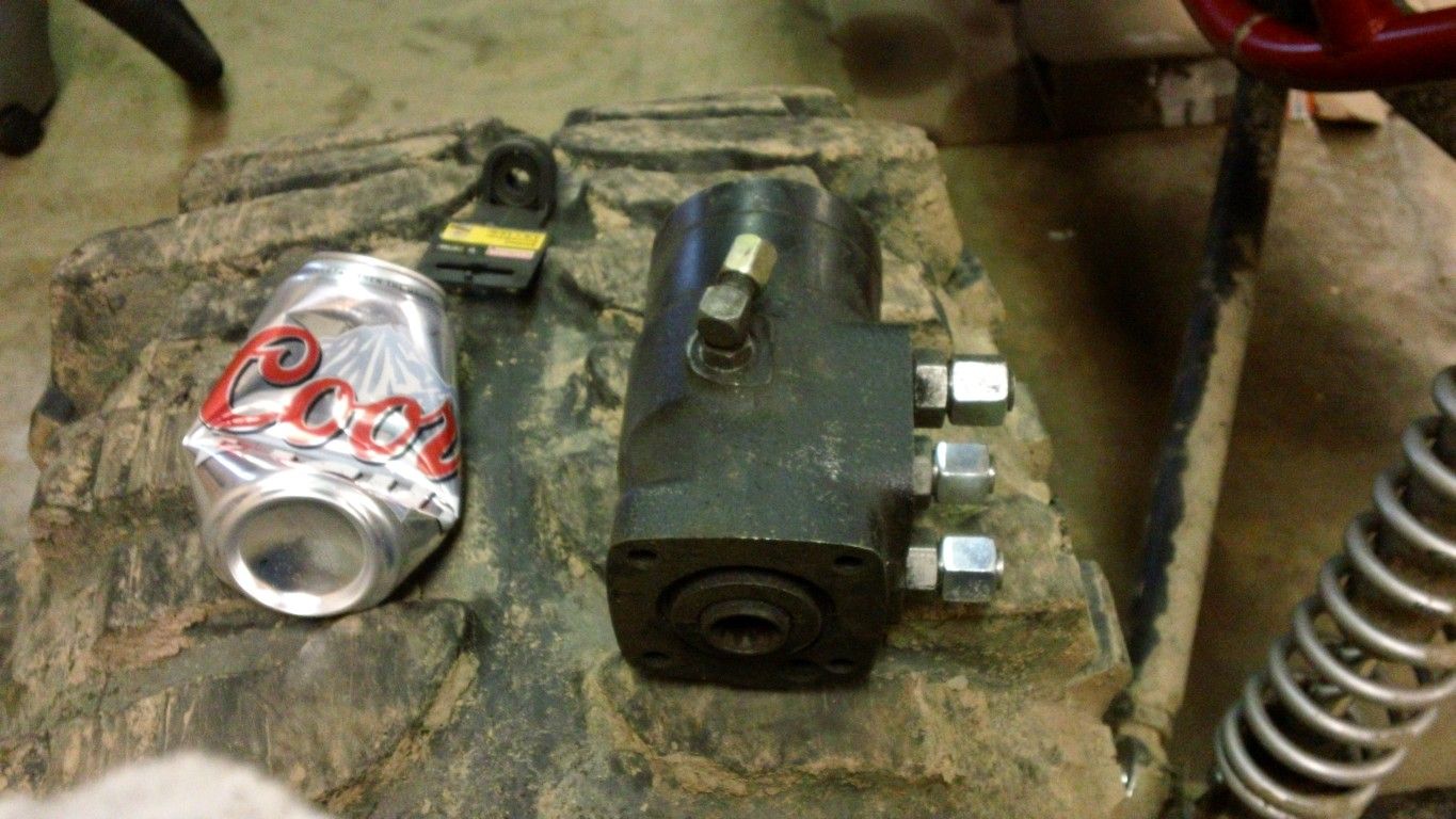

I have a orbital off of a forklift. I checked the numbers to see if it was closed or open. Book says it is a load sensing orbital. It has 5 ports and has a priority valve that it hooks up to. Will this orbital work on a crawler?
THat sounds like the closed center unit. It will have to be drilled out like the link above outlines in order for it to work without destroying the steering pump.
sounds like the 1 ive got, 5th port on the side of orbital?

that looks like it. It is designed to use with the priority valve. when the steering is not being used the valve sends available fluid to the lift controller on the fork lift. I guess I could run the lift controller port back to the reservoir. it's a high pressure line so it may blow the top off of it. It was free so I will try and drill it out, nothing to loose.

Ok guys, I'm starting on the work to make this closed center an open center...
Here is the orbital/metering unit/ steering valve taken apart..
