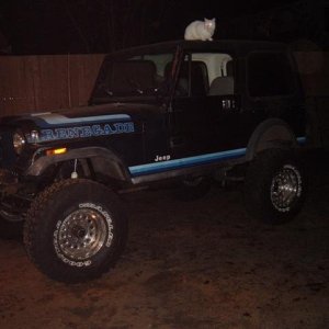

Your tires are all up in your fenders.... not much place for the tires to go when its flexed out.

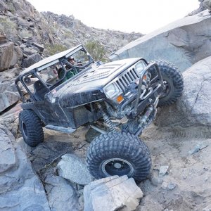

Longer shackles are the easiest fix but If your shackles are not maxing out in either direction, longer shackles when only help very little.
I had spring over on stock springs. Mine flex way better than all my buddies who had 2.5 and 4 inch lift springs.
Are the axles locked or welded? If both axles are locked I wouldn't worry about it. It's neat to see your rig all flexed out. When your out trail riding with front and rear locked flex isn't that big of an issue.
