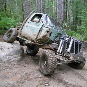

Speaking of Tellico pics. This was my s10 on all leaves on guardrail at Tellico. It flexed like crazy. Good ole worn out spring.

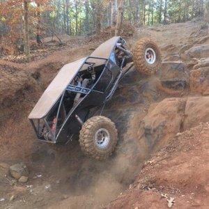

Mad flex
