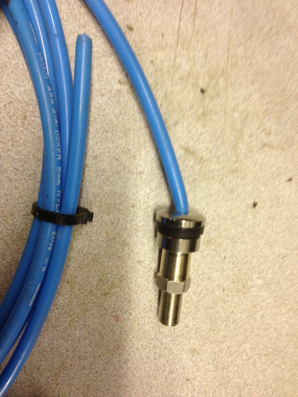

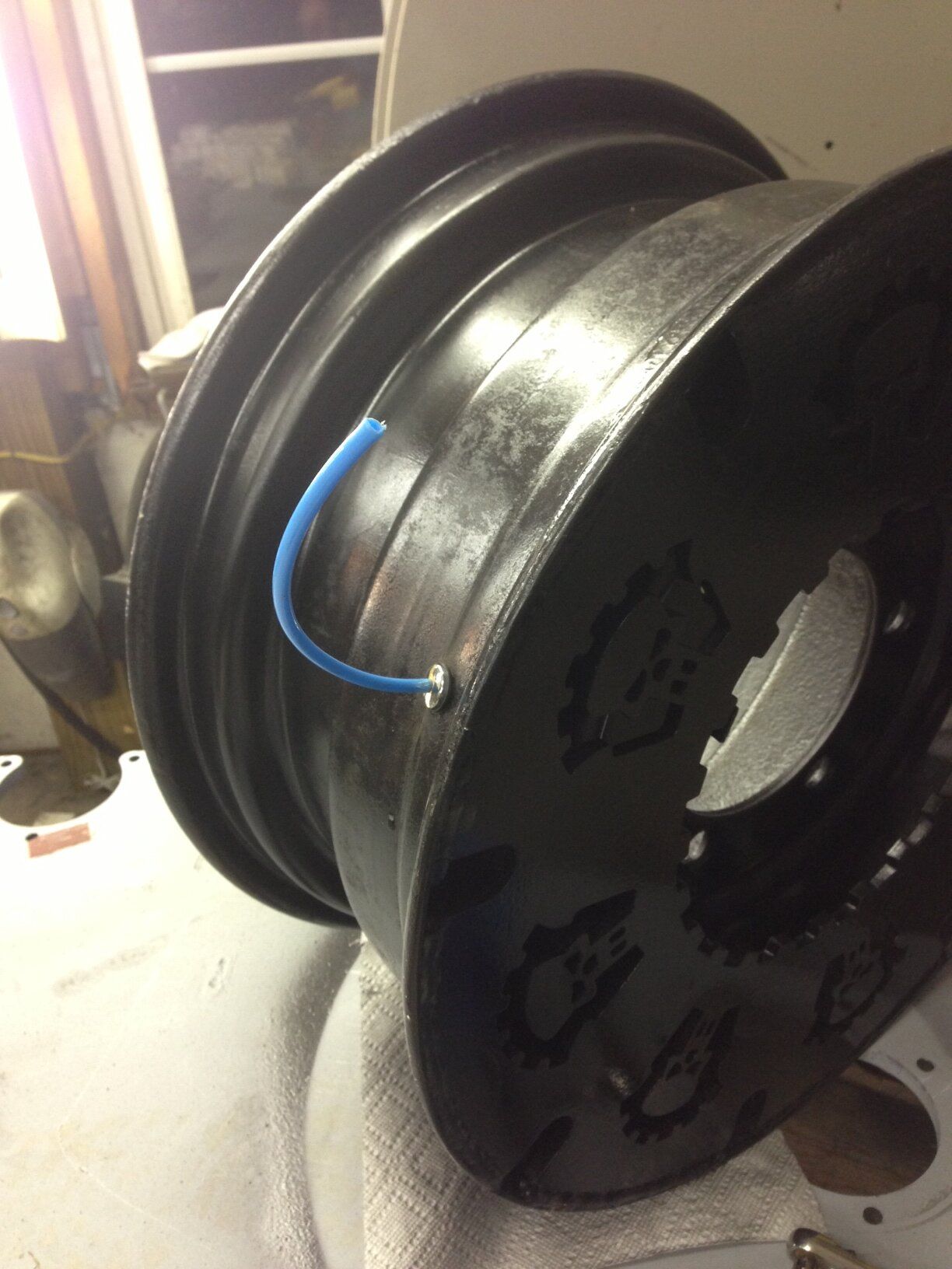

InnerAirLock is the brand I have run for years, I have run 3 sets both on 15" and now on a 20s. They can can be difficult at times but I could not run the tire/rim combo i do with out them. My rims are stock Unimogs 20" rims with rock rings and like the 16.5 they have no bead lip. I run 49 Iroks. as a testiment I have wrecked 3 side walls on my tires and no locks, severely bent rims, and only blown a couple tubes. thats whats nice over the stuans if you blow a staun you have wrecked the lock, the innerairlocks tubes are what will blow.....I can live with $20 tube. As for airing up the tires I have tried a few trick and figured out a good way the othe day. I tapped my metal valve stem and turned in some ARB air line....see pics. i know they are not for everyone but they can serve a purpose.........by the way i usually run my tires at 4psi on a 5700lb rig....and it gets beat
