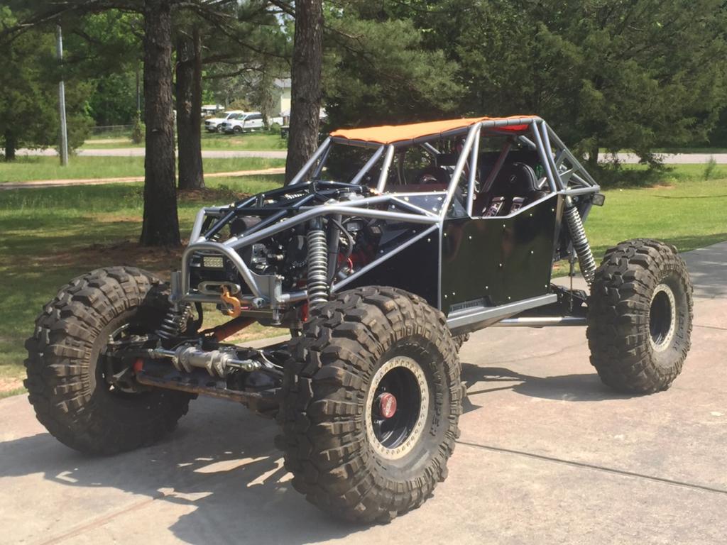

Iron Duck Fab #8 my buggy build
I did a TMR 15 shave kit. I took the precautions recommended other than strapping the diff opening with plate while I final welded to prevent warping. So my cover bolts fit a little tight.
I have had no issues leaking. I have about 5 years on it. It's makes that lower section below the ring gear 1/4" mild steel rather than the same thickness as brittle cast.
Personally it made a HUGE difference for me along with high clearance lower links in the rear. I would do it again for sure, just better. Lol
Awesome build man! Cool to go to your first pic post with just a belly laid down on that build table! Super cool. Great job

Man that is a sick buggy. I love the look of it.
Also pretty envious of the crawler hauler. I've been scouring craigslist for an old gooseneck camper to gut and use the frame to build one.

Obviously not my speed but I really like your rig. Very well done with a bunch of really nice parts tucked into a clean chassis.
Thanks!
It was a lot of fun putting it all together at the end. Missed that skid steer I sold a couple years ago. Lifting the trans and tc through the window by myself without scratching anything was pretty exciting.
