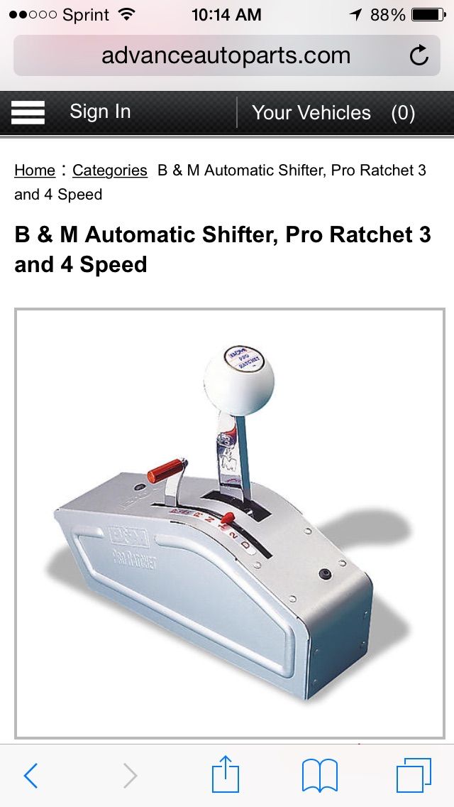

I found one of these still in box for a good Deal on CL.. Any opinions? I can read all day about shifters and still don't understand really, so many different ones, yet I have no idea the difference really. I hate my shifter, not to mention is old and abused. Would this be better for me? or not so much?

I think you'll still have to flip the lever before it'll go from neutral to reverse and then agin from reverse to park. Looked again. I know u will. It's in several of our drag cars at work.
No, not for out sport. No ratchets, you will hate life.
