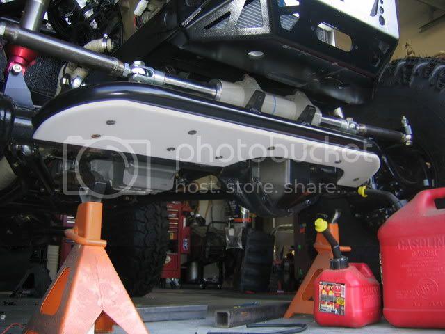

front axle skid that i made to guard teh mount and ram for teh hydro ram....(scored a free 9"x54" cutting board from work that we never used....and proceeded to cut it to fit....)
Lou, what did you use to cut the cutting board material? We have to do that this weekend for a ram mount on mine and the lines will be similar to yours just smaller. Curious what you used
I use a sawzall, but most dont like the sawzall enough to be able to do straight lines. In that case use a jigsaw.
i used my badass bosch jigg saw....with a fine tooth metal blade (all i had) and it cut like butter.....
