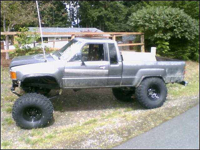

they arnt stock in the rear. And the angle is past 45deg, way past. The only reason it looks level is because its facing downhill in my driveway. I dont think it looks that bad right now, i just dont want my rear tires tearing out my fenders..:looser:

...good to see people recognizing most of the people here are building there rigs by scraping every penny out of the piggy bank. I think for never doing anything like this to any rig before im doing ok.. Rear end didnt end up as high as I need it though. But I have some billet custom blocks from mega machine that will boost it up a little if need be.

build looks good I would hold off on the blocks the front will settle 1-2" after a few good trips.
Who's kit is that? And if your shackle angle is that far back on new springs its going to get worse i would move the rear hanger back about an inch
Exactly what im going to do. My rear hanger needs to go back a bit. will help with the height too. but is an inch back going to be sufficiant?
moved them back about 3" and now the shackles are almost str8. but the dont buckle under articulation. Ive maxed them out. These springs are pretty soft... work far better than I thought they would. Allthough ive never had a truck that had any "decent" parts on it.
