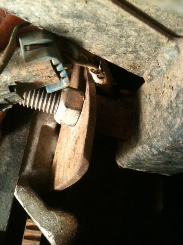

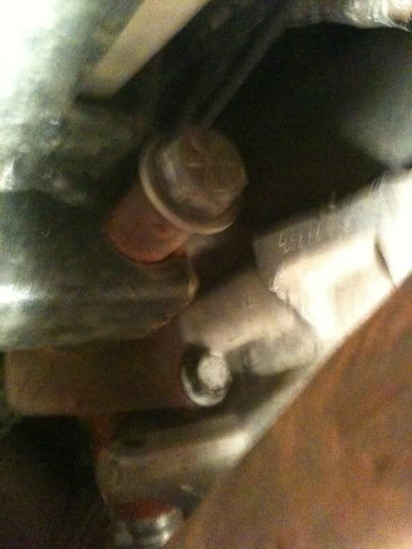

It has this on the left rear of the block, other than this it is just hard mounted like a normal buggy with bushings.
Little hard to piece that picture together..But, that basically looks like it "serves" as 1/2 of a mid plate that ties the left side of the engine to the chassis. Correct?
yeah the pictures suck, its hard to take a picture of.
