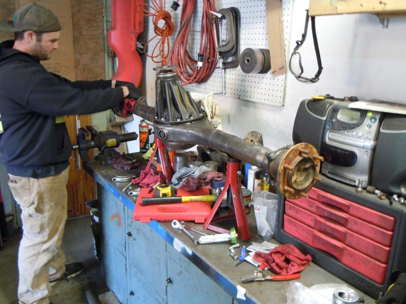

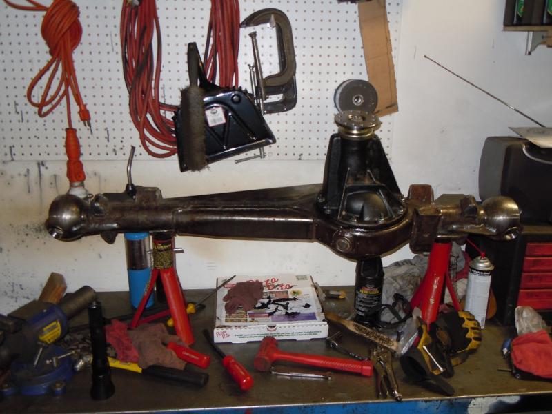

That pinion gear looks too deep to me, suppose to be in the middle of that ring gear. Did it make contact on the carrier, get that depth first then set ring gear. If you take your time and set it up right you warrentee yourself. Shops sometimes do it and throw it back out $$$$.

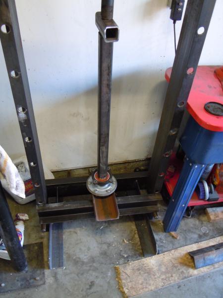

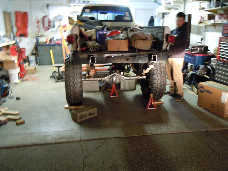

Got the rear axle finished this weekend. The front got started but the long shaft contacts the crosspin about a 1/16" after the large diameter of the shaft goes past the fron edge of the seal. Can it ride like that or do I need to move it and do a martack so it doesn't contact the crosspin?
