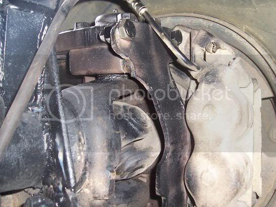

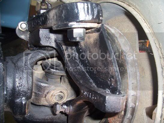

here are mine....
not as much steal on there as what Kelly did on someone elses rig, but I think its alot better than stock...

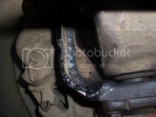

in the last pic you can see where he didn't connect the top plate (where the steering arm bolts go in) to the vertical webbing. I told him to weld a plate along the inside because that's where they separate. I feel that his are WAY stronger than stock, but not what they could be. for what he does I think its fine.

my bad, I wasnt payin attention... I see the lower of that knuckle is cut off not broke off, either way that pic made me think of all the knuckle threads laughing
