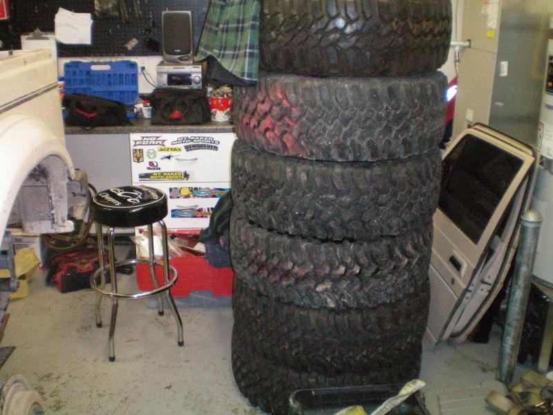

Got some new/used wheels and tires today. Big improvement:cool: 33's on a Sami is huge

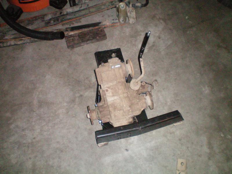

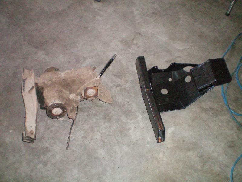

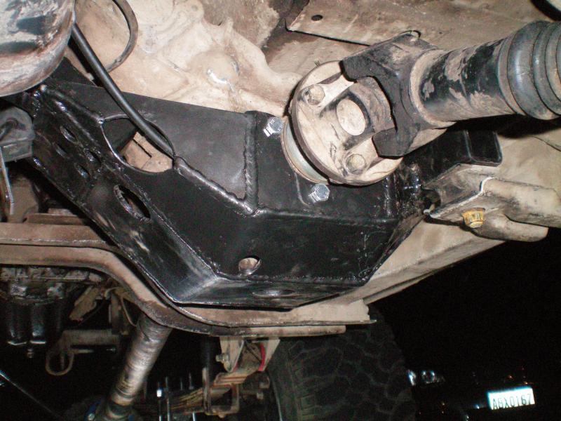

Got motivated tonight and pulled the tcase to install the tcase bucket. Fordzuki did a killer job! I need to go smash it on something:redneck:

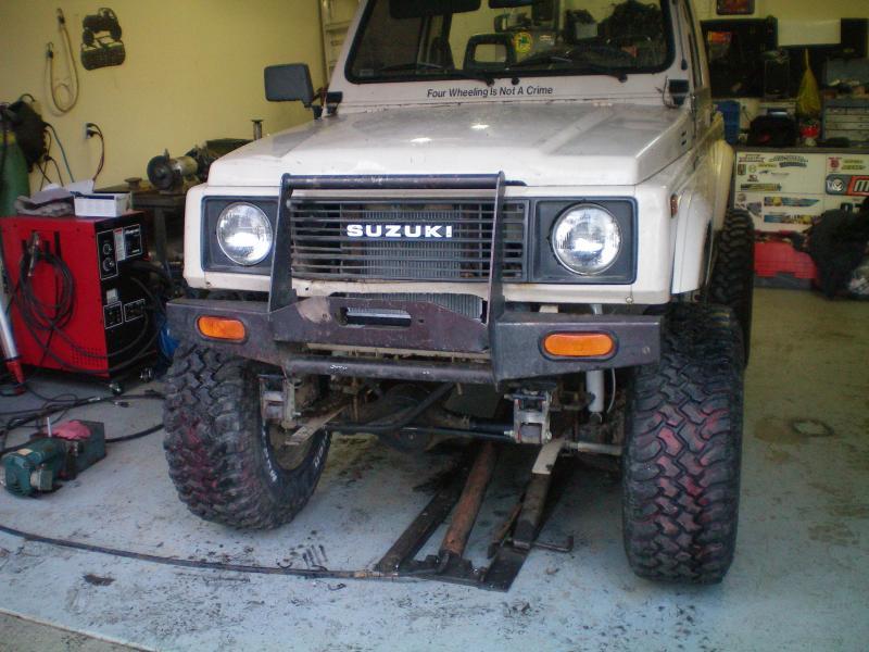

So after wheeling the piss out of it this summer and winter on stock gears and 33's. The stock clutch finally gave in. So its in the garage for some maintence. Pulled the t-case and tranny. Gonna give them a good pressure wash. Also gonena take care of the leaky rear main and oil pan at the same time. Have to split the t-case to install the 6.5 gears. Also got new rubber to replace the racing slicks I was working with:redneck: Have to clean the wheels and give them a good coat of paint. Still need to order my twin stick. Then when its back together its getting a long over due cage:cheer: Then its ready for opening day at Evans:cool:

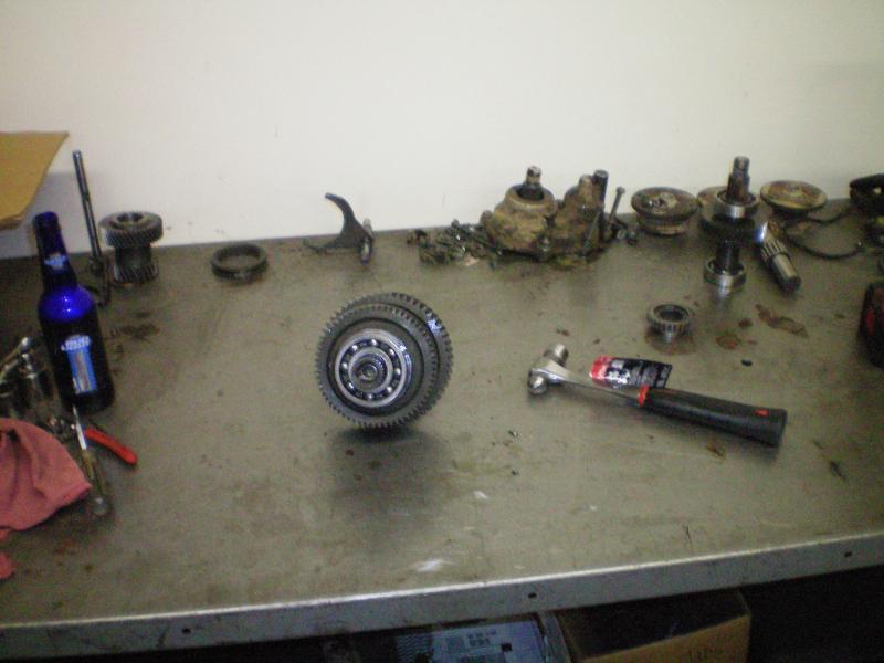

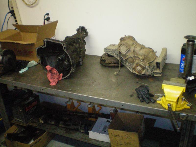

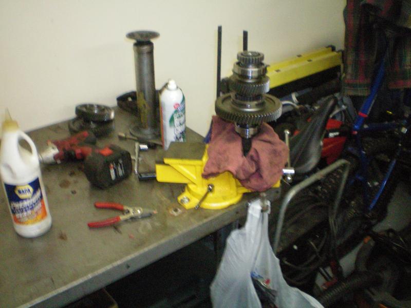

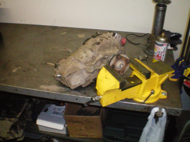

Started on installing the 6.5 tcase gears tonight. Don't have a press at home so was only able to get the output shaft built. Going to take the 2 case halfs and input shaft to work with me. Throw the case in the parts washer and press off the old bearings. Should have it reassembled tomorrow night:cool:
Also got my wheels looking pretty so Ill load those up in the morning with my tires so I can mount those. Then when my clutch shows up I can put everything back together and go wheeling:cheer:

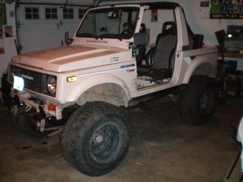

Got my swapmeet purchased installed this afternoon! So worth the $120. Gonna get my clutch installed sometime this week and shes back on the road:cheer: Cage and winch very soon to come:cool:
