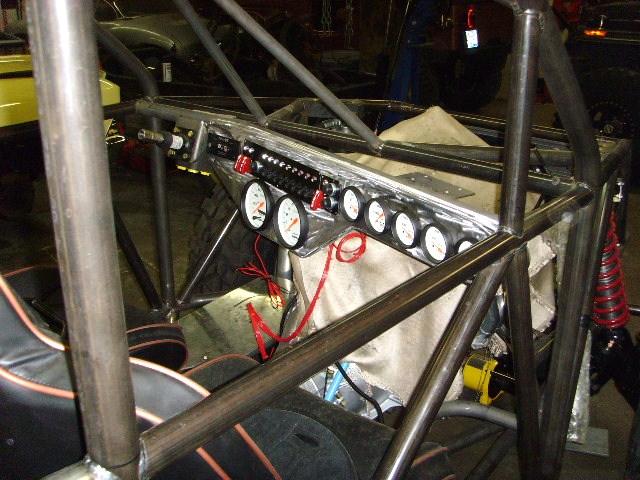

New pics of the sick Vision X lightbar and dash Pat made

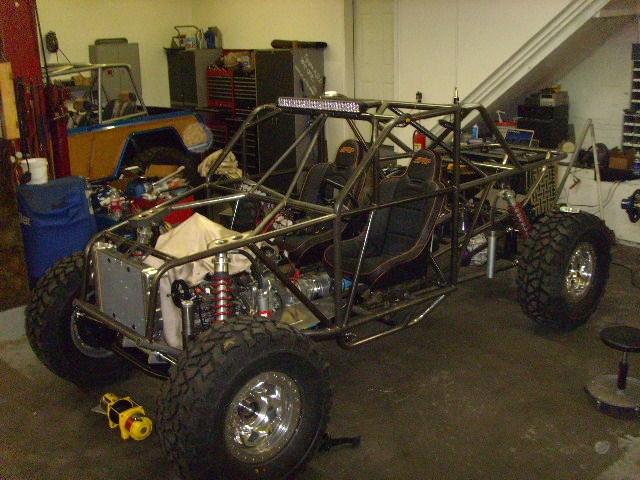

Got the floors, firewall, most of the trans tunnell done, pedal monts done, winch mount done and some of the brakelines all done.
Tore it all down last night and started painting the chassis, ran out of paint, just got more so finish the painting this morning. Start re-assembly this afternoon and start plumbing, finish wiring. Waiting for the torque converter, mass airflow, axle shafts and drivelines.
Pics or it aint true.:redneck:
