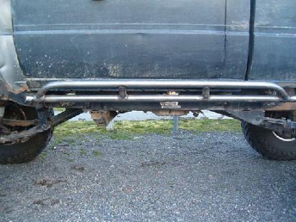

Learning my bender
more pics

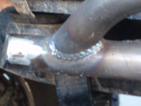

FMR... but thats a perty weld you have there... you might as well sign your name on the fab work you do... *(that'll be cool) w/ powder paint.:D
I am trying to do the best job i can on all of my work now.I did some not so good work acording to someones rig i worked on a few weeks ago and after that i am trying my very best to do good work.This is the second time i have use my bender and notcher so ill get better as the days go on.Thank for the props everyone.:super:
not to dog but... i think, on your welds a common reason for the dots in the middle of your "stacked dimes" is an improper gas mixture causing the welds to cool to slowly and the welds then get infected and bubble up. also your stacked dimes receal you are moving a little quickly. so just make sure you are still penetrating fully.
I agree a lil bit here...turn your gas up and try to blend them a lil tighter....everone will be happier in the long run...and Brian I'm not kicking you in the nuts I'm just trying to help...oh and thank you again for your assitance at Evans that night back in Feb.:clappy:
