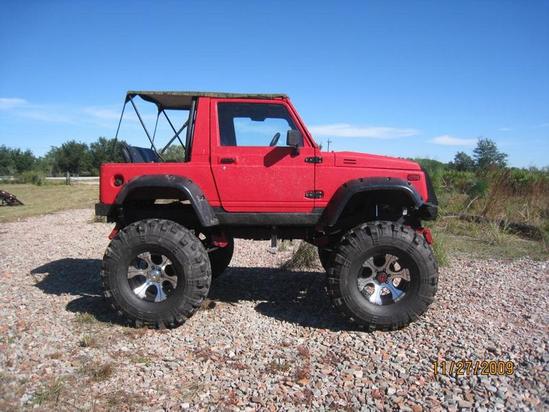

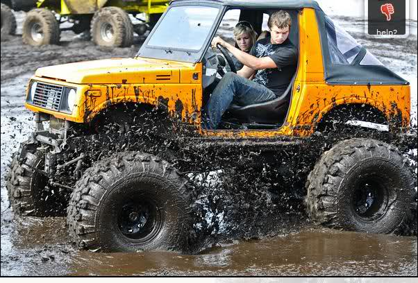

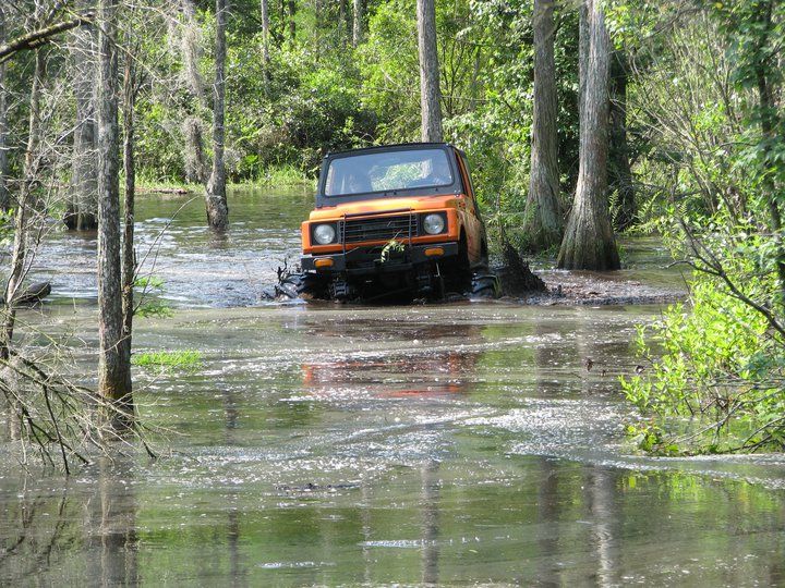

Post a few pics to show what I'm combating with this stupid header. You can see where the Clayton 3rd link sits outside the frame bc there's no room on the inside of it.
My Mud Zuk
