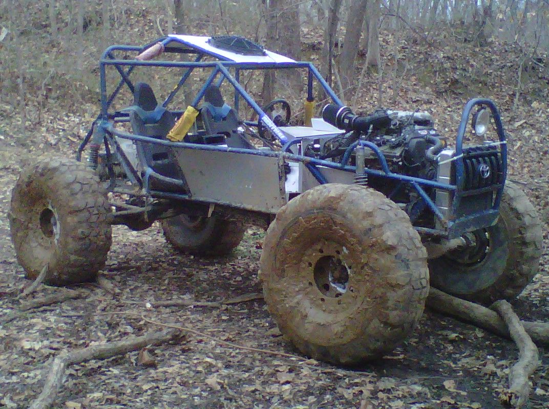

Here is my low budget and home built buggy.
22RE, 5spd Trans, Yota t-case with 4.7 to 1 gears
Toyota front axle, 5.29 gears with lockrite, Longfield axles, Hydraulic steering with Hy-Steer
Toyota rear axle, 5.29 gears with Detroit
Super Swamper Iroc 13.50x39.5x17
MRW steel wheels 17x9 reverse cut, 2" BS
Kirkey Seats
12Volt Guy switch panel
10 Gallon aluminum fuel cell
108" Wheelbase
67" to top of cage
21" Belly clearance
Thats about it!

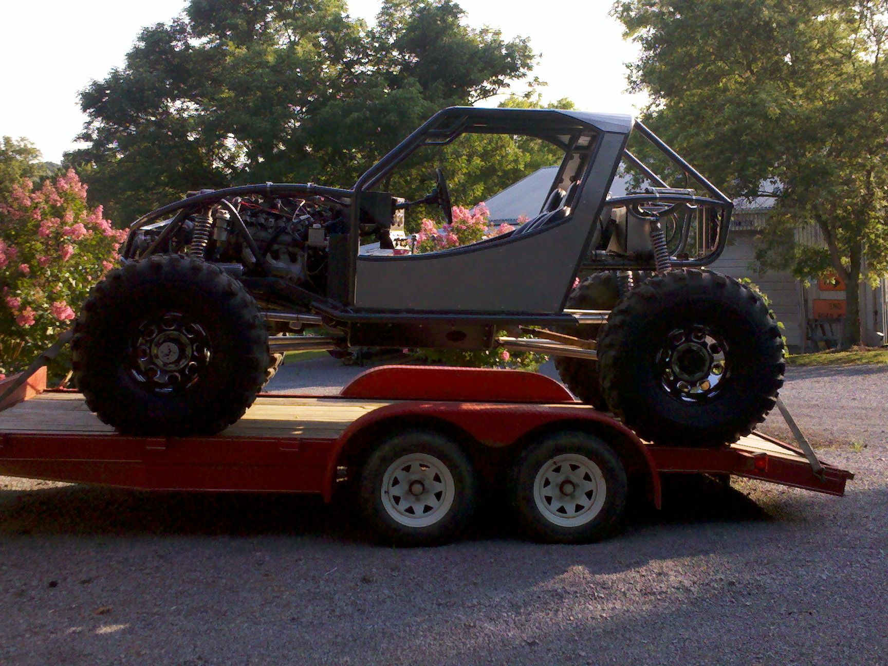

My first post to the website. Chassis was built by a friend of mine some things will be changed though to make it more to my likings.

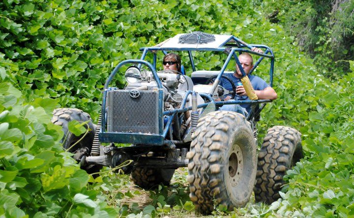

I'm guessing that the electric fan mounted to the roof is for the a/c? If so I think that is a pretty cool idea.
yea thats my ac lol gotta stay cool somehow even though it mulches leaves an sticks down the back of Ur neck :****:
