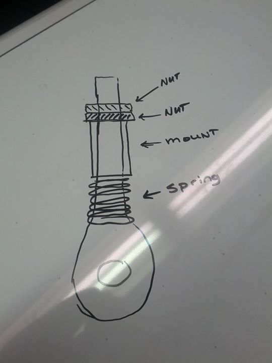

This is what I was trying to explain
David I see the spring in extension, but what other than to take up 1/2" of slack would that serve?
If its mounted on the other side, at full droop the weight would could bind the spring and seeing as how thin it is would eventually crush it leaving the clevis loose.

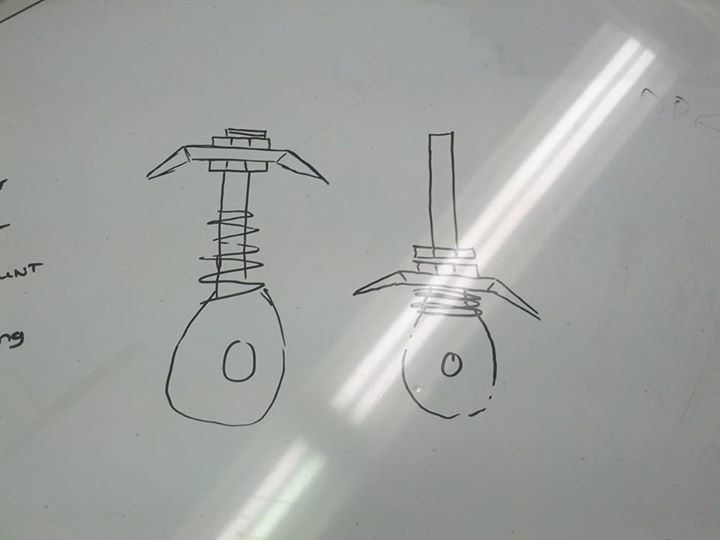

The spring does not hold the weight of the axle. It only keeps the clevis from bouncing around.
This drawing might be the best example of how to use it to it's fullest.
The threads end towards the bottom, because the rod is getting larger. That's why the spring is there.

Re: Limiting strap tech
The spring looks useless in both of those drawings, and I can't believe we've went on this long about a ****ing spring on a clevis! :****:
I get it now. Thanks for the explanation. Sometimes ima wetard.
