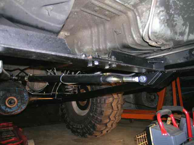

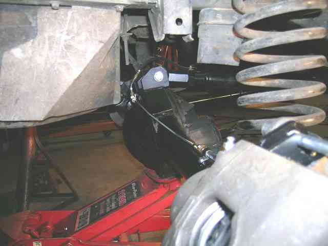

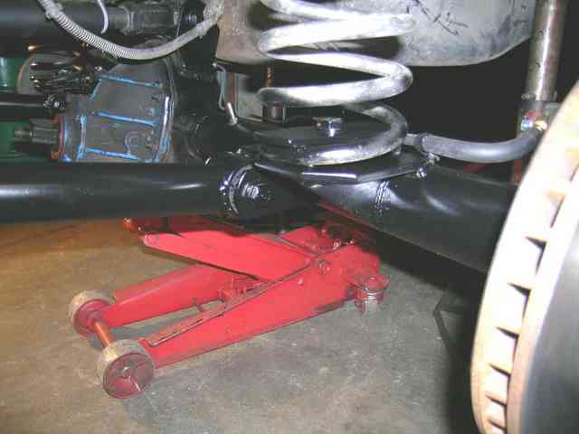

I know tons of ZJ/TJ people running the lVl style 4link in the rear (crash did mine like that), and they seem pretty happy with it. They seem to hold up good, granted they're not comp buggys or anything though.
here's some pics of what mikes done...
