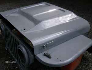

I picked up a fiberglass picklefork hood that's in nice shape, in case we need it. The grill I got isn't so hot but the headlight area is in very good shape.
So whats a pickle fork hood?
Is the new grill bent up any?
I feel better, I wasn't the only one who didn't know.

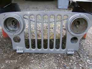

The grill isn't bent but it's got more rust that the one that's there now. The only thing better is that the headlight area wasn't all messed up.

Hmmm---Is it surface rust or rusted away rust? A nice grill will set this thing off nicely :awesomework:

I grabbed the grill to look at it a little better. It could be a lot worse...
