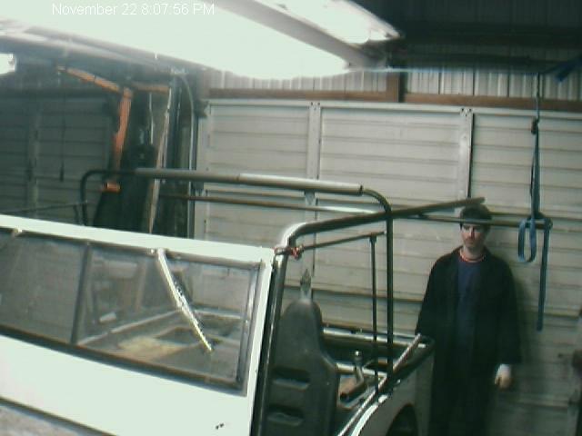

Looks like a Crash build from here :haha: Is it straight Mike:eeek:
Im T H I S tall:haha: :haha:
ha ha--funny jim :fawkdancesmiley:
