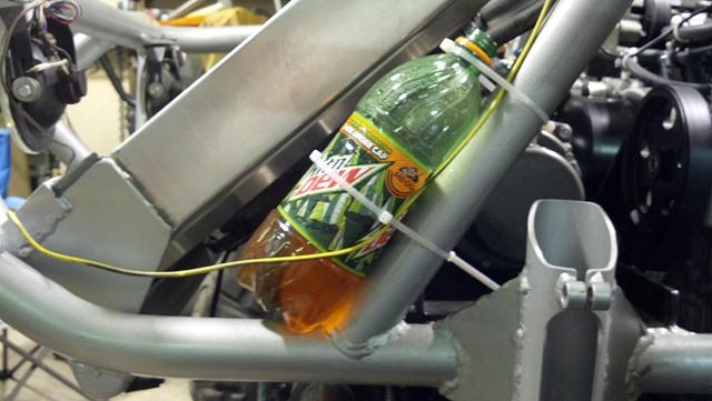

I'm hoping that we can put a REAL reserve tank on it. I've seen that overflow bottle design a couple of times:haha:
I still have the original MD bottle on mine. I haven't wheeled it much lately but that bottle has seen plenty of abuse.:redneck:
