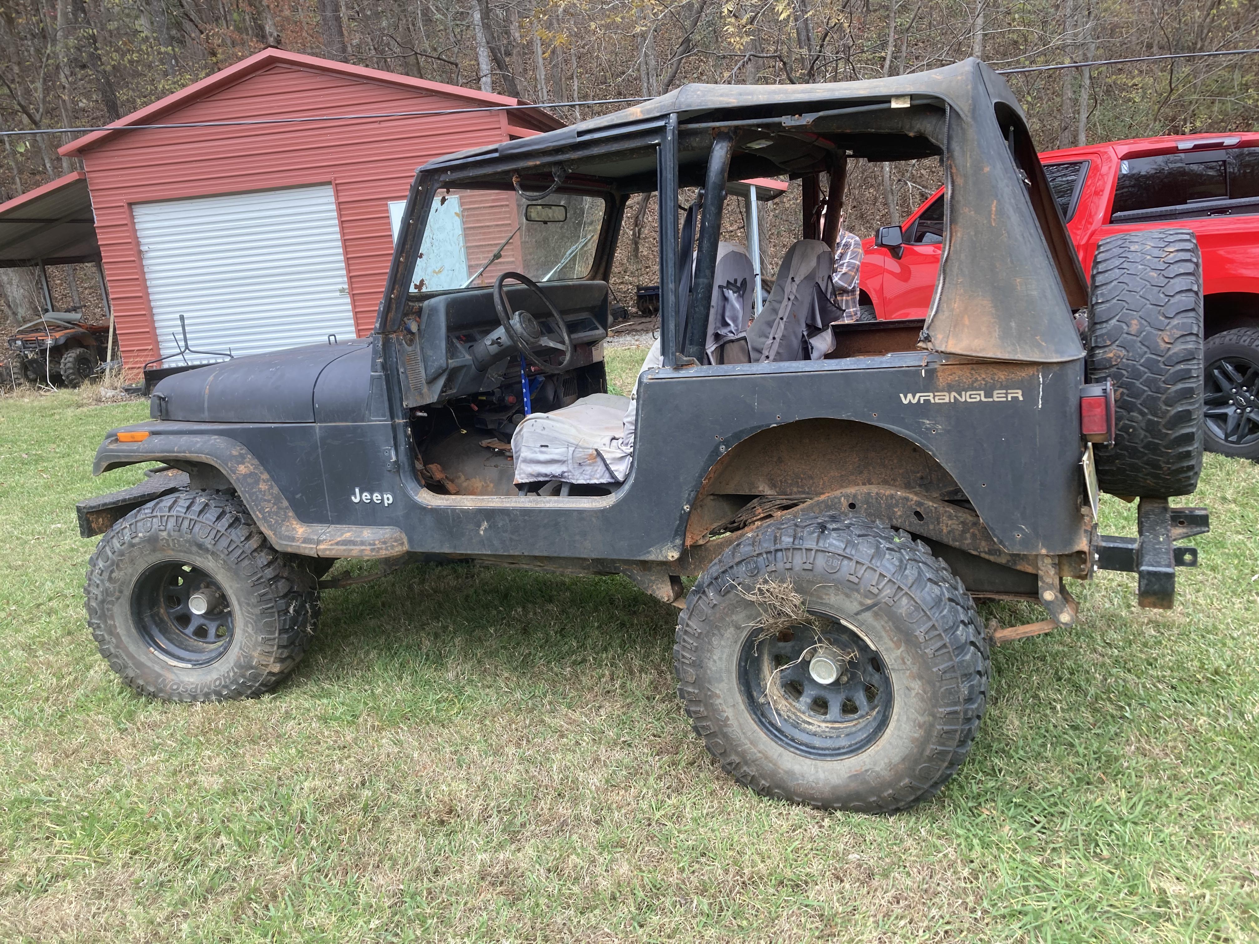

This is the day I bought it. Pretty ugly and was running on 5 cylinders, no heater, no blinkers and no 4x4. Stopped on my way home and fixed an injector clip and it ran perfect. Got the rest working once home for $0. Just needed some TLC.

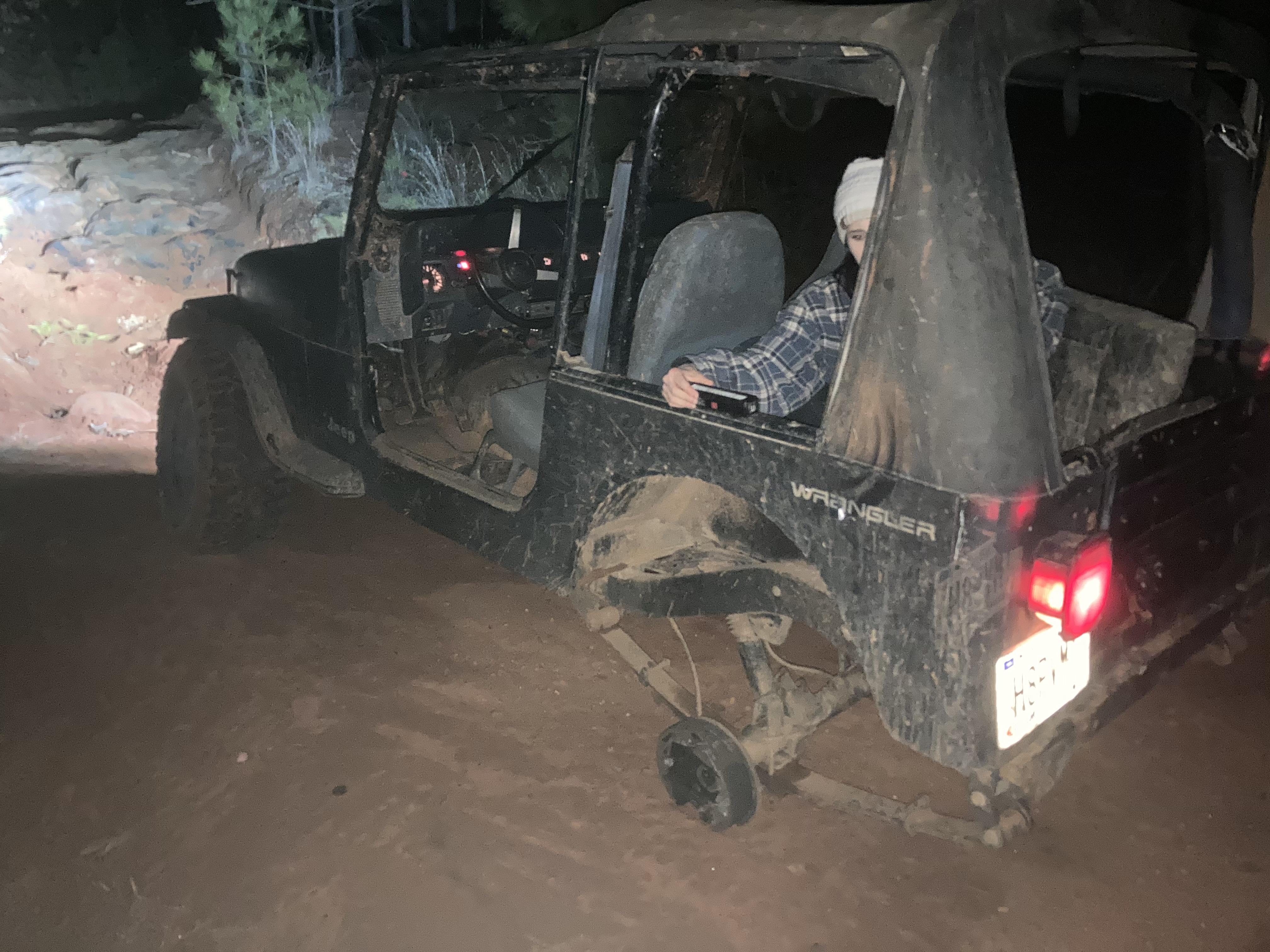

The inevitable breakage of the welded Dana 35 was pretty much instant. Broke a front axle just afterwards trying to get out of the woods. Loaded it up and took it to my garage.

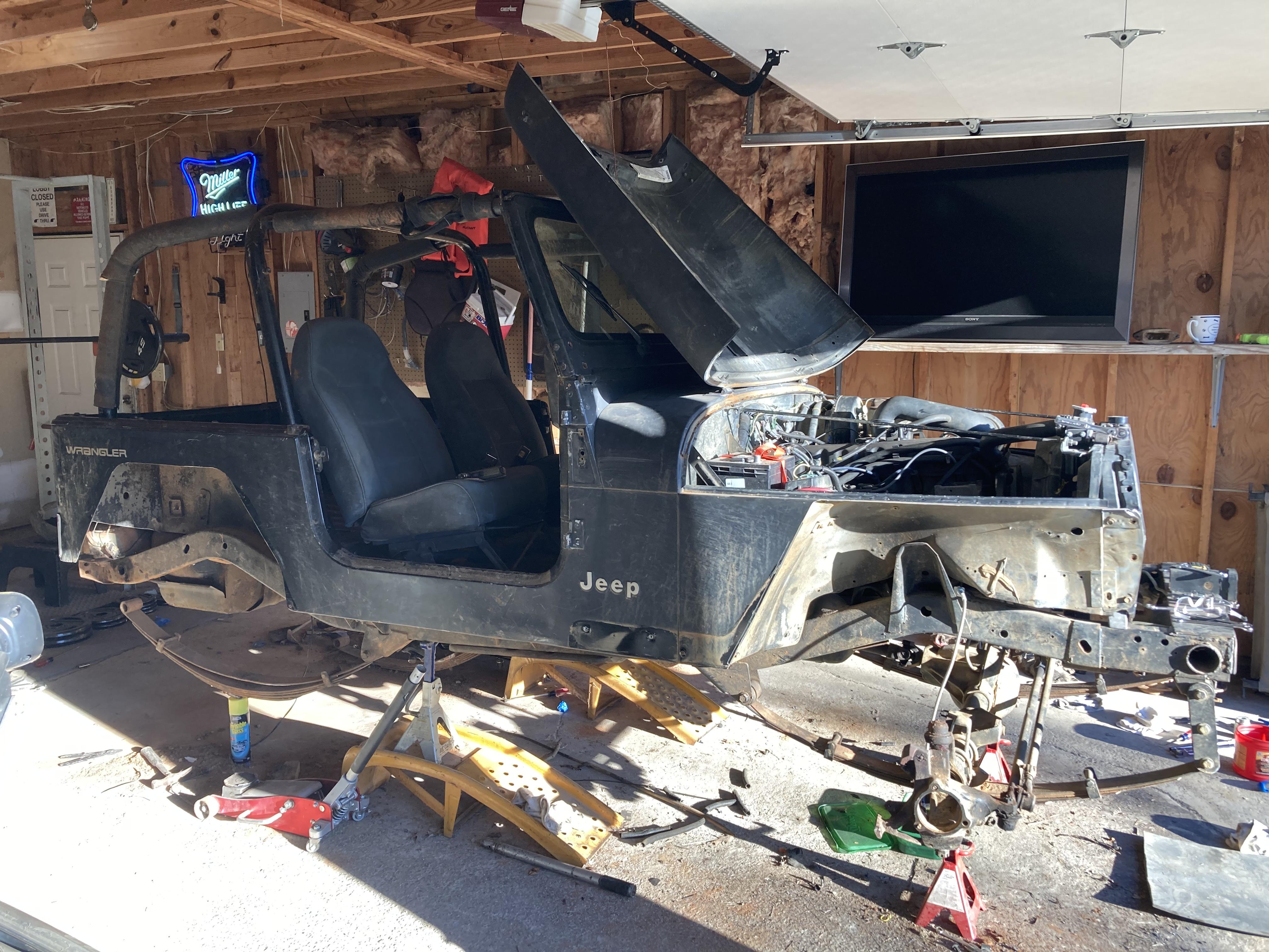

I know the jack stand situation is not optimal lol. I've got the front diff out to install some seals now that I don't have CAD. Hopefully I can start getting the rear axle fitted and ready to weld up. The RuffStuff brackets look real nice.

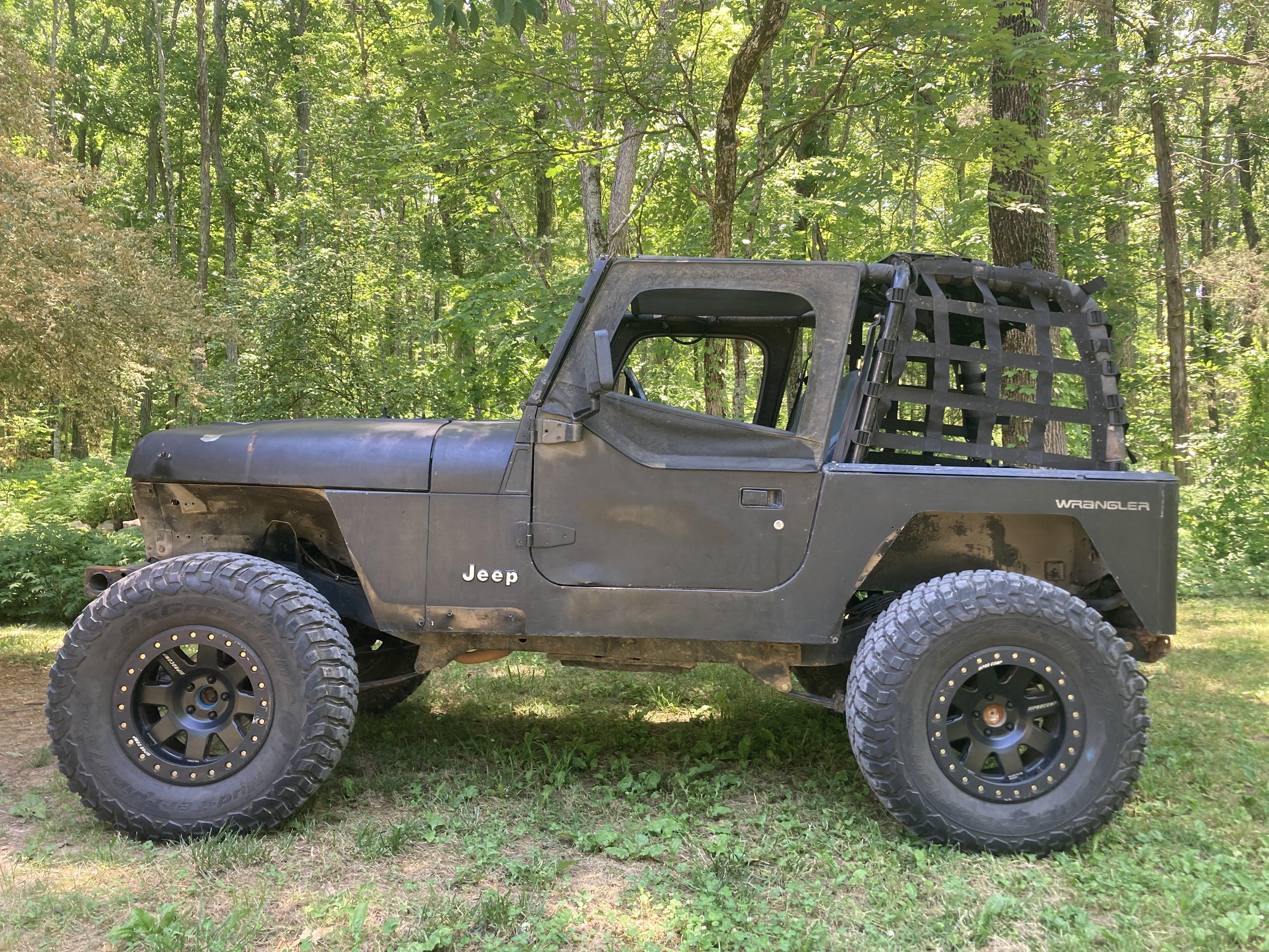

Went to Johnson City yesterday for some wheels and tires. 35" km3's and pro comp beadlocks.
You might have just doubled the money you have in this project... ha

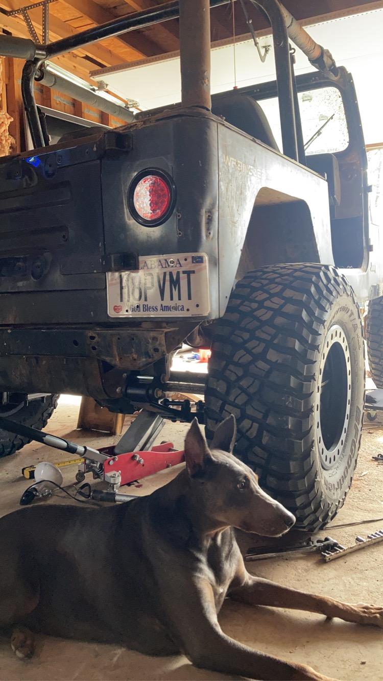

Slowly getting the rear set up and ready to weld. Any tips on pinion angle? I've got it pretty much dead straight with the drive shaft (double cardan) thinking I might need to put a couple degrees down for axle wrap on the throttle.

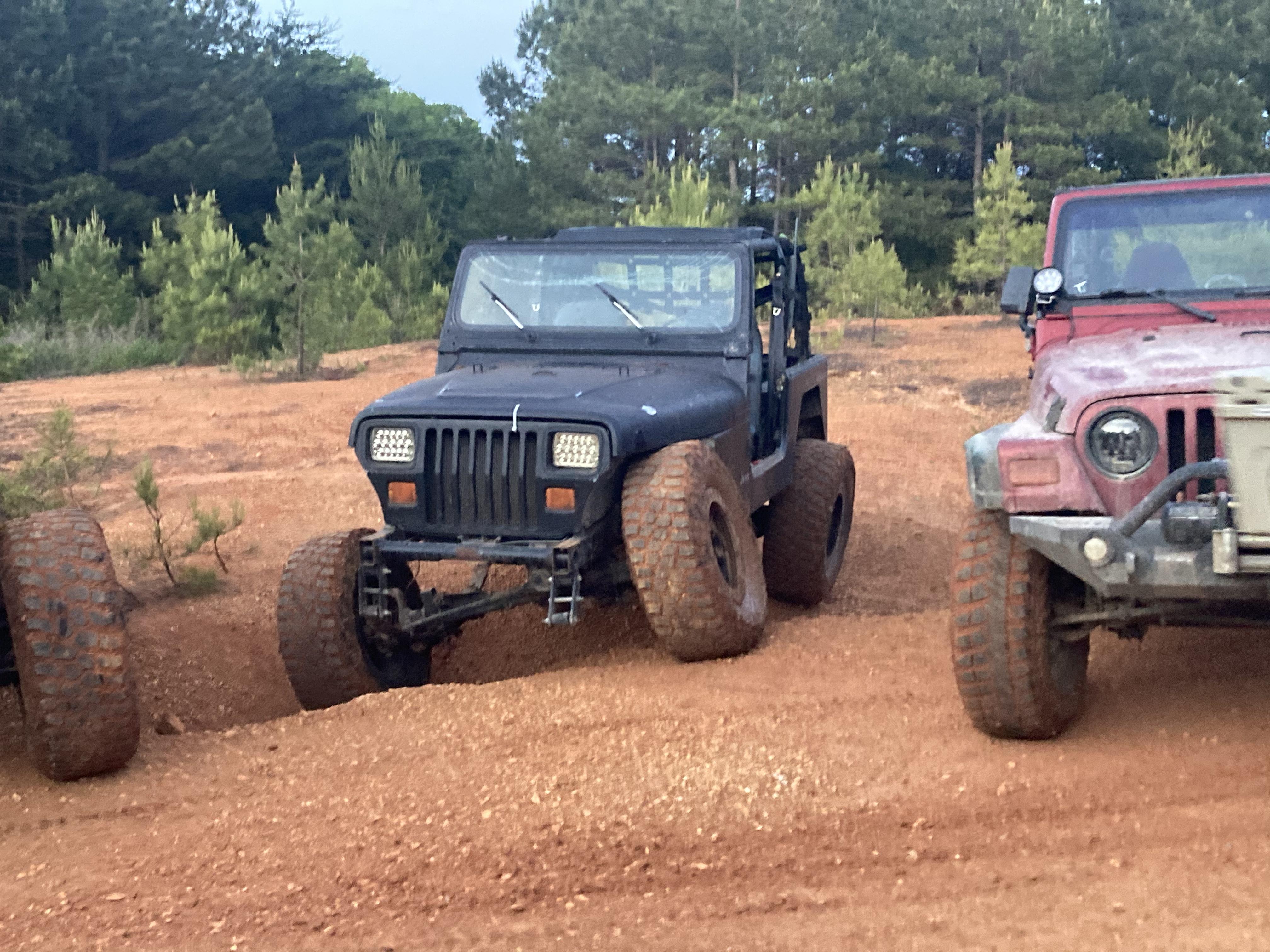

Overdue update. My truck laid down on me and I had to get the Jeep going in a hurry. I've been daily driving it and have done some light off-roading. I'm pretty impressed for what it is.
I was a dumbass and let the hood fly up so now I need a windshield frame and glass. Had some real wild electrical problems that I finally tracked down. Got some upgrades to make once I have my truck fixed. I'll post a few pics of the Heep.
Pics..
