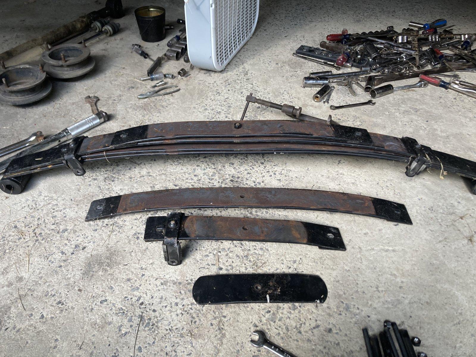

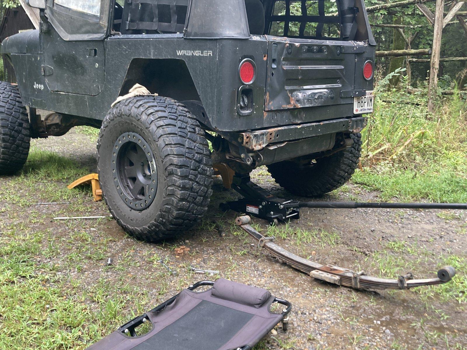

So the wagoneer springs did not ride as well as I had read. I decided to remove two leafs (5 remaining). It rides way better now. I imagine my Jeep is just much lighter than most. No rear seat, no spare tire rack, factory cage, etc. it lowered it about an inch which I'm not mad about. Definitely feels more stable than my last rig that was linked on 40's.

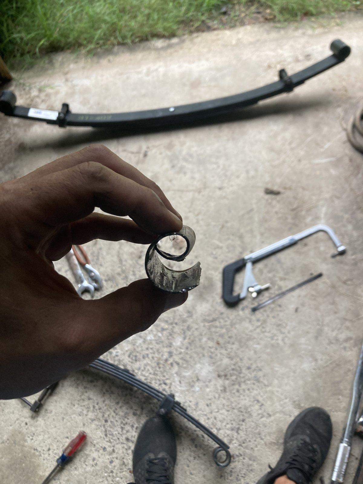

removing the factory rubber bushings was hell. The big end bushings came out on an arbor no problem. The small ends were way tighter. Patience with the hack saw made the last one a breeze though. Learn as you go I guess. Replaced with poly. And swapped the leafs out in my driveway in the rain haha garage has a boat and broken pickup so no room.

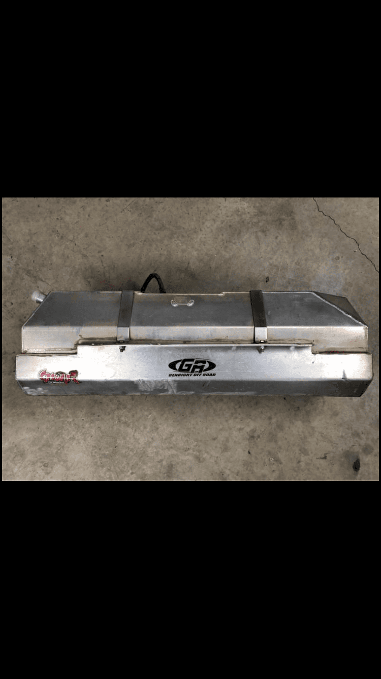

Well I finally bought a Genright tank. Found one for real cheap in Trussville with the aluminum skid option. Gen1 Comp tank like one for sale on this forum. Got home only to realize it does not work with stock shackle location. Big bummer. Posted it for sale and got my money back the next day tho.
turns out my wagoneer springs do not ride bad, but my diff cover and tank are abruptly stopping the suspension when they meet. I'm going to try one of the Motobilt tanks if I don't find something used.

I've seen a few guys use a little heat to gently deform the stock tank enough to clear the diff cover before. Seems like a pretty inexpensive way to do it. Just try not to blow yourself up in the process
Yea I've thought of doing that. Cutting the skid and welding some clearance into it. I paid $500 for the Genright so I figured it was a decent deal compared to my time modifying one and still having to buy an aftermarket skid as mine is the thin factory unit.

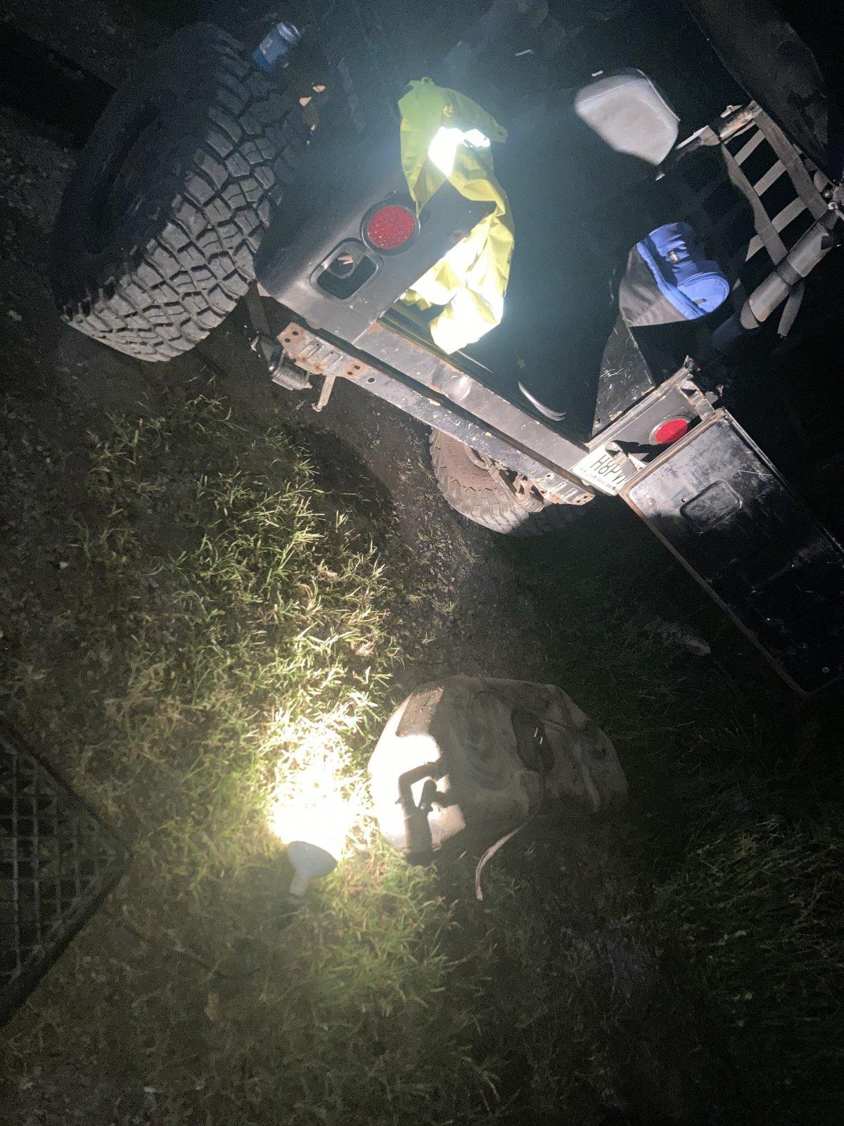

Well I got off work early and decided to move my tank into the back of the cab. The 8.8 diff cover was looking thin. Took about 4 beers/1 hour. Ain't happy about it being back there but I had to do something. I was kind of stressing with this being my ride to work haha. Should buy me some time until I get a proper setup.

I did it in the driveway once again. Ole raggedy dodge and a boat taking up the whole garage.
