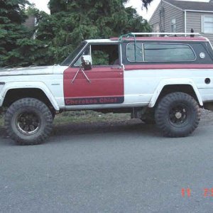

Who's white uni swb is this? Your dad's is red, right?
:cool:
:cool:
That's his too... it's actually the original one he bought back in the early 90's. It's a '61 F-100 and was originally 2wd... he converted it to 4wd with parts from a '6-something 4wd he got for free. 292 Y-block (of course, he's obsessed with y-blocks. :)) and a fresh coat of paint... basically 90% restored.
