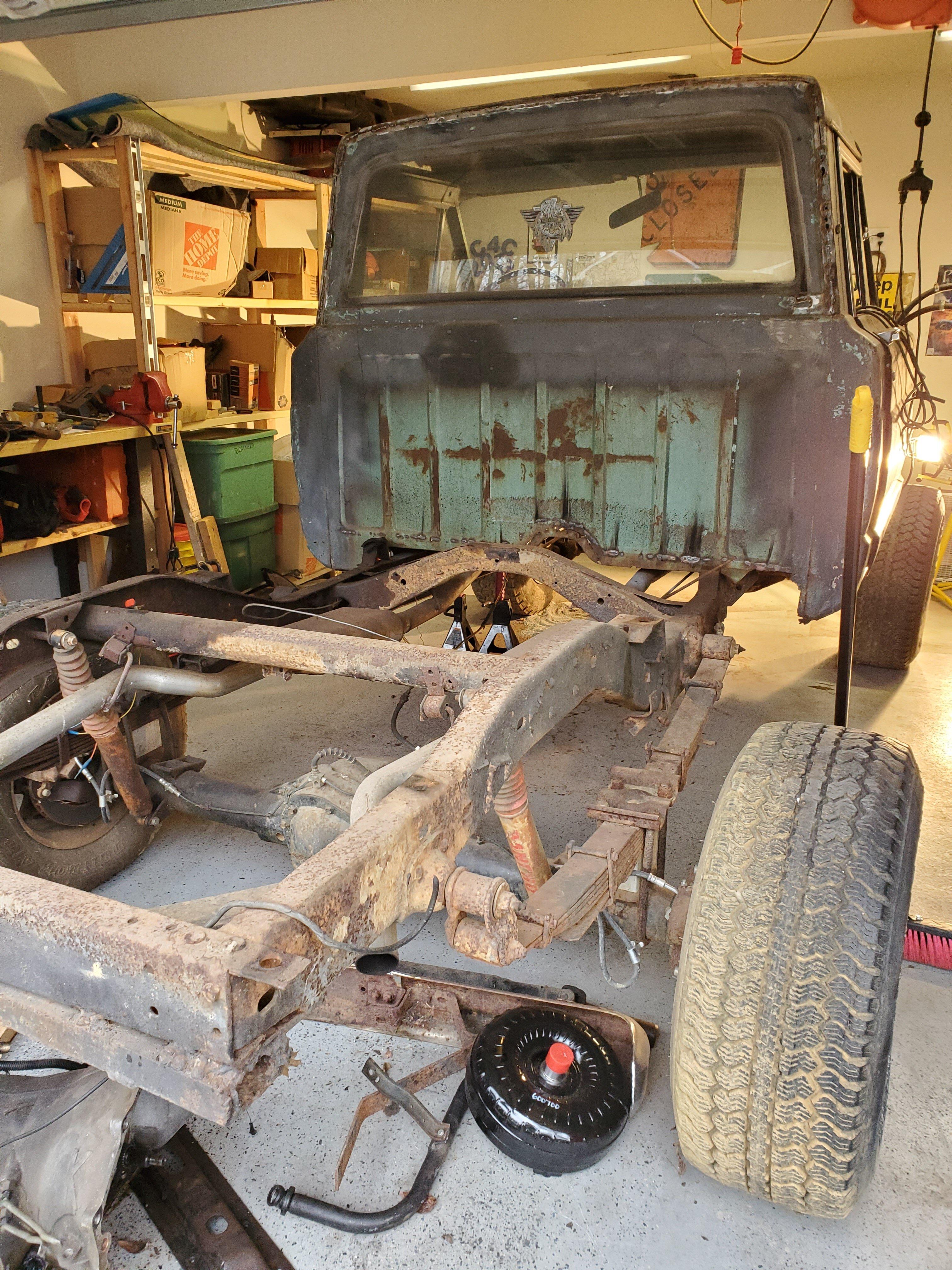

It is always good to make some progress. If a new vehicle had that much stuff on the frame it would have fallen apart already. They sure knew how to make things last back in the day.
Awesome floor boards

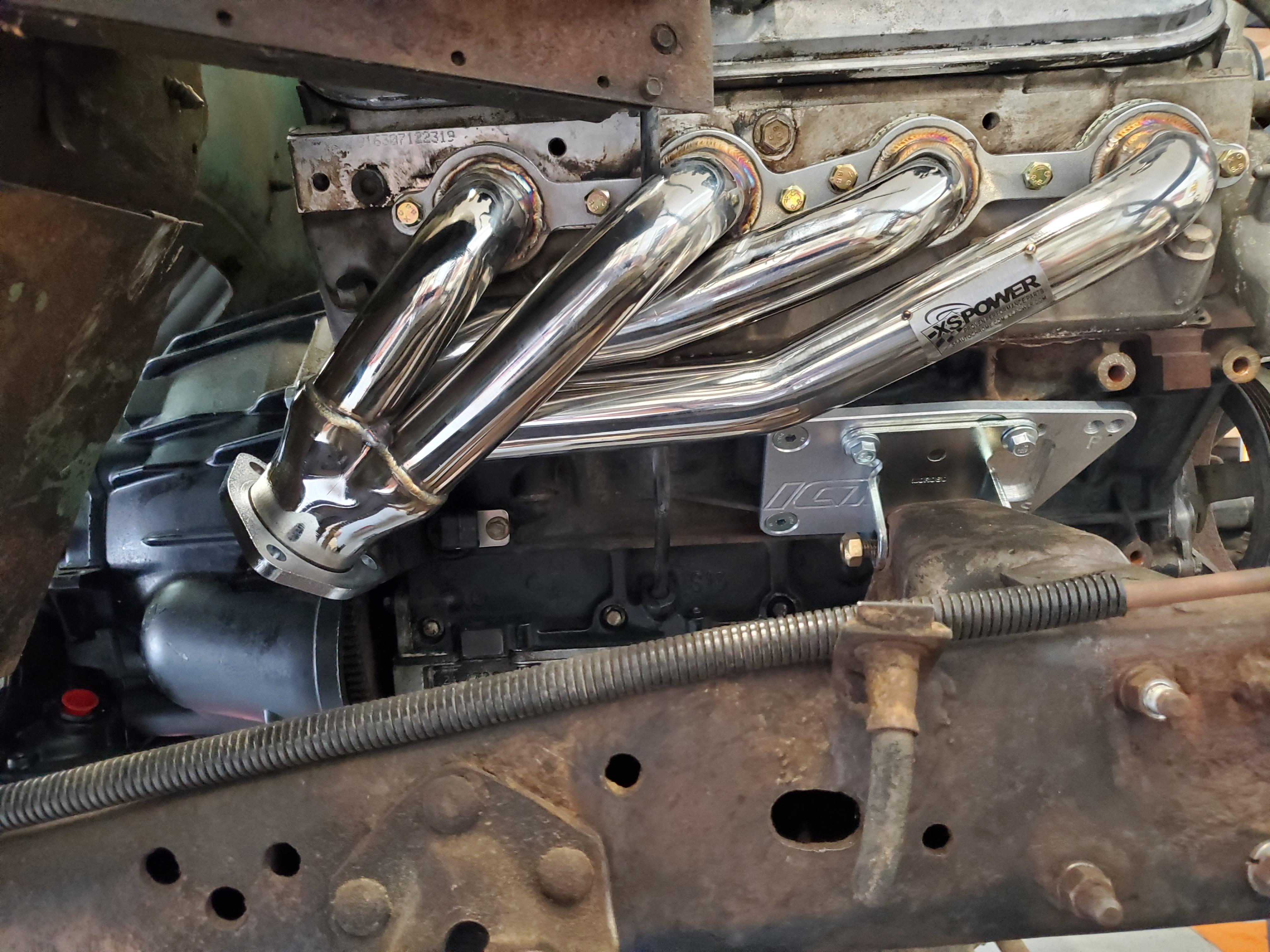

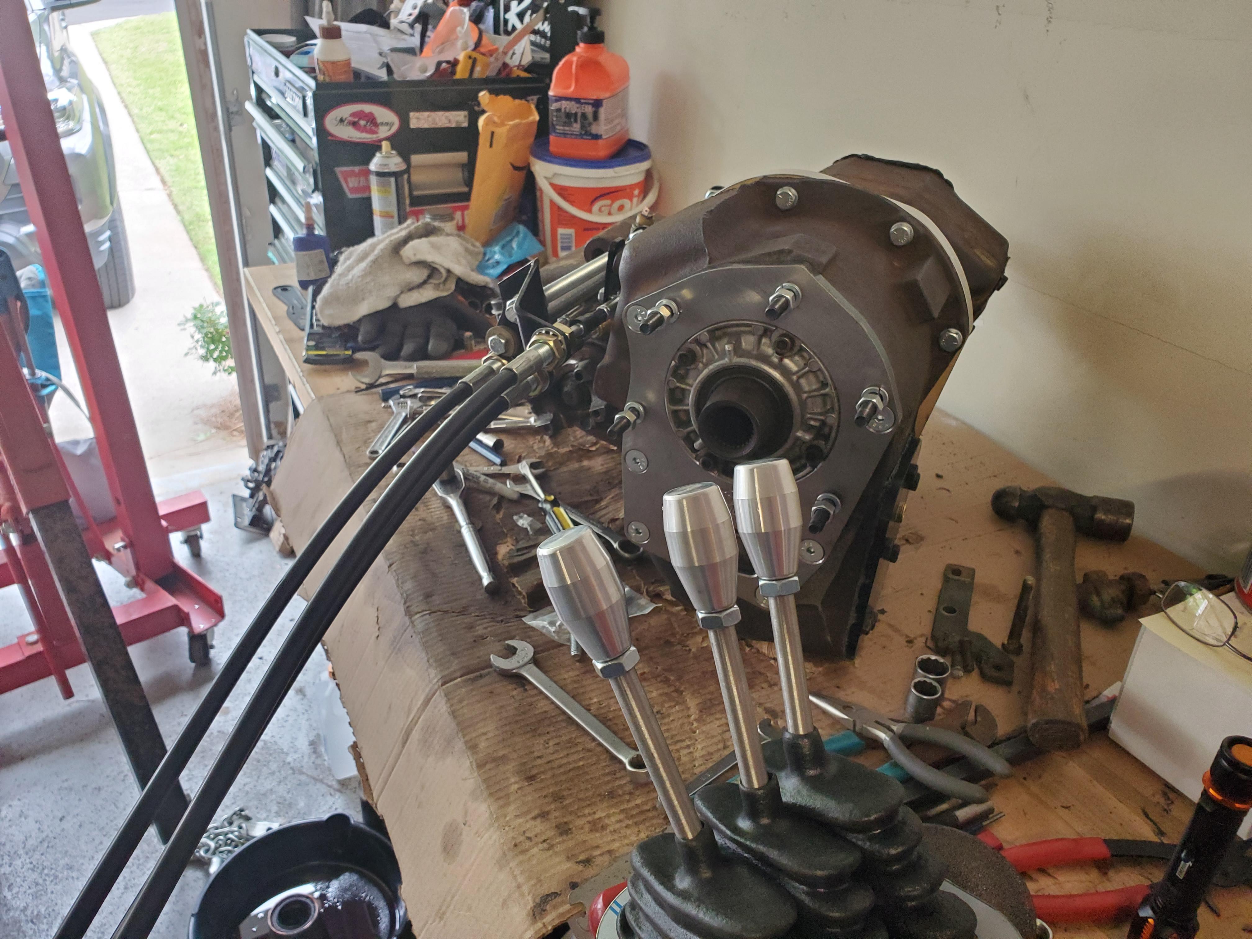

I decided to keep it old school. Found an old, but rebuilt, GM crate motor SBC 350. Less than 10k miles and it was only $100. Also found a 700r4 tranny to go with it.
I'll put a manual valve body in it to get rid of the TV cable and I plan on keeping the lock up function on the torque converter for the over drive, which will probably never get used.

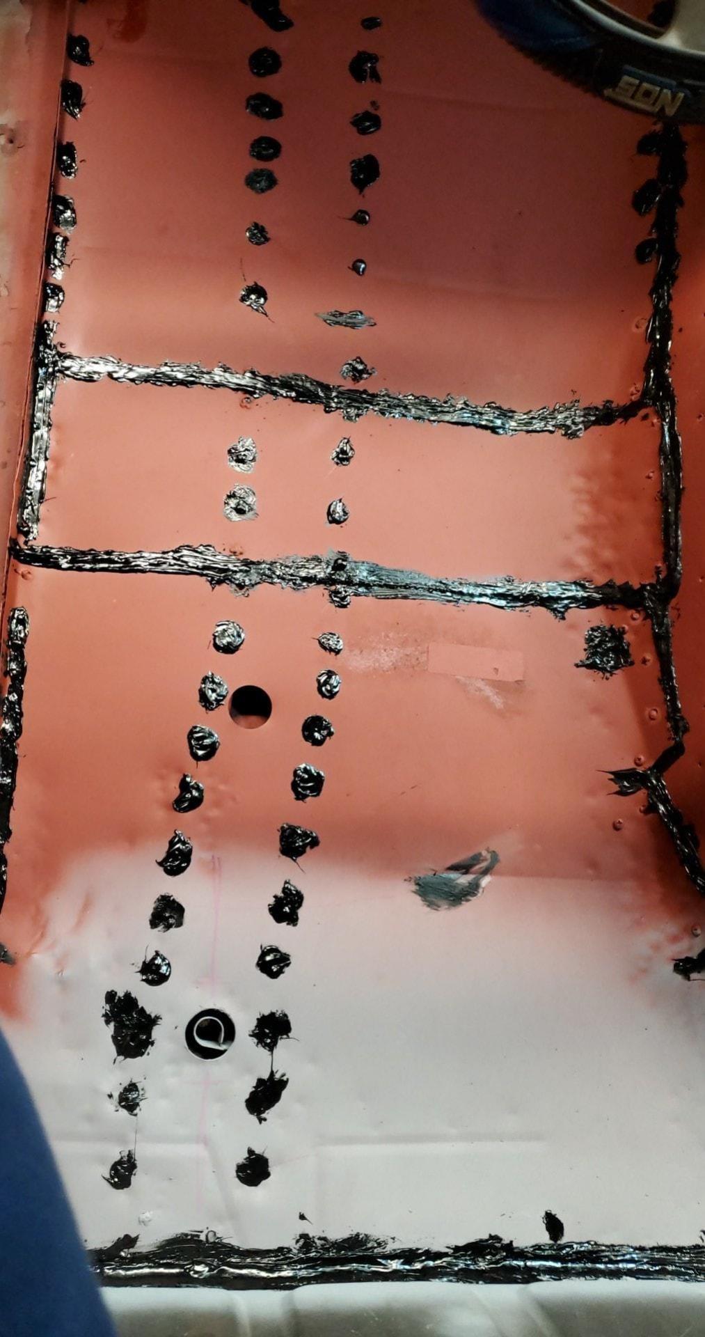

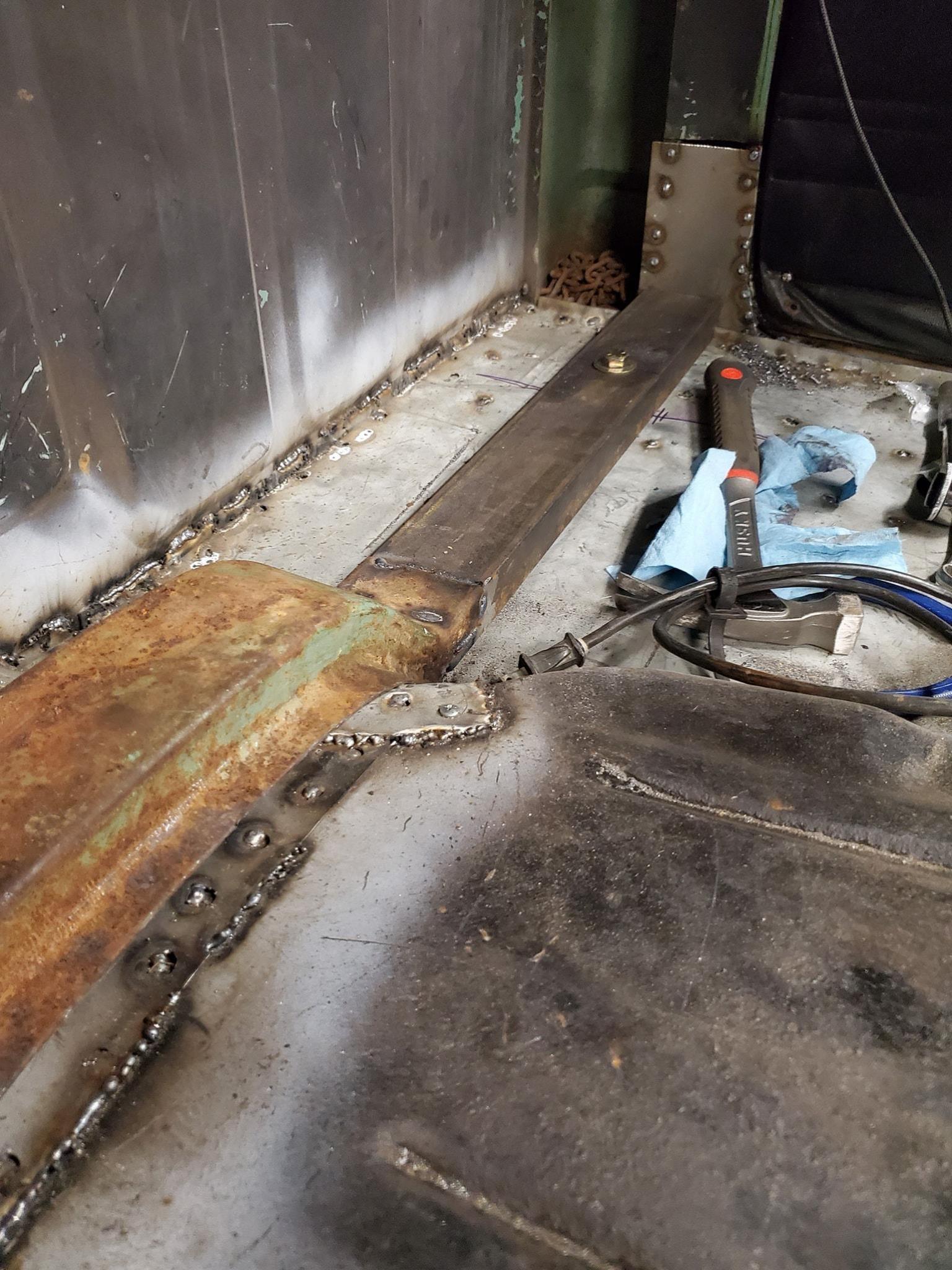

Small update. I'm pretty good at burning holes through thin sheet metal lol.

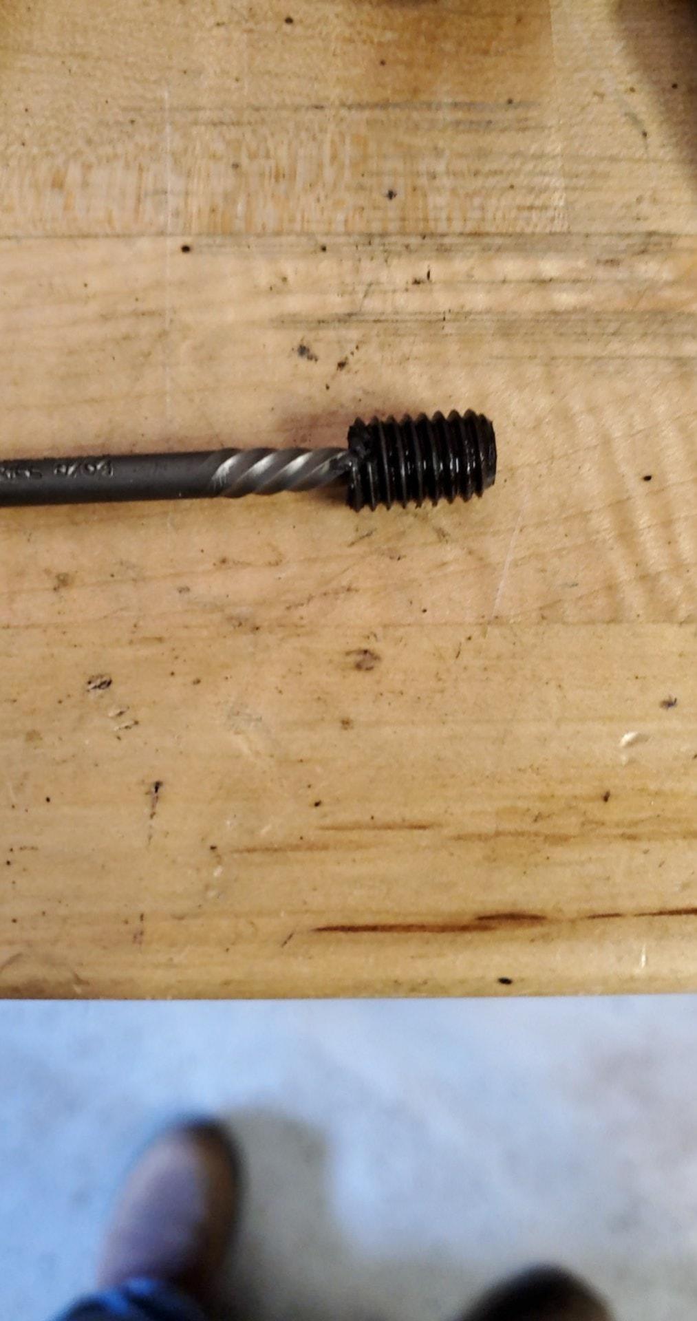

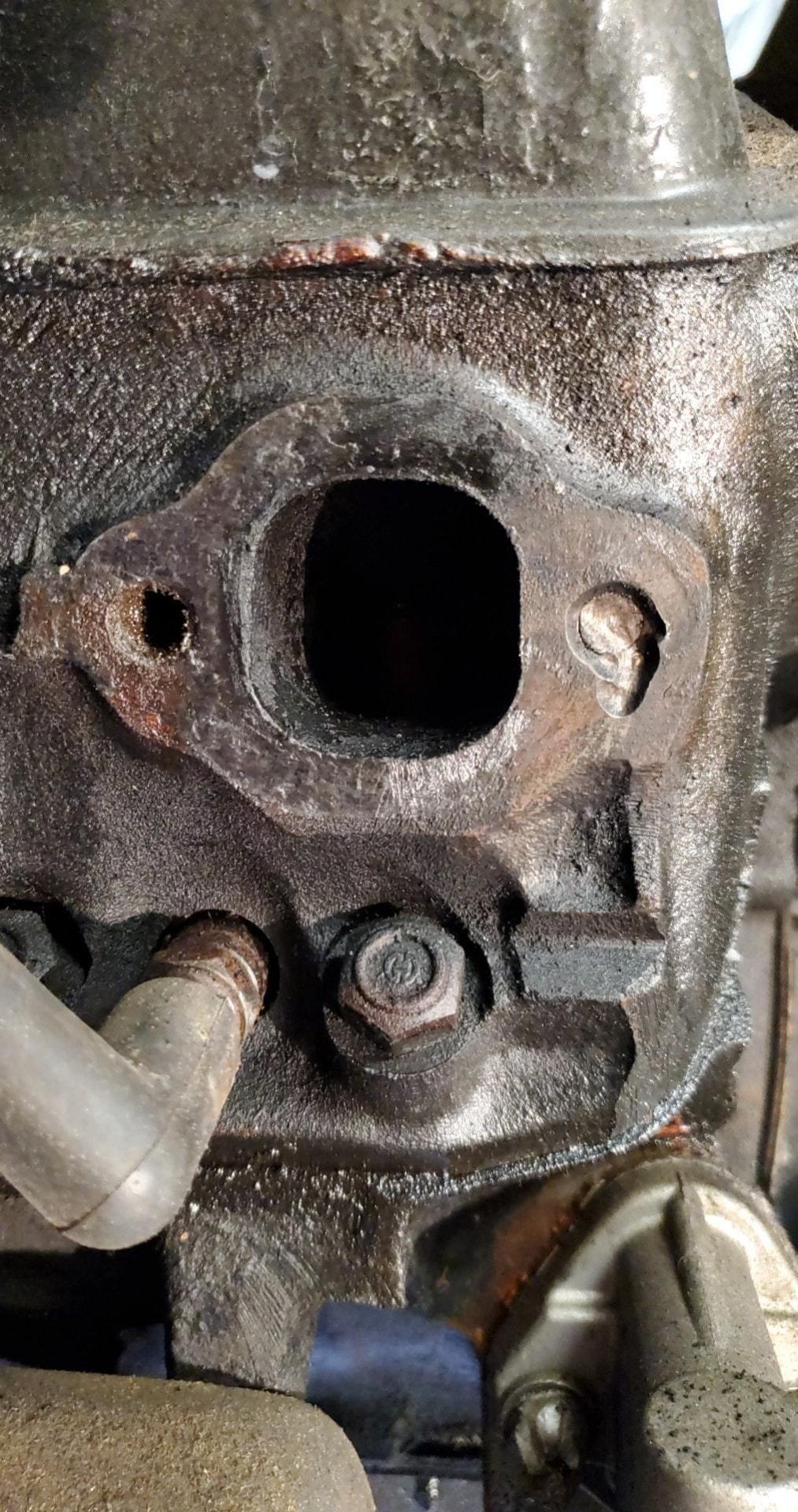

A little more progress. Found a broken bolt on the exhaust manifold. It actually came out with an easy out.

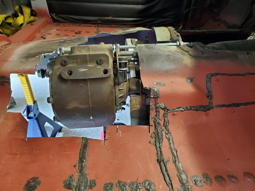

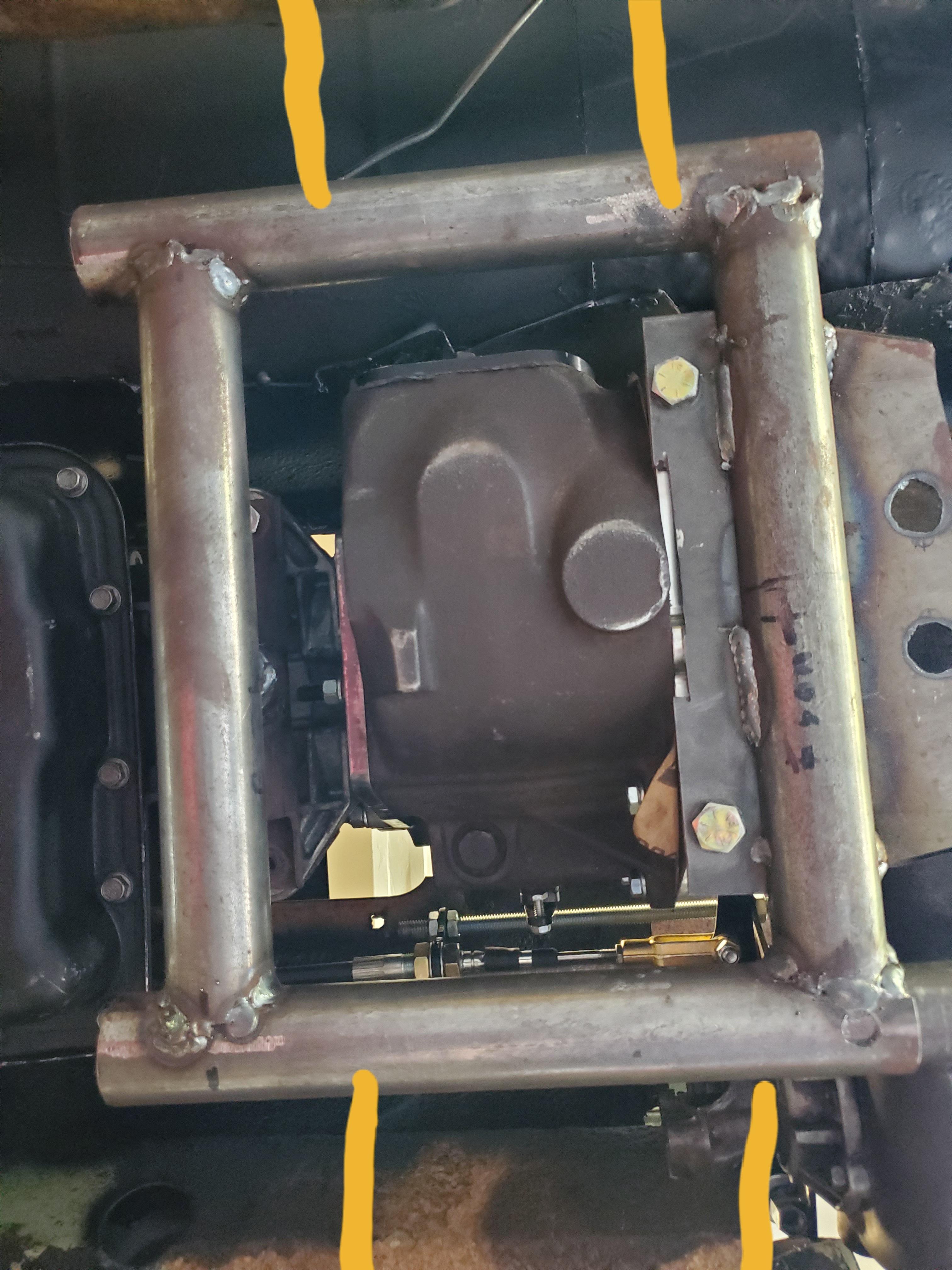

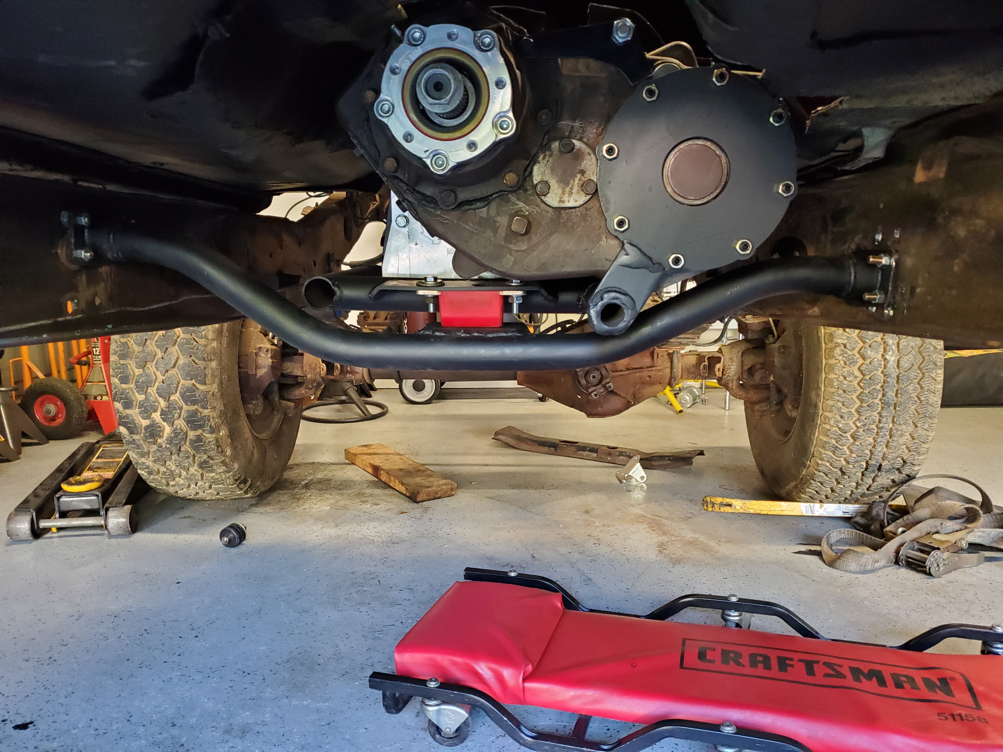

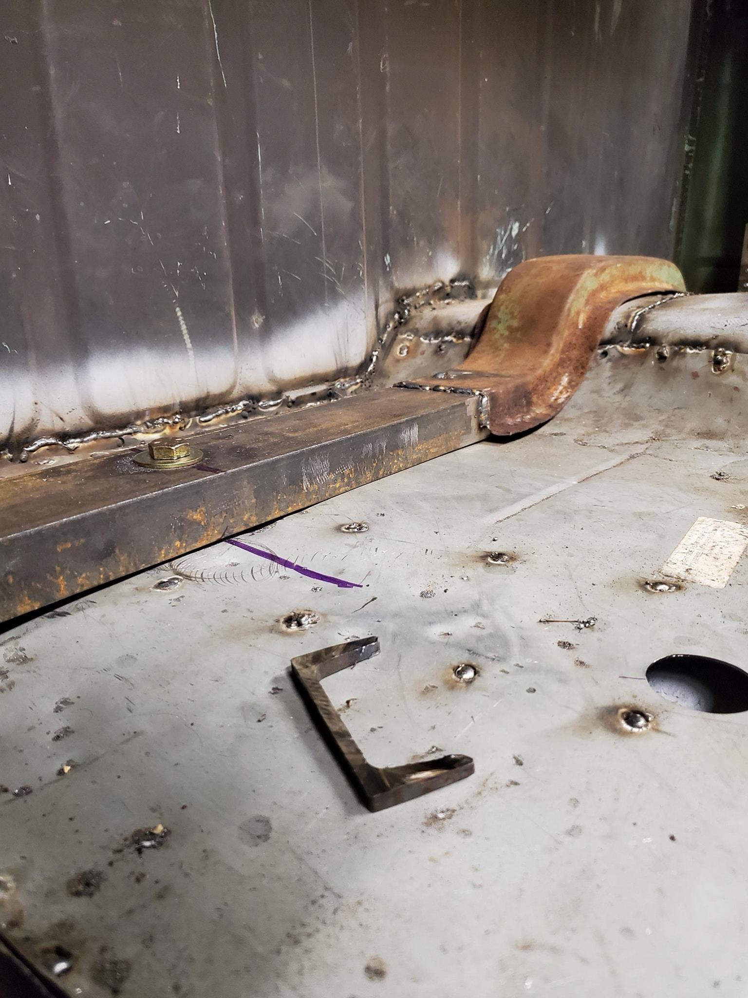

The floor is almost complete.

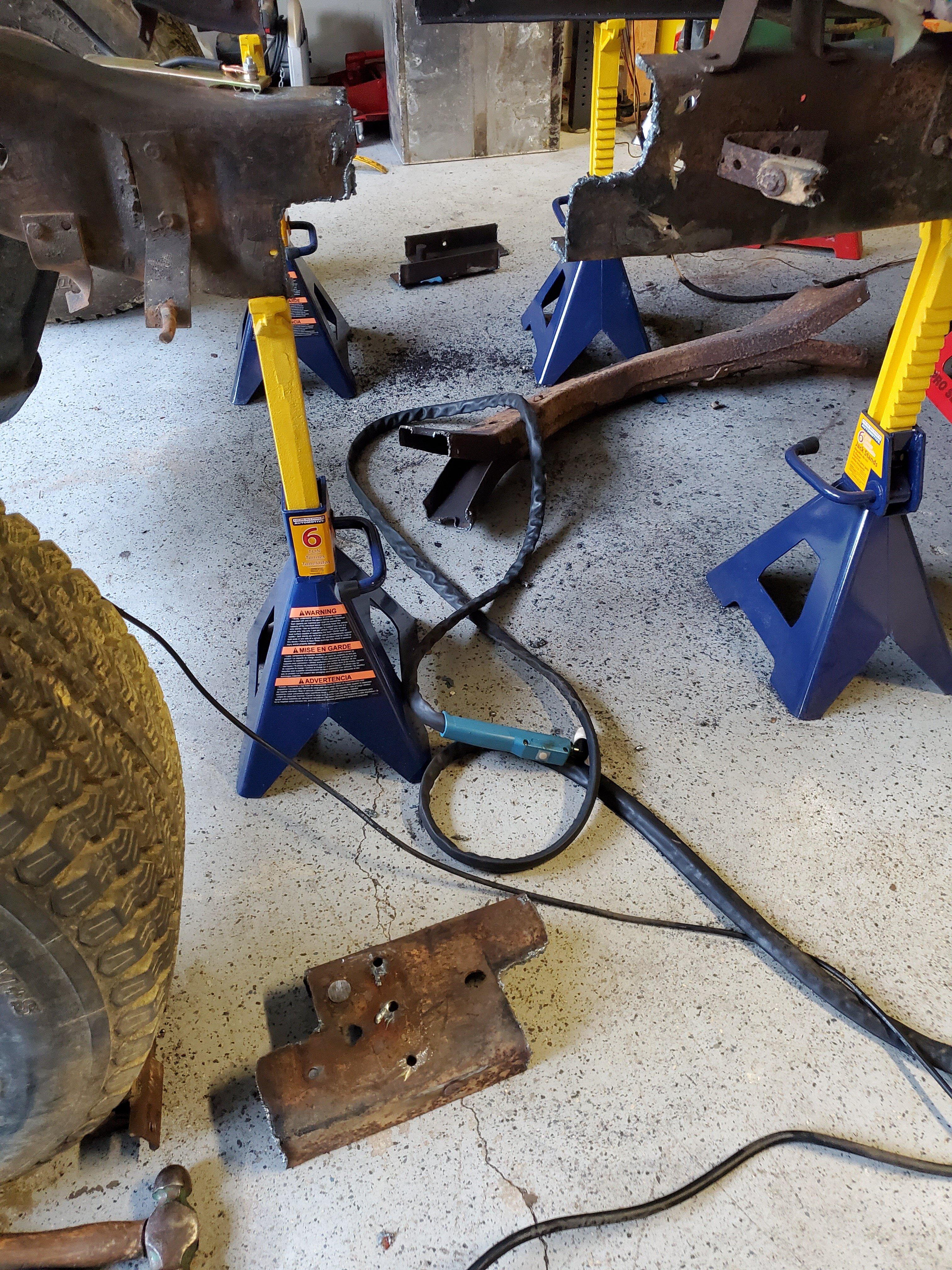

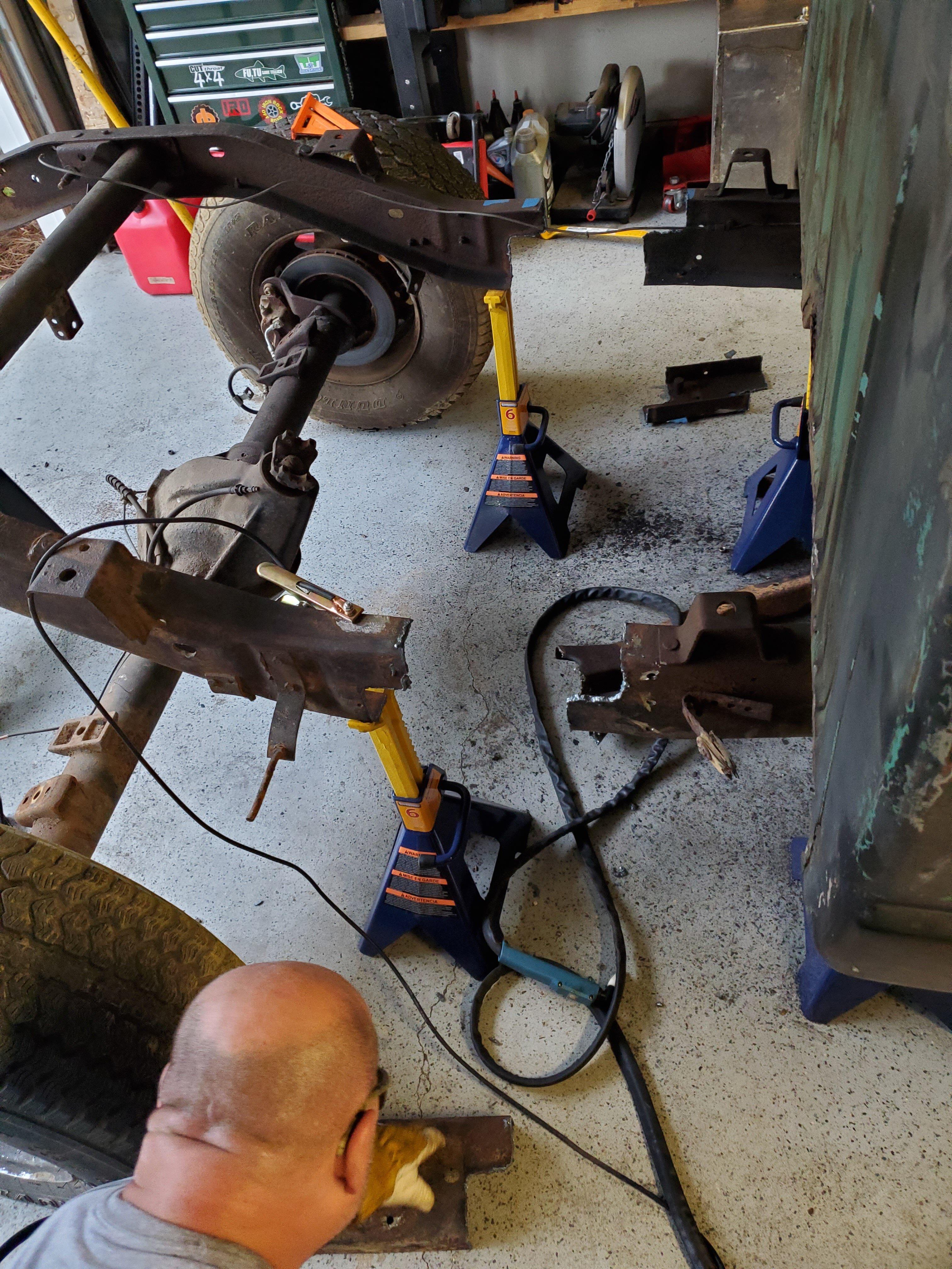

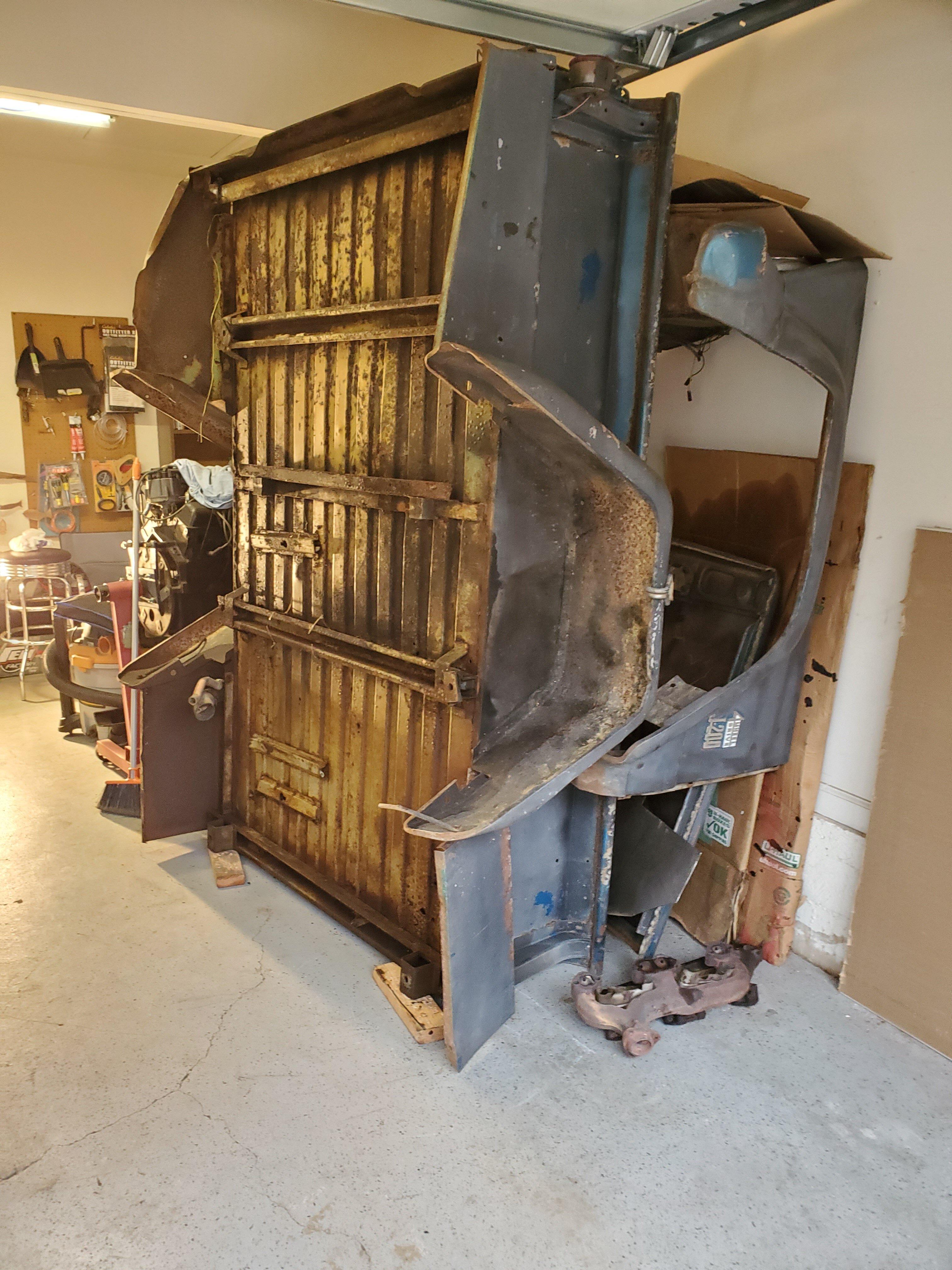

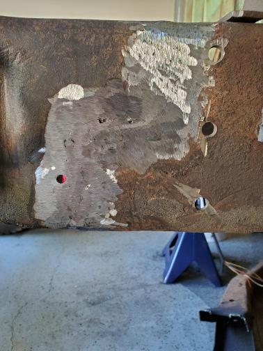

Removed the bed and getting ready to shorten he frame. I have had a few people saying that I should sale the bed and not cut it up. So, its up for sale, not sure what's it worth.
Hey Chuck,
How much are you chopping off the frame?
What's your wheelbase gonna be?
It'll be cool to have another J truck on the trails.
Used to be I'd see them in the dirt occasionally, now not so much.

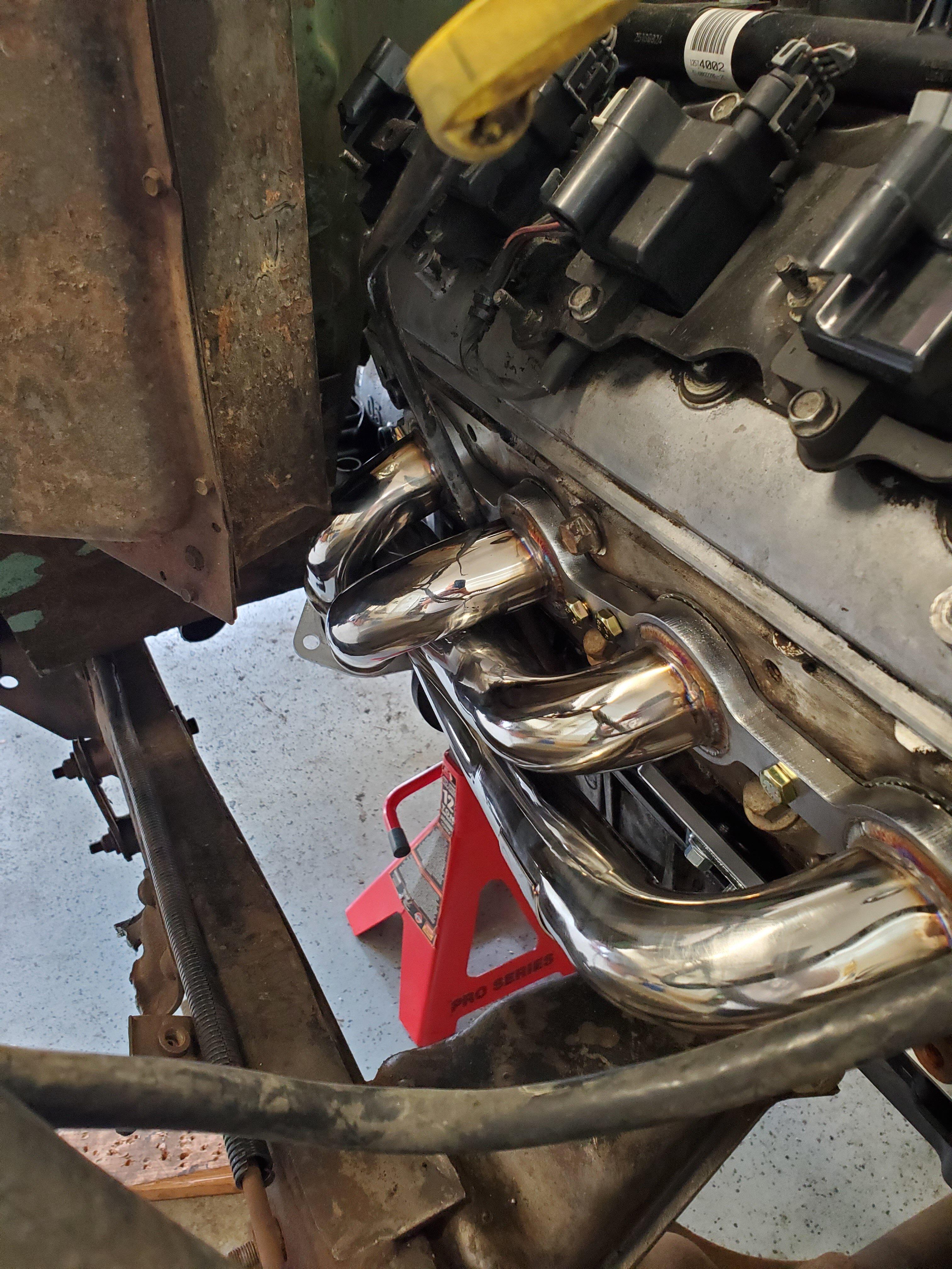

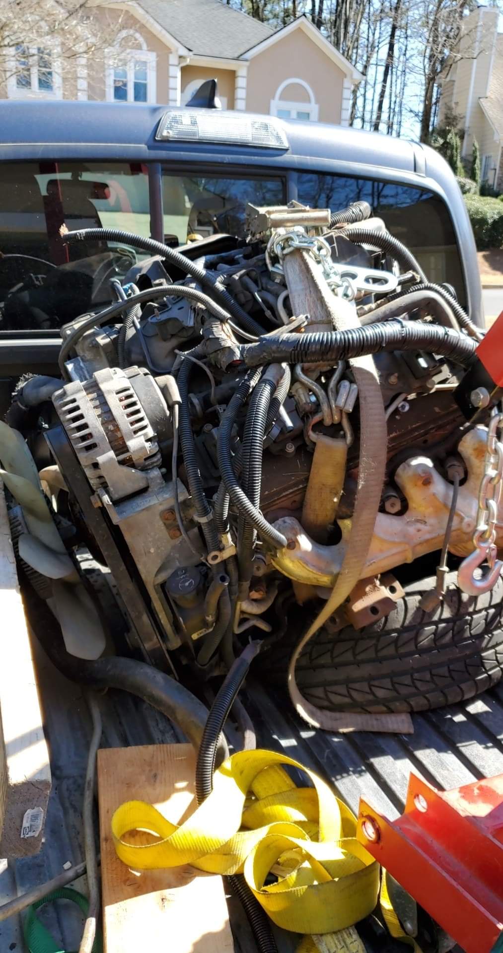

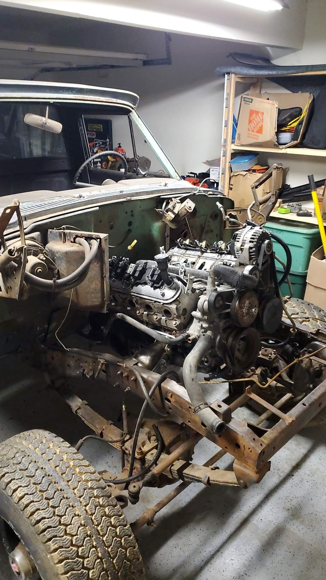

I feel like I have adhd or something. I have been looking for a fuel injection system to put on the old school sbc 350 but, then I found an LQ9 for the price as a fuel injection system. Now I need to source another transmission and transfer case.
I can't even get started lol.
