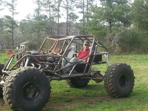

the tires i am still open for, i have been trying to trade my H1 16.5X8.75 8 bolt beadlocks with 16/38.5R16.5 Super Swamper TSL's, i'd like to run a 42, by friend nathan let me take the pictures of my buggy with his 42's. i think it made the buggy... I picked up the chassis the last weekend of January, and we have been working on it ever sense.

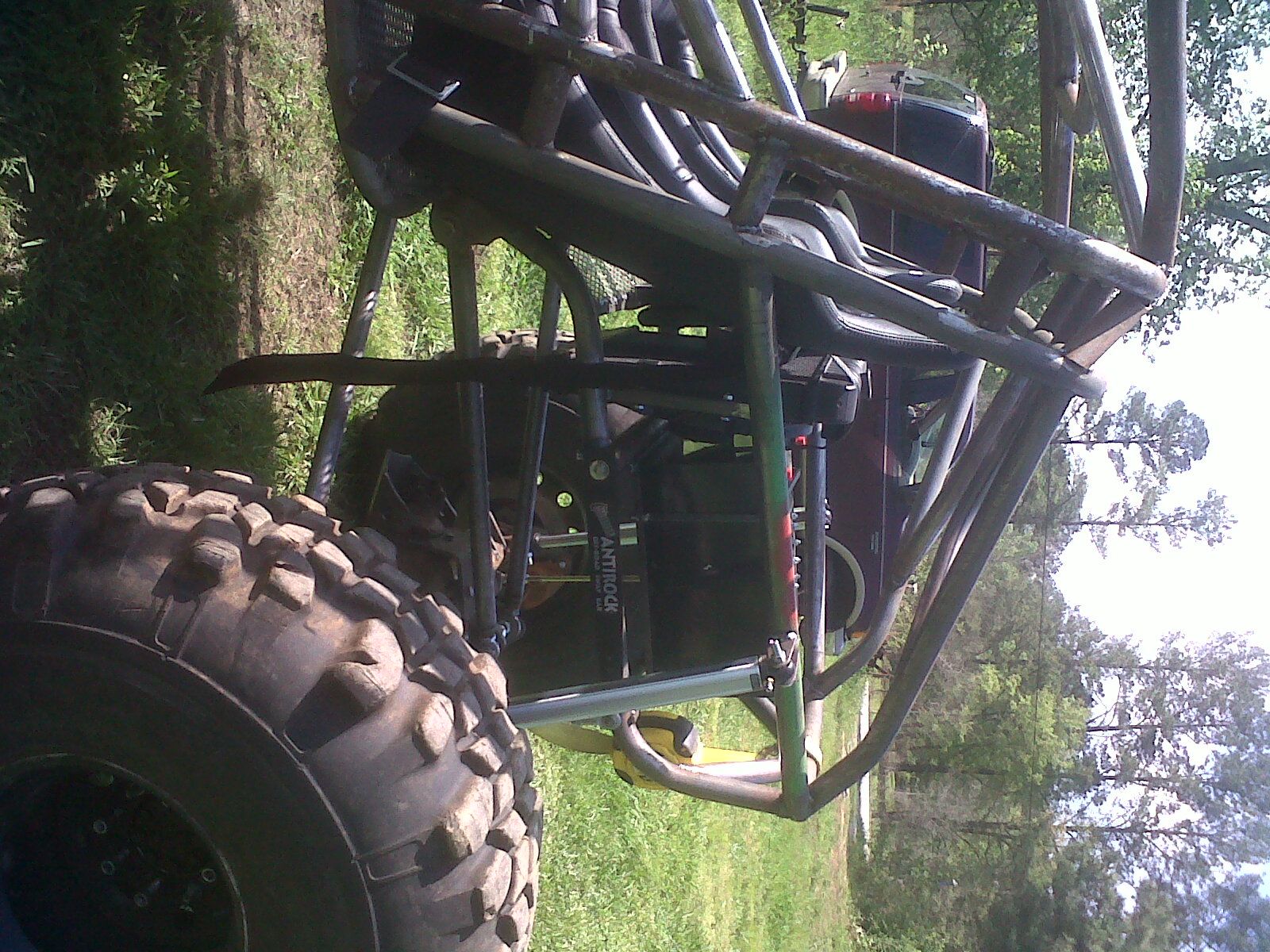

buggy pics

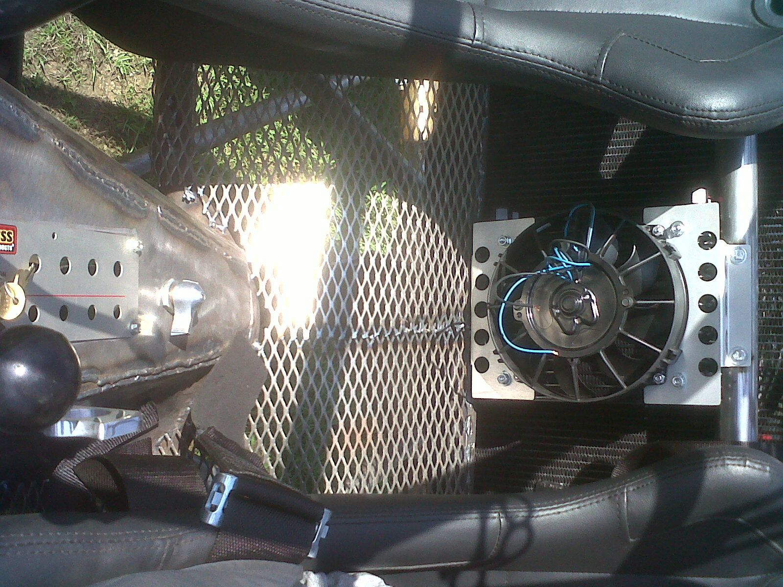

Rockwells607 said:
looks good! only problem i see is the rear driveshaft going threw ur cooler, gonna dump all the ice off the long necks! :drinkers: :driving:
haha, yea, we found out the problem, too many long necks while trying to climb into buggy before seat and cooler were mounted... lol. we're gonna have the huge problem fidgured out before trail time..... :drinkers:

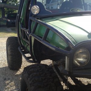

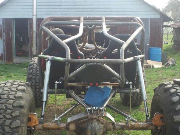

more pics
