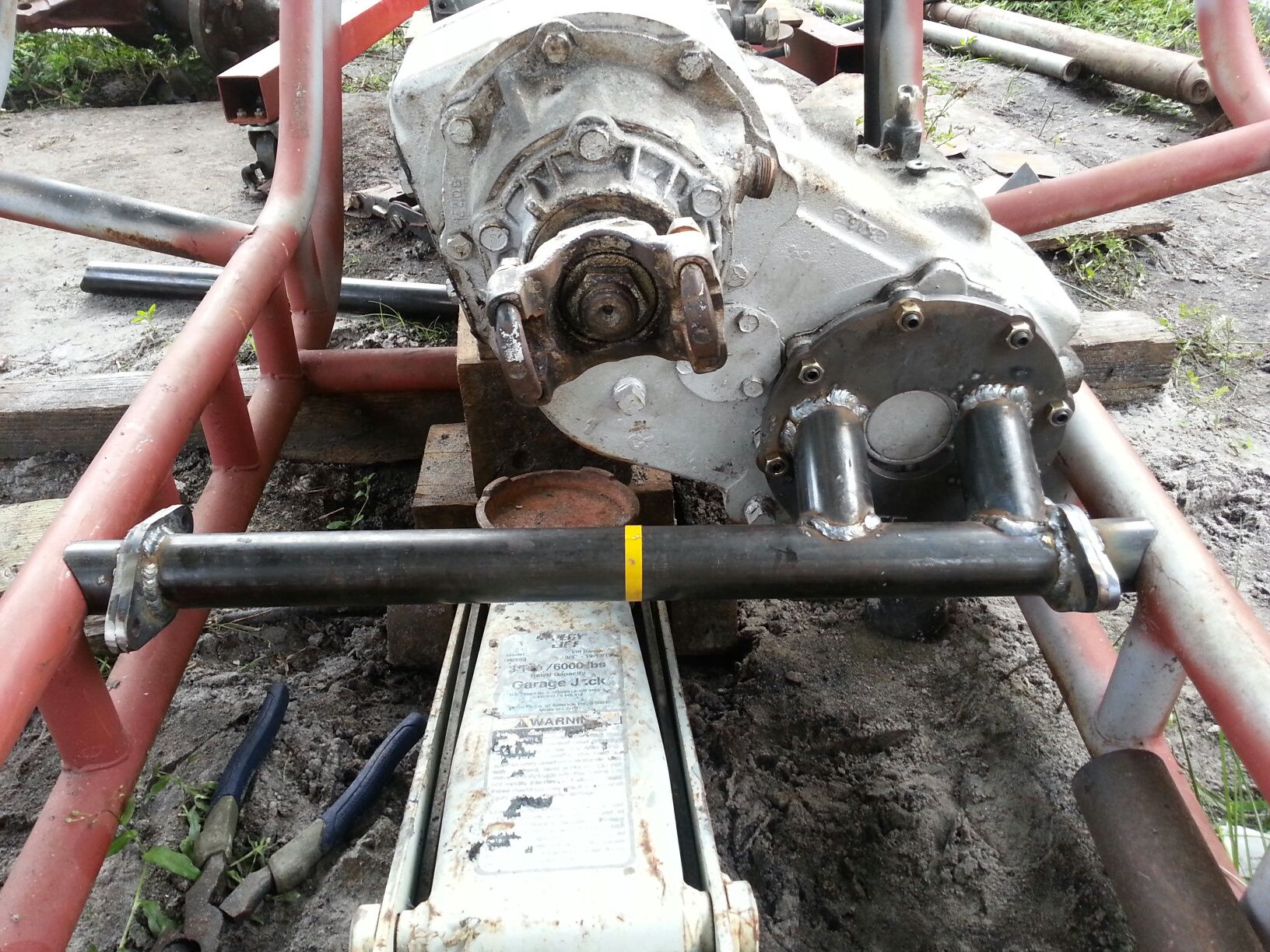

I added some tube to the front. And here is the transfercase mount I built.
