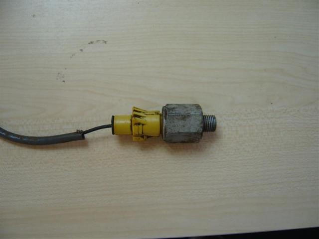

somebody looking for one of these?
whats it worth to you?:fawkdancesmiley:

WAHOO!!! So Mike, did you get a knock sensor or do we still need one?
