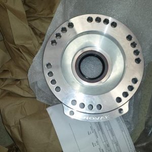

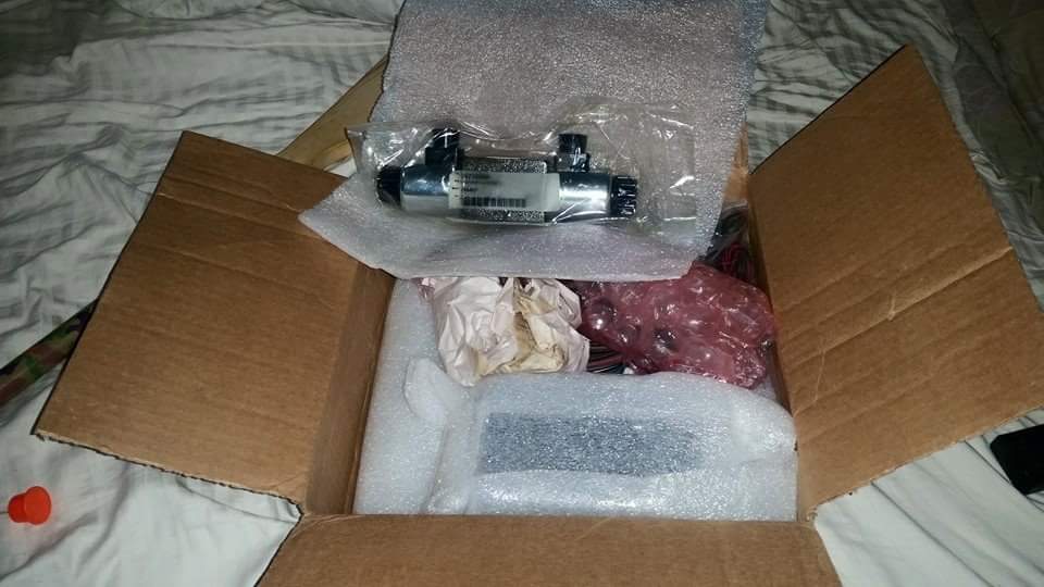

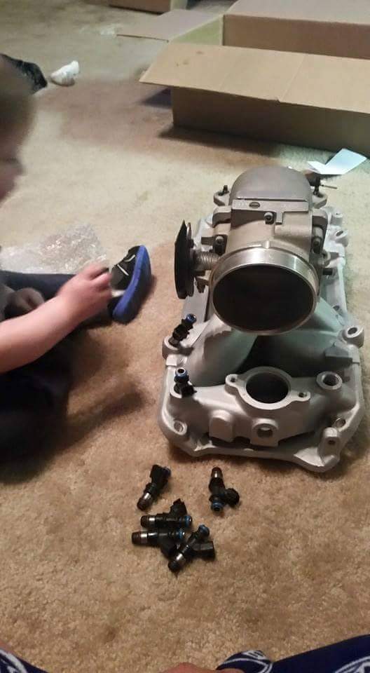

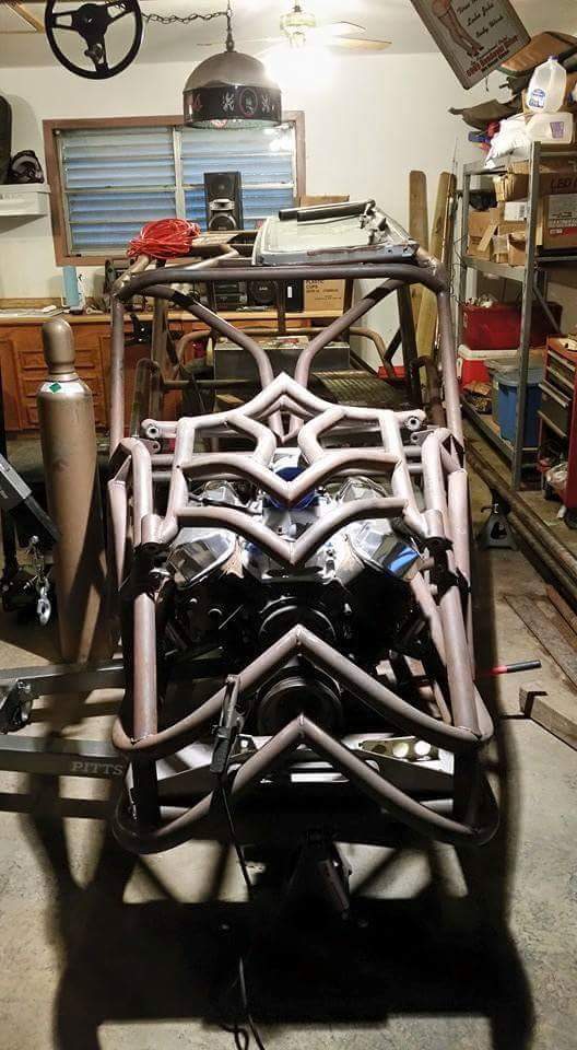

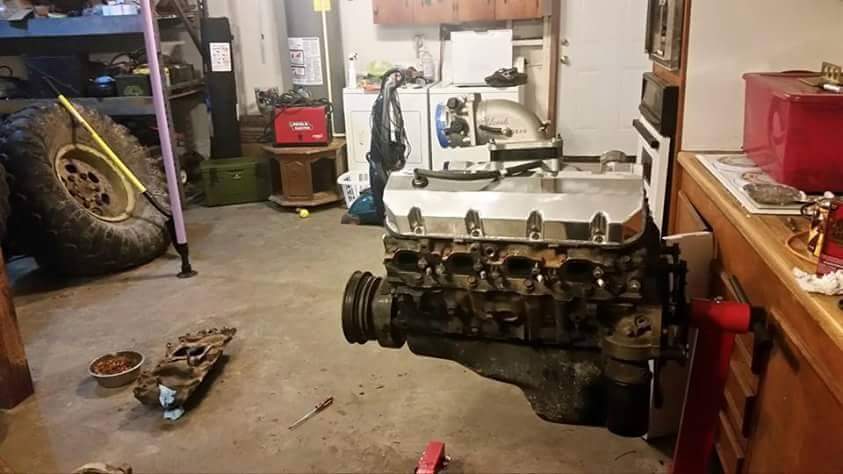

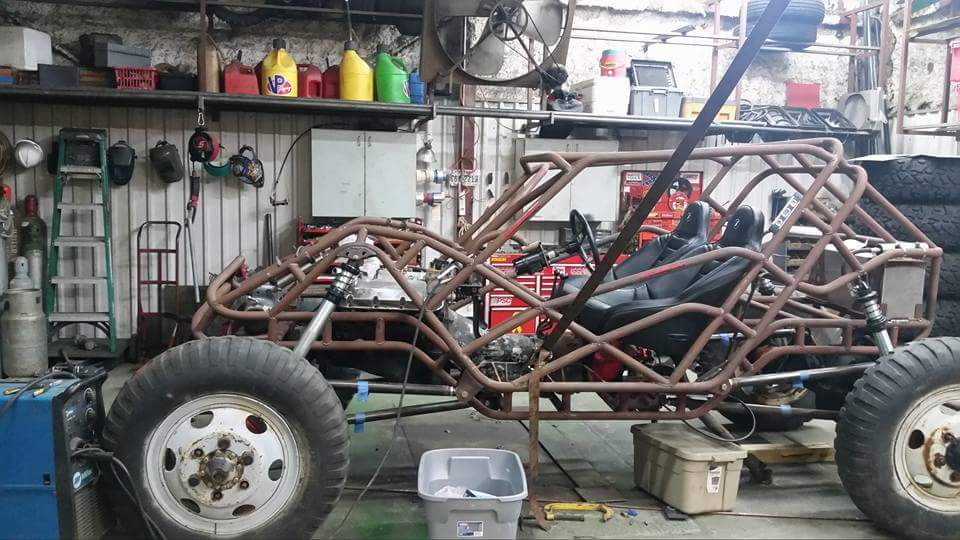

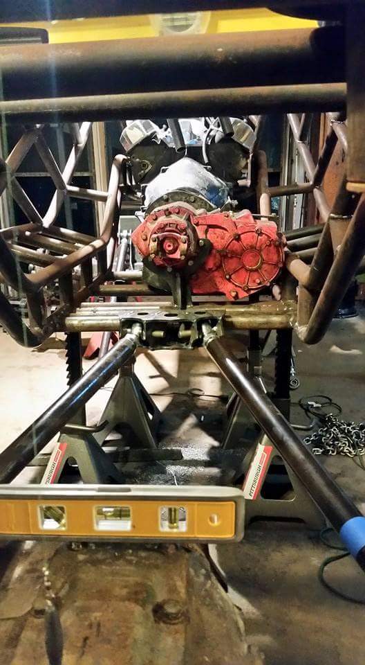

my mistress buggy build
Hell I can't post pics
More pics
More pics
More pics
Pics
Pics
Pics

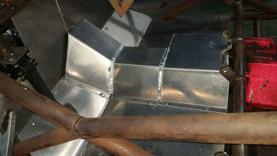

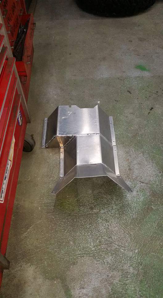

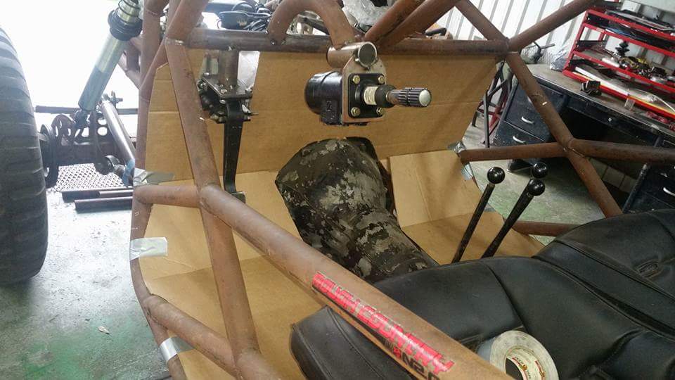

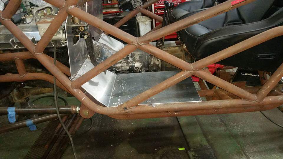

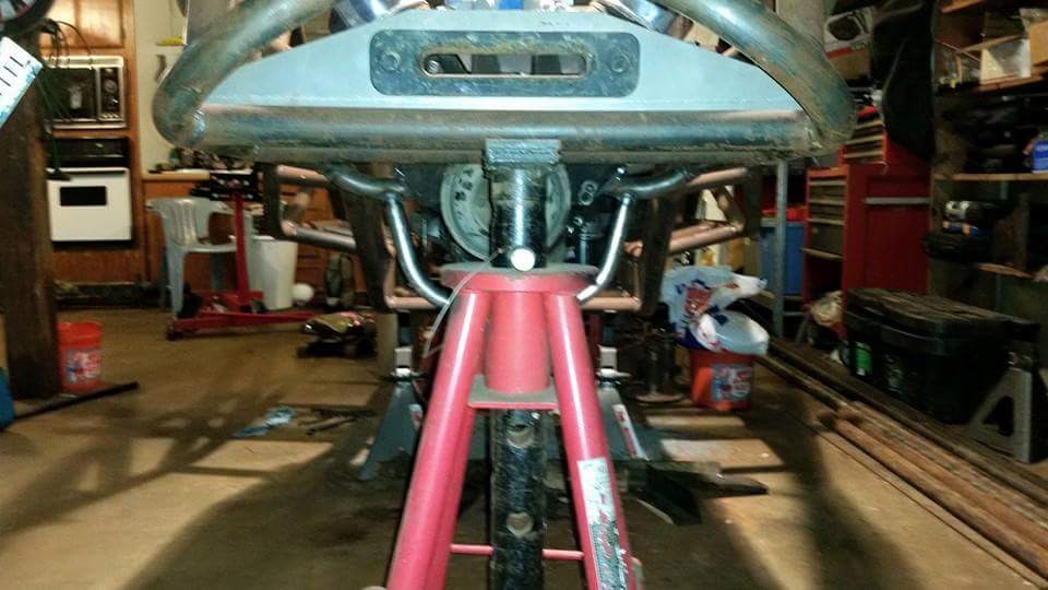

Got foot and fire wall mocked up

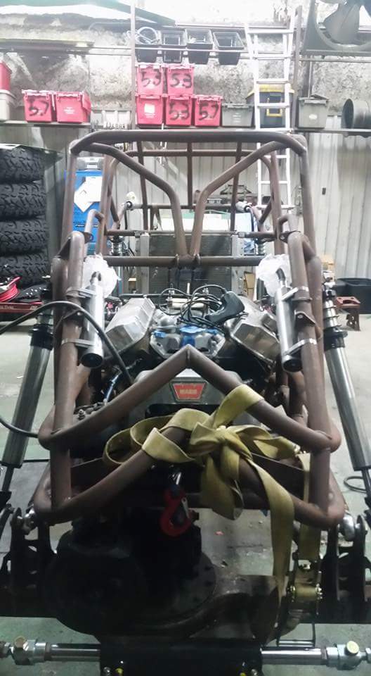

Pan in

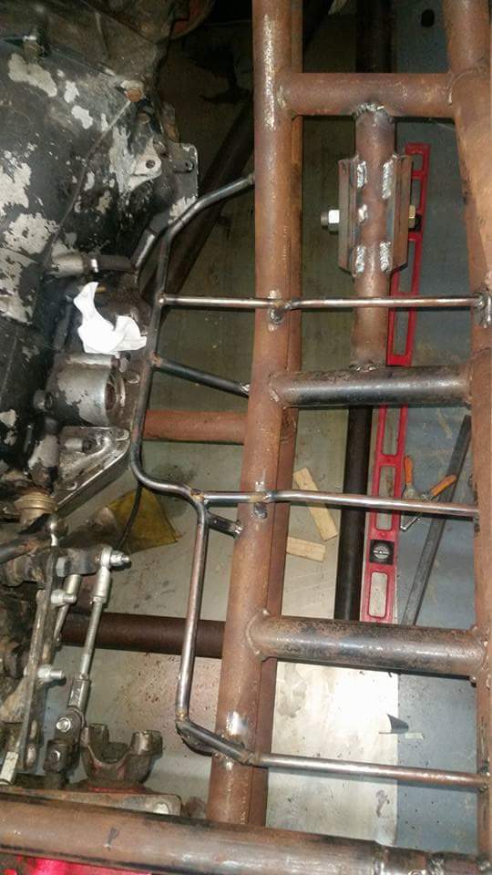

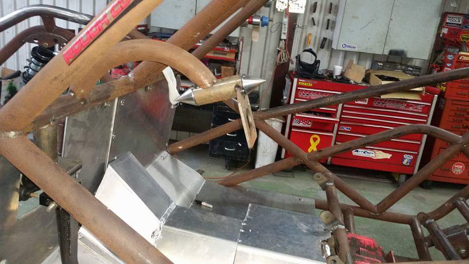

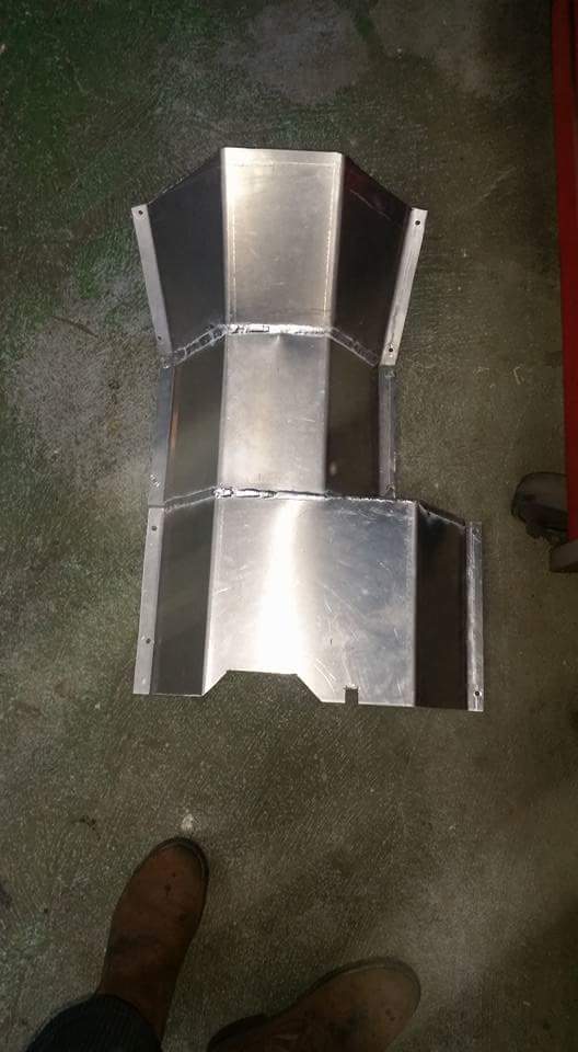

Did a little tunnel work tonight
I know my buddy who was helping me like to draw cocks I guess if u look close there Is a open mouth also

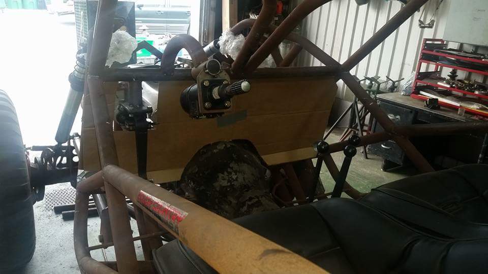

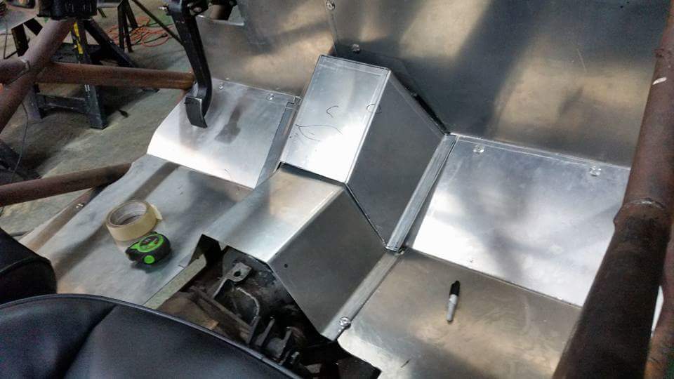

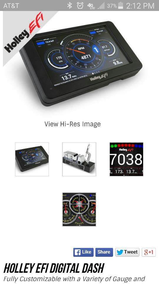

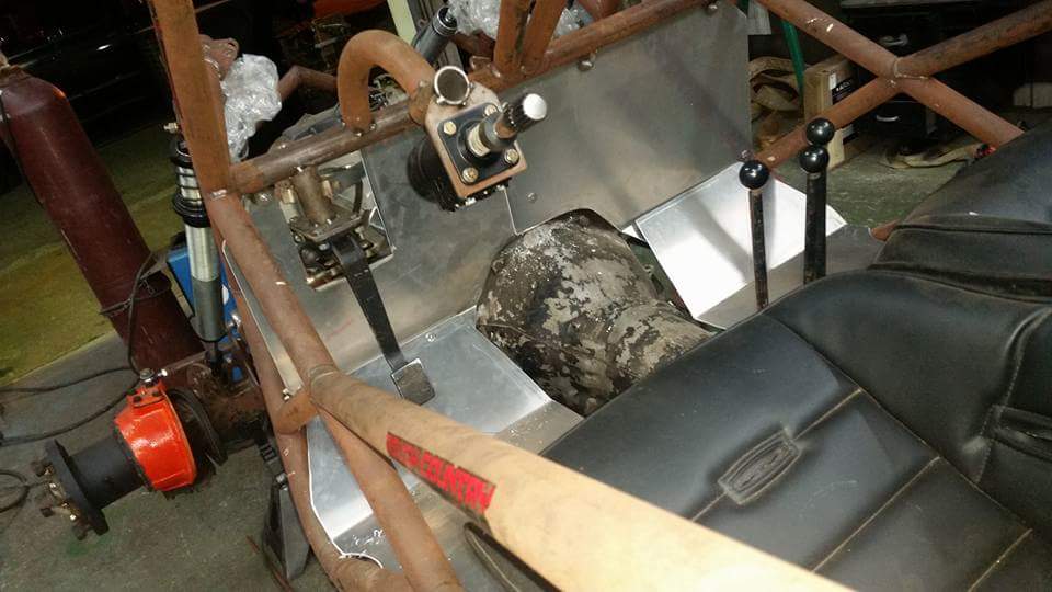

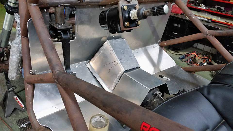

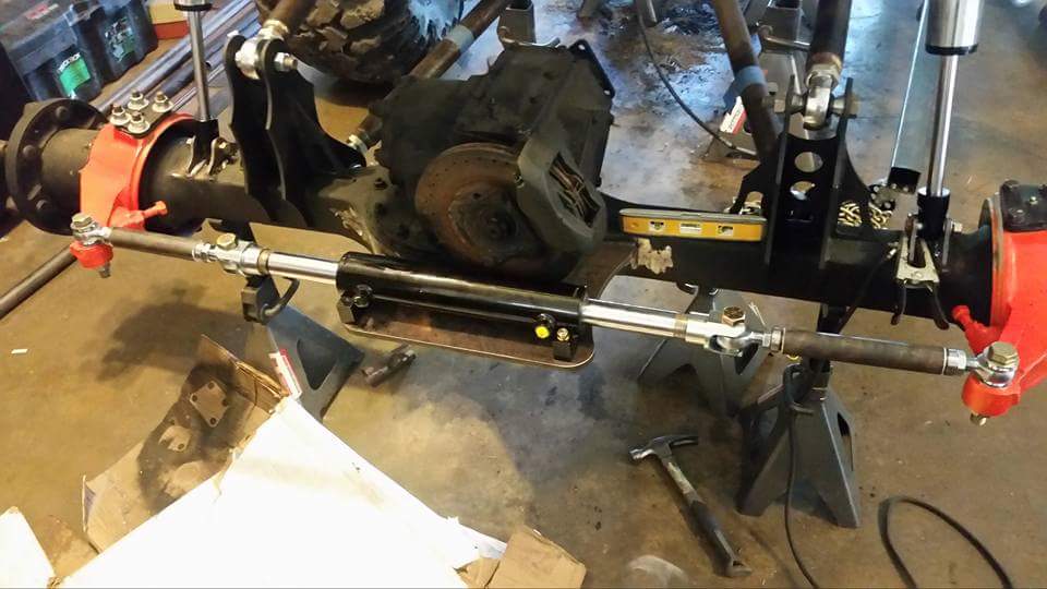

Did some work on my buggy first console I have made
Couple more pics

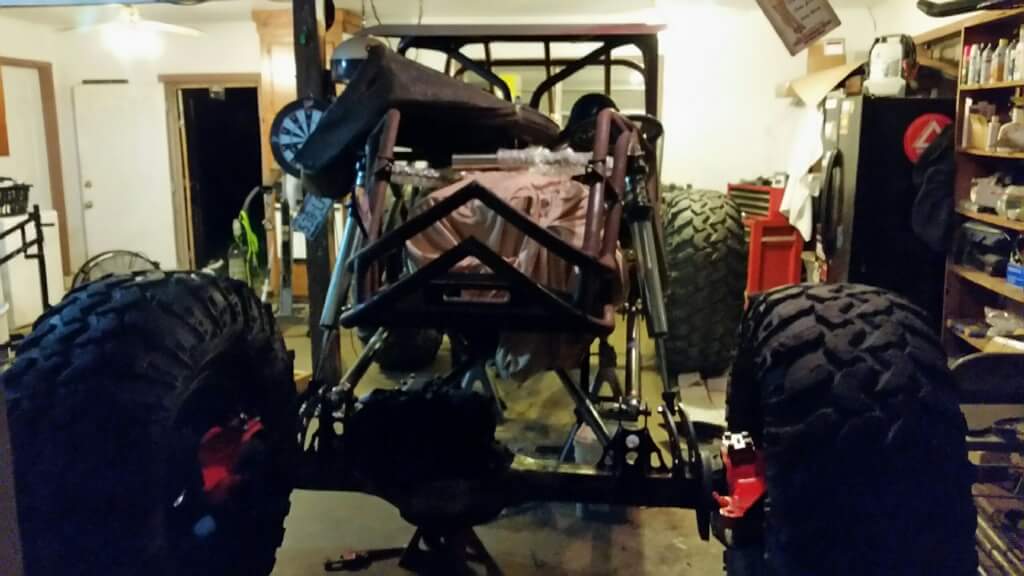

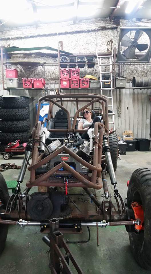

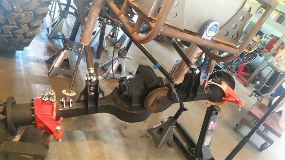

You will love that steering cylinder. I don't know if I would trust that mount tho. PSC clamp will fit it for a double mount. I used the same one on my rock wells. I stood a plate up and bolted the cylinder to that and used the PSC clamp down flat. That also makes your hoses stick up instead of forward. My .02
