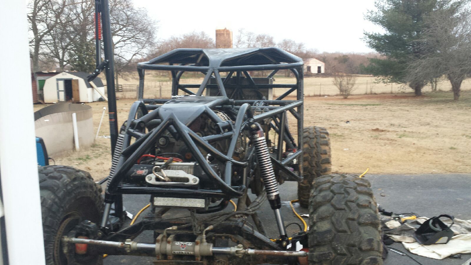

HEE HEE,,,,,,,,I swung by Petes & gotsome update pics yall,,,chassis is back from powder coat & Petes puttin NASTY TIME together,,,,,
Yall this mochine is flashemifyougotem

I noticed you have a crankcase evacuation system to vent the engine, I'm wondering if you have any concerns about dumping oil inside the hot exhaust if you roll over. I have been wondering about how to properly vent my buggy engine without creating an oil mess upon rollover. Thanks.
One in back is tcase as far as vents it will smoke some in roll but haven't had this set up dump oil due to the check valve
