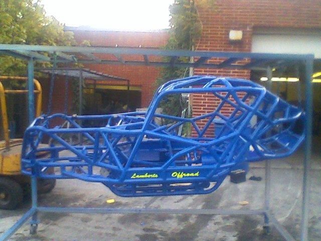

nope. not at allTwistedVegas said:Any relation to Lambert's Offroad in Tyler , TX?

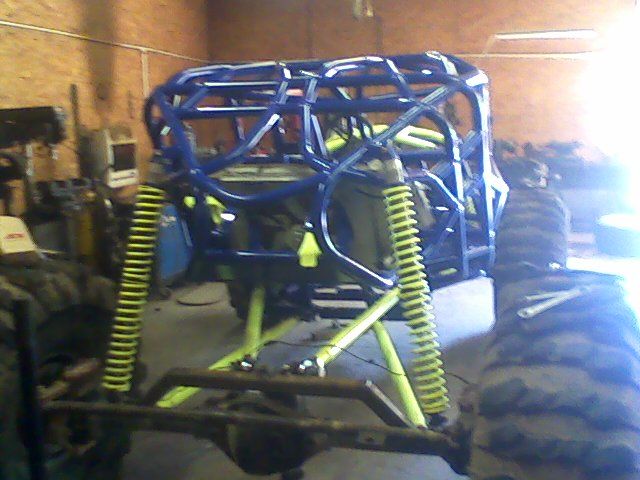

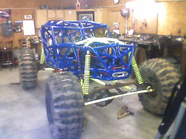

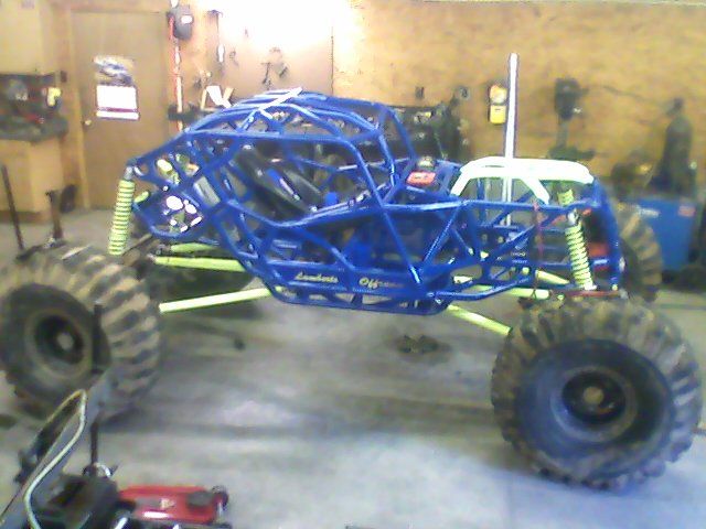

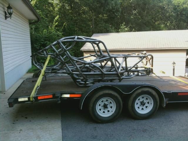

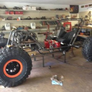

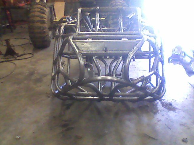

116in wheelbase. 20in belly 5ft-10in overall height. 16in coilovers rear with about 7in uptravel. 14in front with about 7in up in twist but about 3in straight up because we set it all low for a low center of gravity. 383sbc with a 400T and NP205. D60's with yukon chromoly shafts and solid joints all around. centered steering rear.greenlion said:Mind giving some specs? WB, belly, how tall, up travel. weight? Thanks
