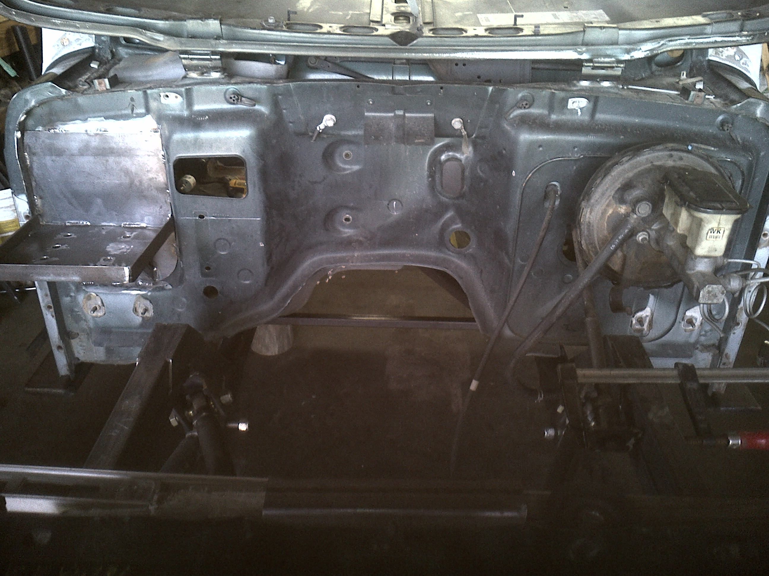

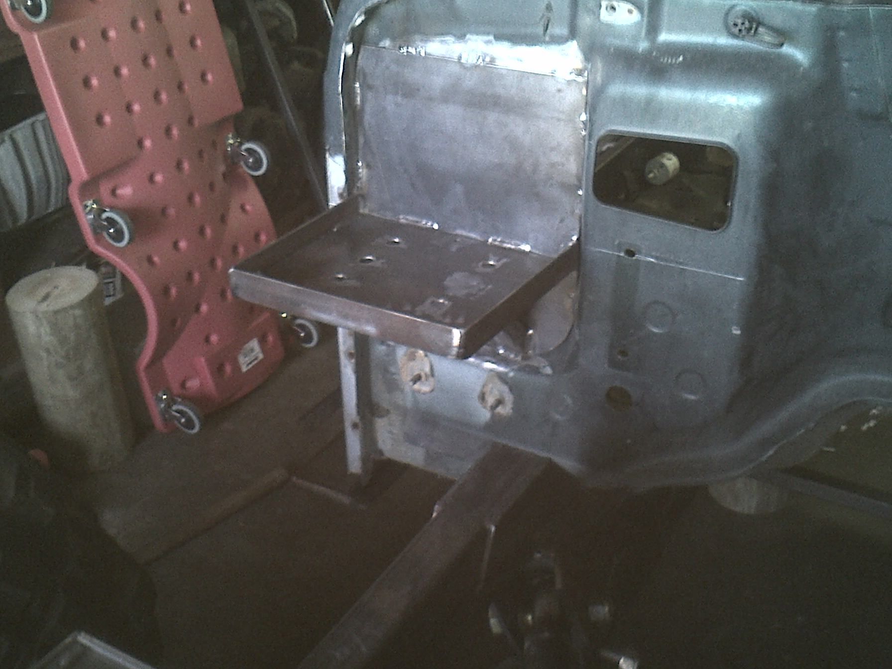

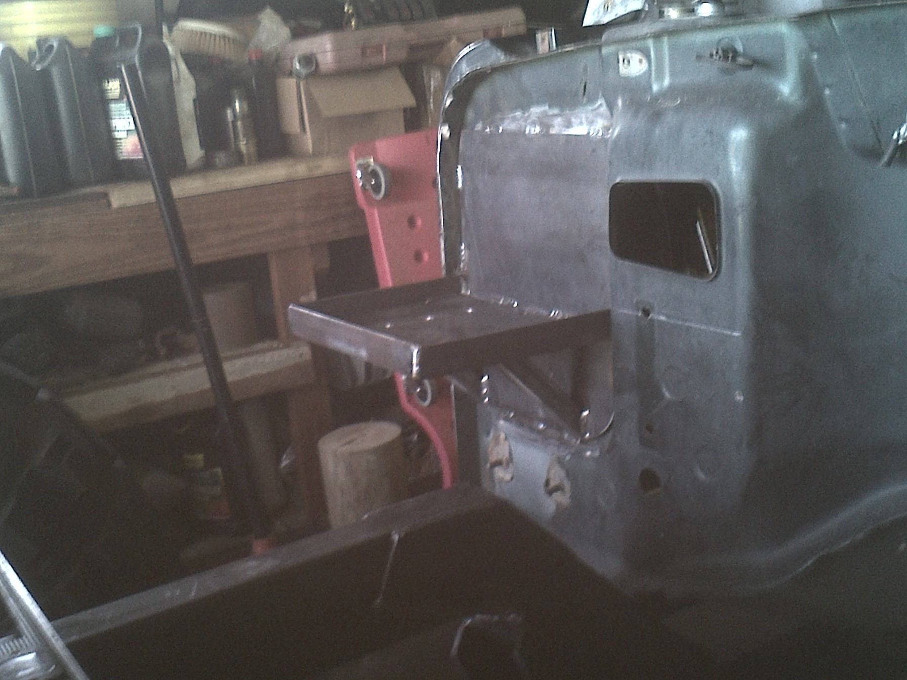

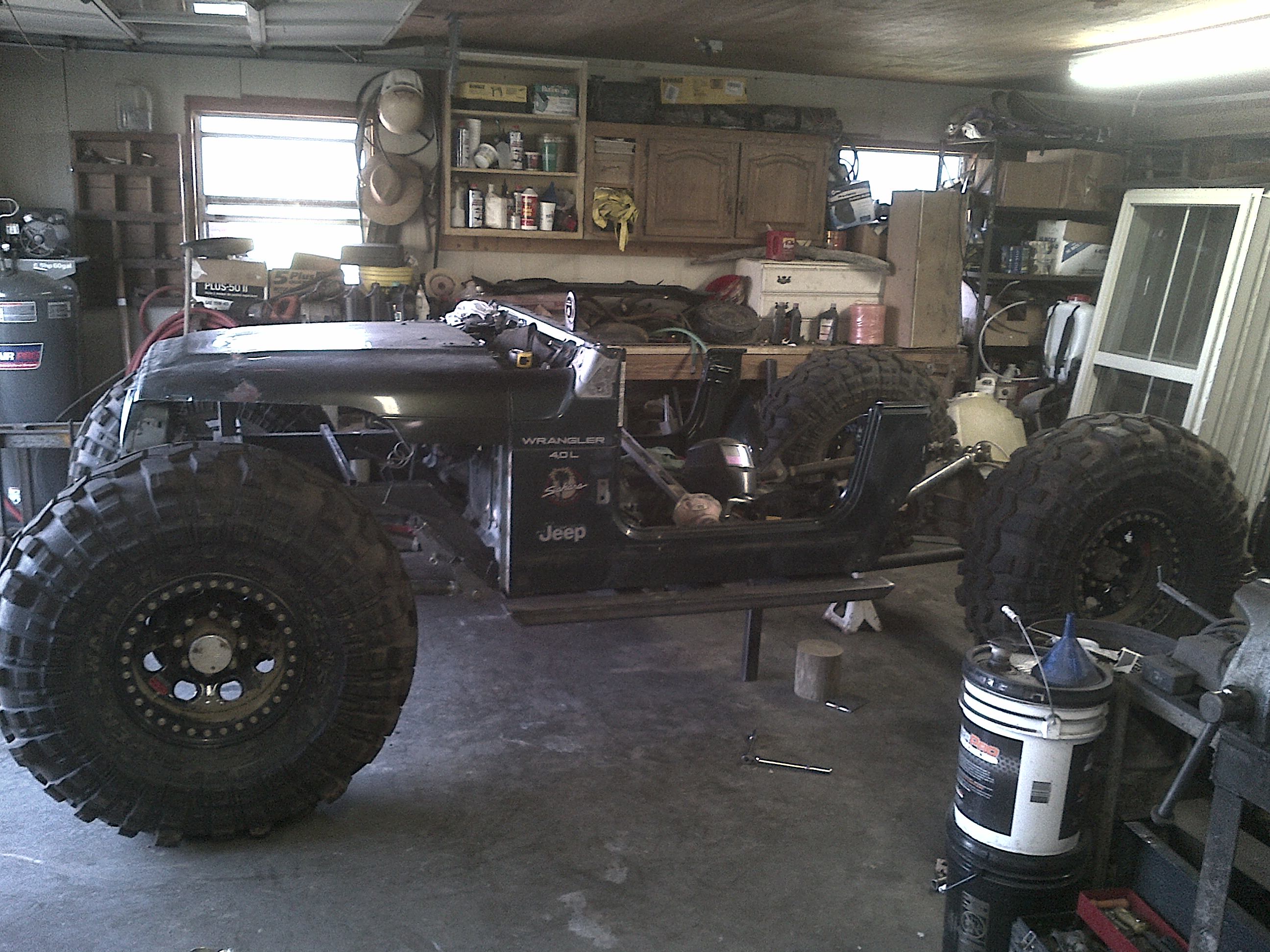

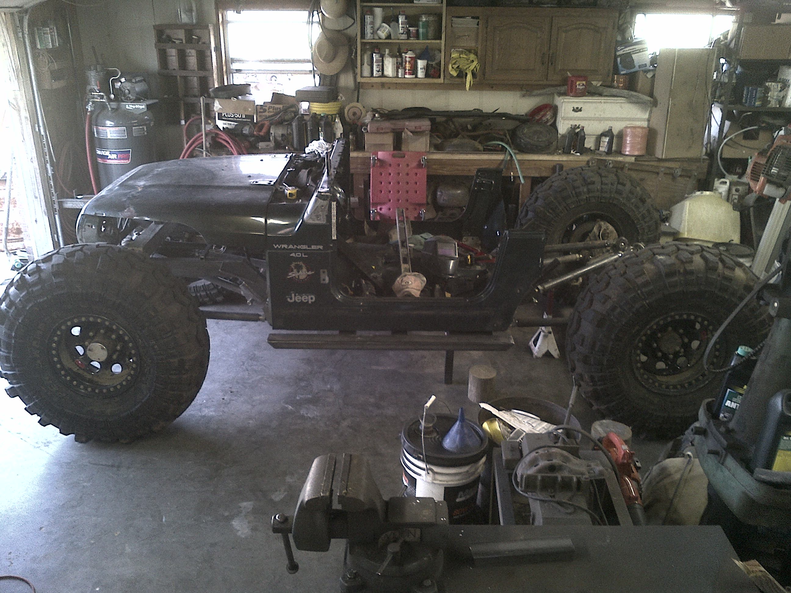

Slow progress, still working on motor and tranny. Been tinkerin with body some.
