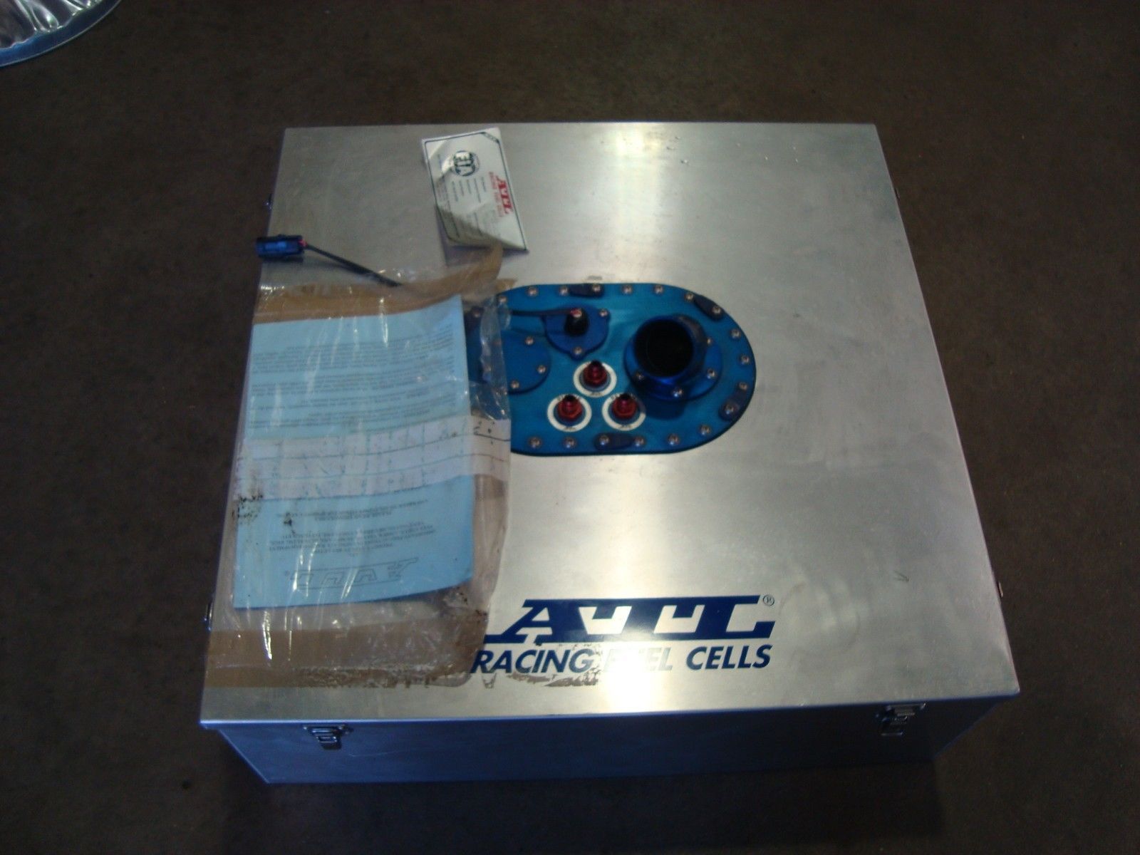

Have a new shock mounts to fit all round, new battery boxes and a new atl fuel cell!

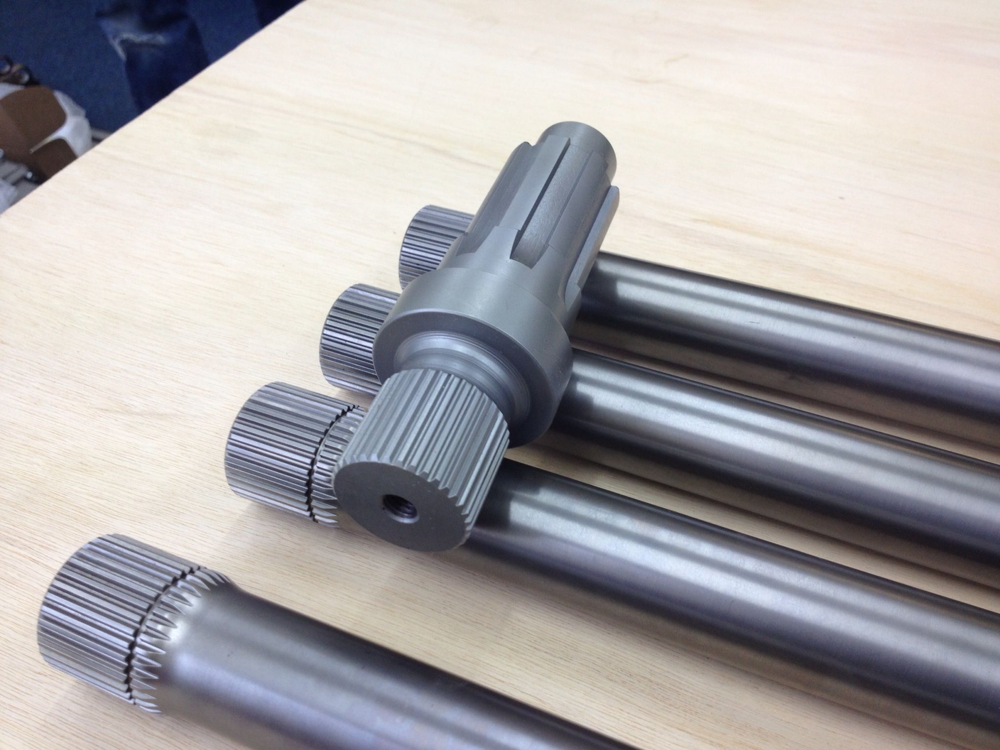

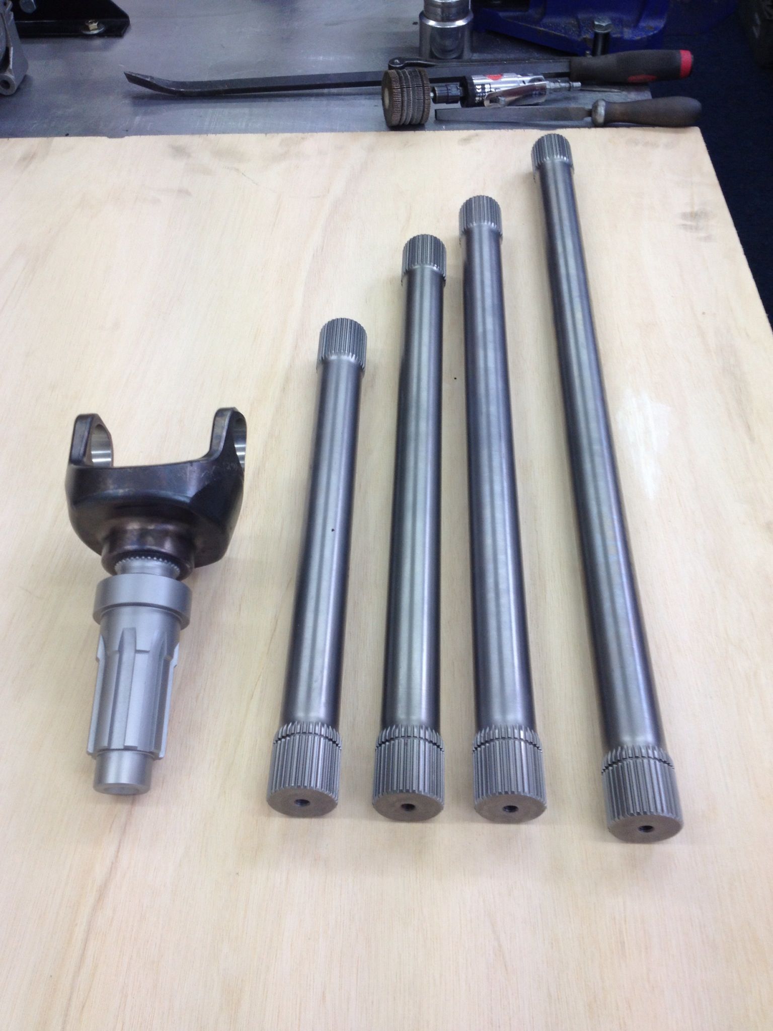

Progress with this buggy had really moved on and i have been making steering arms for the spidertrax knuckles and milnershave made me some sweeeeeet half shafts for the custom portals and the ctm joints ! pictures to follow.
If all goes well i should have the truck fully dry built by the end of november ready for the strip down over christmas and finally paint and getting the bling going..
so pictures of the shafts to follow !!!

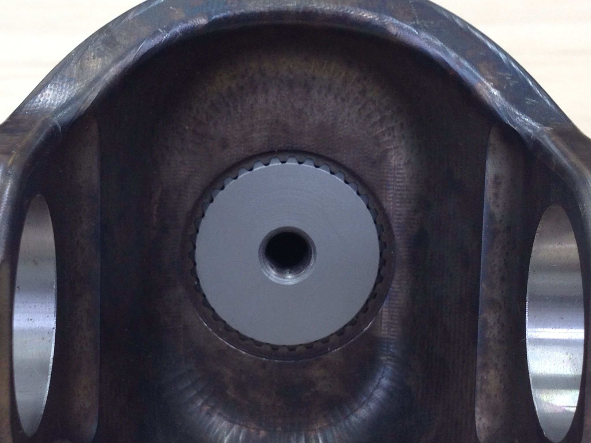

a few off the half shafts... made of 300m heat treated and shot peened. 35 spline to go from rd 99 air locker to the CTM joint them stub shaft to the portal box thumb.gif
