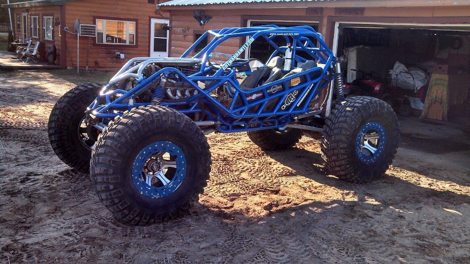

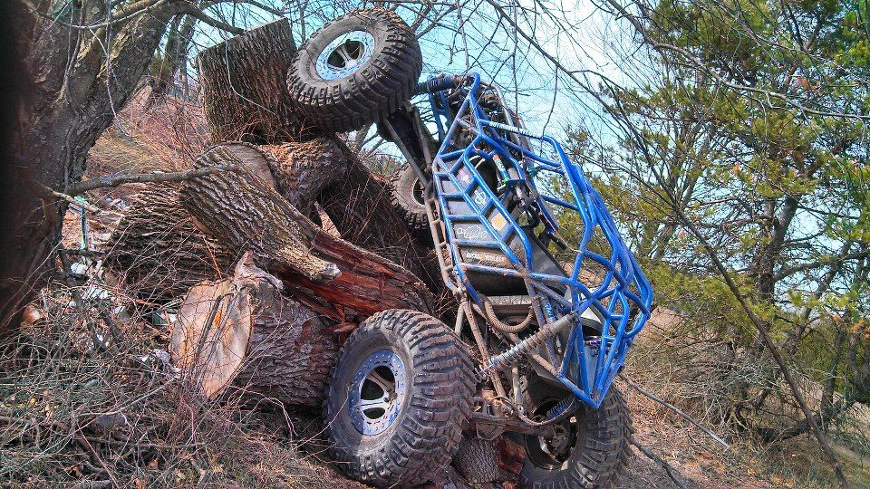

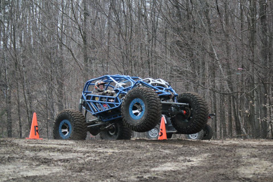

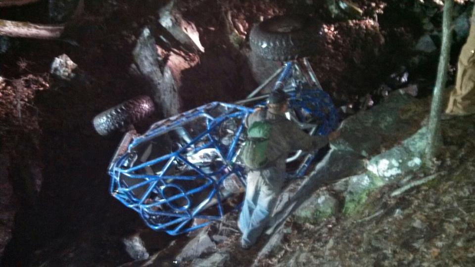

had a great weekend in the jiggler until late sat night..bent a rod after i layed it on it's side. so upgrade time.wanted to anyway. so new stuff coming before the first round of srrs. lq9 short block.l92 heads,new cam and springs,new tune.(they are claiming around 500 hp) 43's and some kmc wheels.(was rocking some bald and borrowed 39 iroks at hog wild) they brought the suck! aluminum links,hope i can swing some rcv's for my front axle,some new yukon hubs and custom driveflanges. pulling my nv3550 and the novak adapter,flipped dodge 205. putting a late chevy nv4500 and a ford 205 in. and a few more changes. so it's going to be a new baby this summer. its all because of you dang southern people! im having way to much fun coming to new places and meeting some amazing people! couple shots from the weekend!

well getting a little time in it.had a blast at the srrs last weekend.have to do some tuning and some more little stuff and it will be a damn fun machine!
i did test the cage! loller.gif i guess all those assholes on pirate were wrong..it didnt crush in. :****:
What kind of tubing is it made of
188 on all the lower frame,shock hoops and window bars.120 on all the rest.

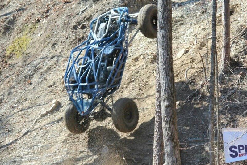

couple other shots i have from hog wild. cant wait to get these upgrades done.going to be a new animal..
well a few more new things on the jiggler.new chevy nv4500,ford 205,complete rebuild on the front axle, 300m rcv's, 46 claws.
thanks.i had a dumb break sat morning so never did much.got rid of that tranny and t case.32 spline stuff now so that issue should be gone.
it still jumps with the 46"s.
