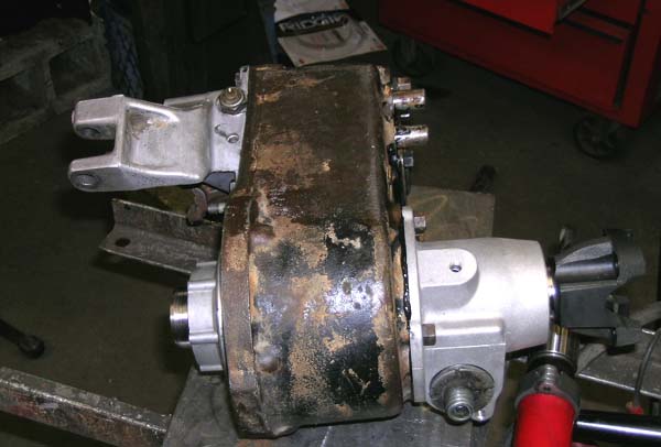

After the first run---drop the pan and change the fluid
You need
one drain pan bolt
some lil plugs for the shifter pelets
The vent fitting tightened
The speedo gear housing installed
I need a new shifter housing---I just spent 5 hours trying to get this fawker together and I cannot get it to shift---the inner area where the rails rides are soo galled up and/or the shift rail is bent :mad:
YOur going to need new shift shaft seals. I had to dril/hone out the shift rails areas and the seals got damaged but they are working now...

We tried to do the Lockrite last night, but couldn't pull the carrier to get the roll pin out of center shaft dealy without a case spreader :mad:

Pull the whole front diff out--you don't need a spreader....
I've NEVER used a spreader...

You mean the carrier with ring gear attached? I thought that's what Sam said would need a case spreader when I called him last night...
Also, what preloads might be messed up doing that? And the roll pin just gets hammered out so that the center pin can come out right?

I have used an axle shaft as a big ass pry bar with great success. Stubborn carriers pop right out every time. Use a little impact to knock it loose, the weight of the shaft is your friend.
