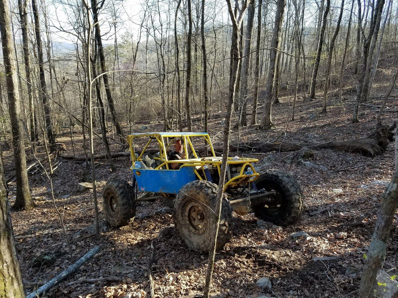

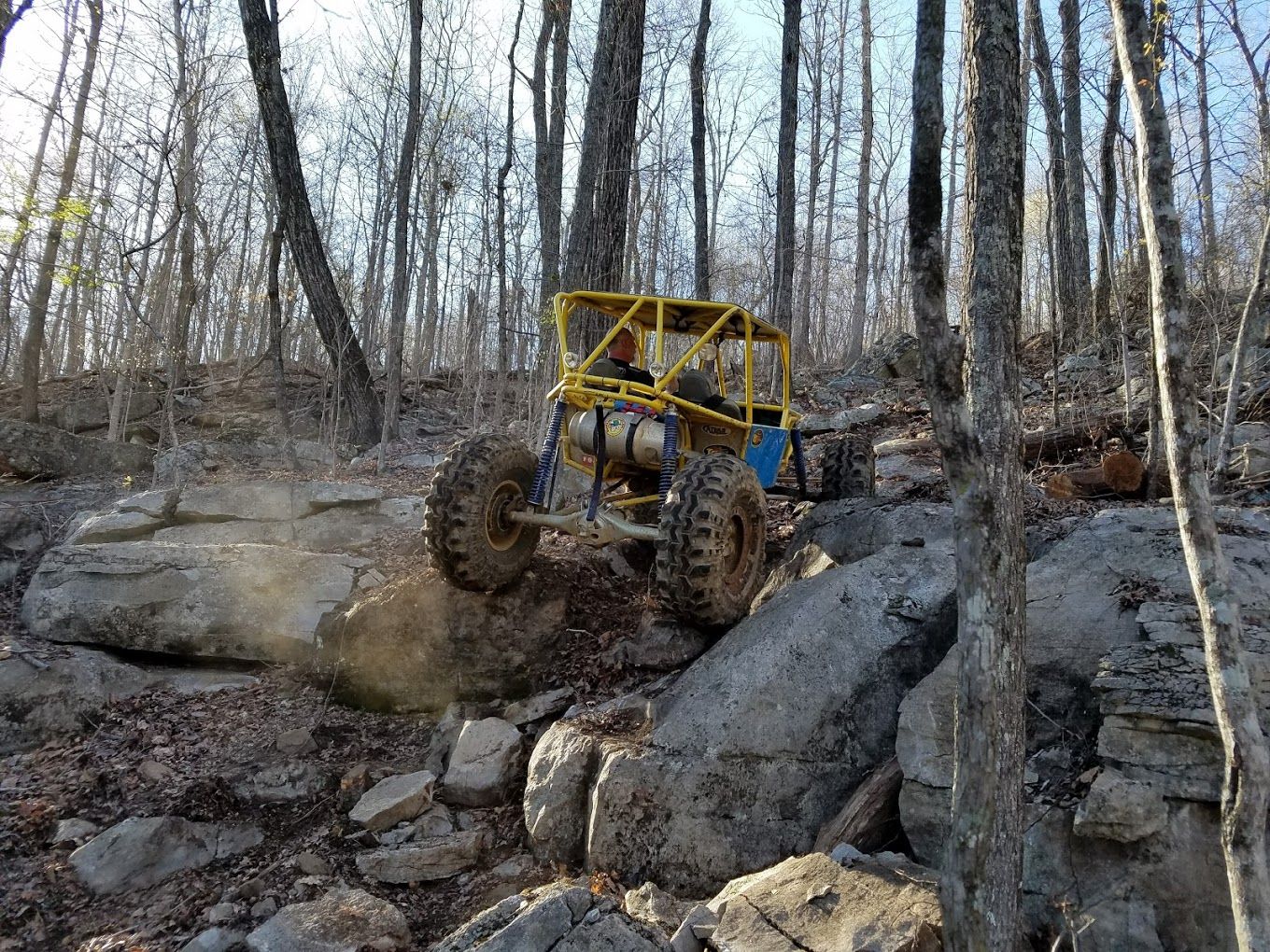

My buddy Bill runs them with 43 stickies. He can drive and pretty much knows exactly when to let out to keep from breaking. We ride together a lot and he typically walks everything we do. Last break I saw him have was a stock parts store brand driveshaft u-joint :****:
Rokcrler said:
Bill is not running mini truck axles
Well...what's he running?
