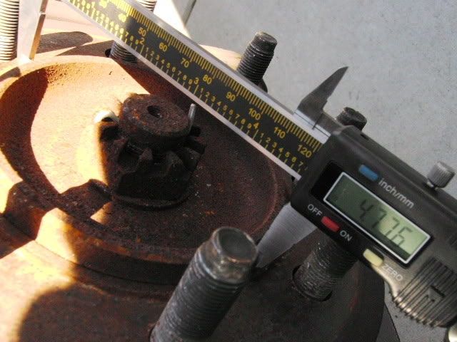

I realize this thread addresses beadlocks, but have a ? on machining H2 centers for chevy D60/14. I don't have my hubs yet, but my tooling guy has time to machine them for me. Does anyone have the center I.D. that these need to be machined too?
While most of my projects are done in this manner, I figured with wheels being hubcentric, I'd just allow my tooling guy to make them perfect for me.
If you have the resources I say go for it. I was actually pleases with my grinder results. A 4.5 wheel fits nicely in the center, a few spins, lots of grind, check, grind, and I had a nice snug fit.
Best pic I could find.
Do you know if that's chevy for sure in that pic? There's an article about modifying wheels for 3rd gen dodge that says to open up to 4.774" ID....just wasn't sure if the Dodge and Chevy were the same size...
Thanks for the info...
