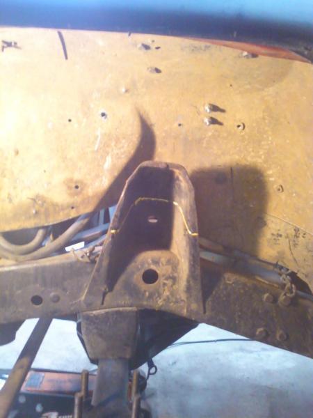

old shock towers:

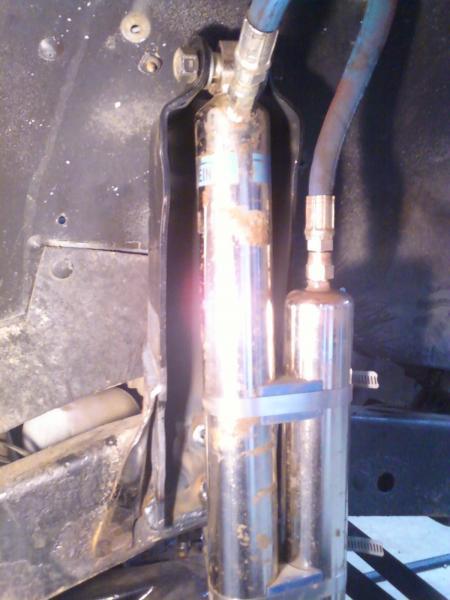

Got the steering box relocate bracket installed today, as well as the design and installation of the first shock mount bracket. Test fit everything, and it all clears for articulation, including while turning. Still need to get some shock bolt spacers.
Driveshaft has been shortened. Will get installed Wednesday.
Then it weld in the other shock tower, as soon as I get a chance.
