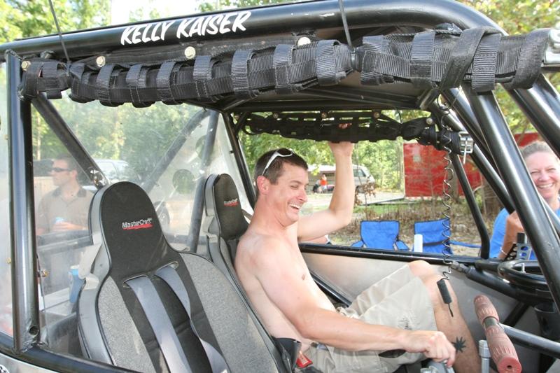

You pretty much have to be able to remove mine otherwise getting in and out is a hassle. I made it long enough to be useable when you are fully strapped in with your shoulder harnesses. Not just a lean forward when you have you lap belt on.
Kelly initially dismissed the whole thing, but the clown had his flailing arms going to town and hit the kill cord at one point from then on he realized that if he was holding onto something he had control over his arms.
What are your options? tuck your thumbs under your shoulder harness? I'm saying at speed with terrain or just rough terrain alone you have nearly zero control over your arms unless they are affixed (gripping) something.
I even added a Poly Performance tube handle to the side bar right next to the passenger seat for another grip point.

Yeah you really need something. There isn't **** to hold on to in your buggy.
my "flailing" was trying to hit the cutting brakes for a non multi talking driver :flipgotcha:. that fuggin kill is right by the brakes.
I don't use wyatt's but I can see how people might. I like the handle down by your right ass cheek (I put one like tha tin heath's, use it too). I found myself using that one more when miles was jumping your **** :flipoff1: Personally I like my right hand at my side to keep me off the doorbar and to hold down with to keep me in the seat or brace up for an upcoming impact. I like my left hand above me to brace up and down as well, but the roof bars aren't safe for that, so we put a hoop below the roof bars (in heaths') I love it and it doen'st block egress.
And I think the footbar helps a ton on the passenger side on mine, allows the riders to push back and sink themselves into the seat.
