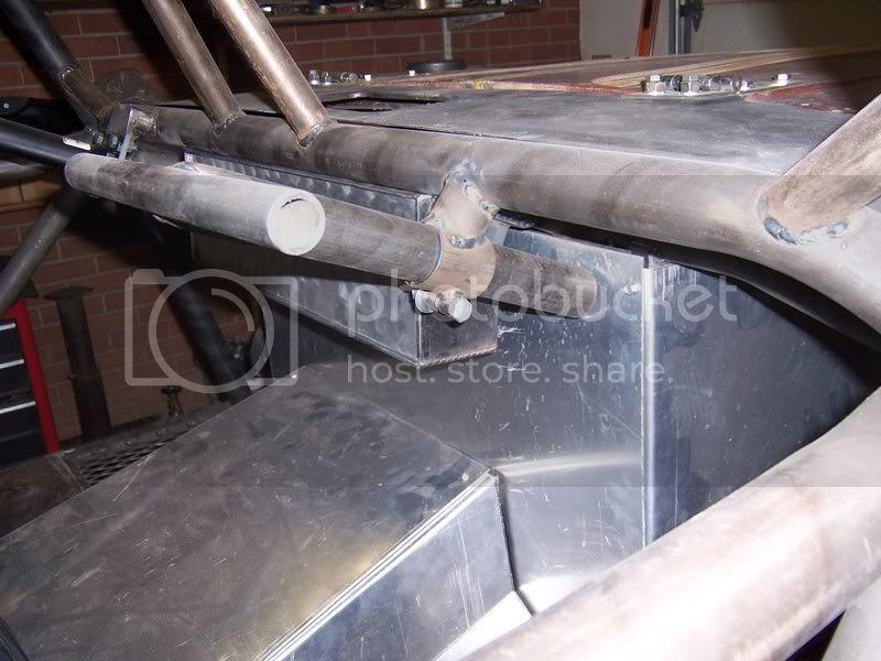

Jim thats a kickass way to do it. The bike clamp would be tits. I had thought about welding mine straight to the chassis but went with the tubeclamp so I could take the whole damn thing off if it sucked or I didn't like it.

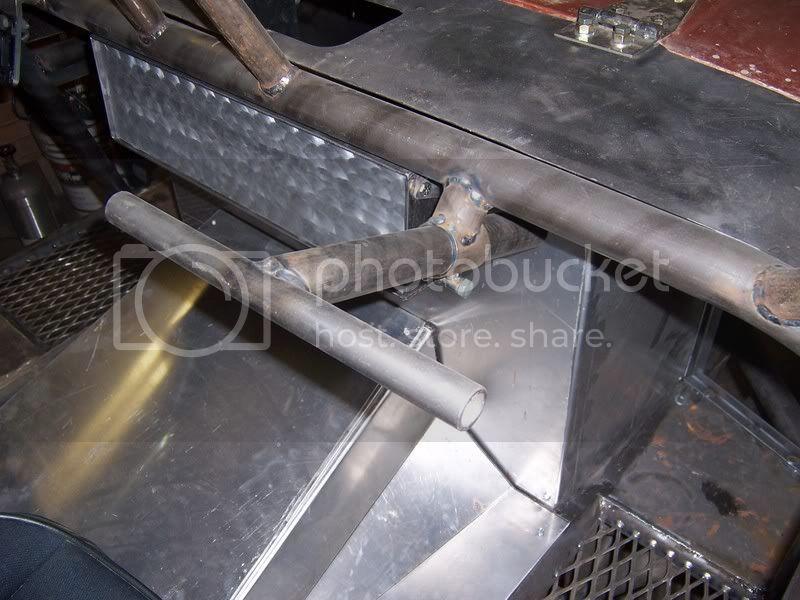

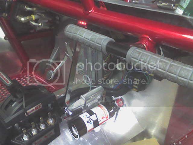

My version. I Used 1.75" welded to the dash bar. The 1.5" for the t handle. Both .120, so the 1.5 fits snug in the 1.75 after some flap disk work, but no rattles or movement. Has various holes drilled so its adjustable, all the way in, its easy to climb in and out, then when you are in, slide it back towards you. Used a 3/8" tractor pin from the tractor pin store thumb.gif I.5" tubing was all I had, which is too big for Moto grips, so I weldered iin some ends from ballistic, but after paint its pretty damn smooth and not bad to hang on to.
Haha, Tractor Supply, But I realized Blowes sells them the other day (Lowes)
