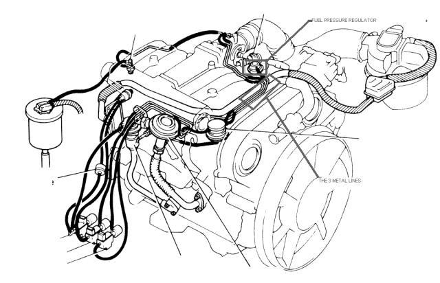

I think i have a vaccum line diagram at home, but that is no help right now.
yeah ive searched and searched but all i could find is this one
but this doesnt show all the lines i needed like the power steering pump lines and a couple other ones

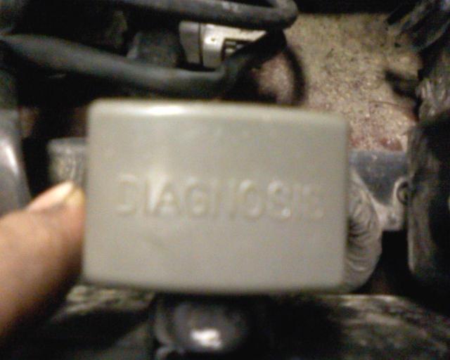

Ok, to check for codes look for a rectangle connector by the fuse box. use a jumper wire between pins T and E1 with the in the on position. Read the check engine light flashes to find the codes.
I dont get it how do the codes display
the check engine light will flash. lets use code 13 for exsample. it will flash once and then there will be a pause and then it will flash three more time and then pause again.
alright so if a paper clip works ill go get the codes , what would happen if its more then one code? That would be awsome if you can come help me get my truck running tomorrow, its been to long
alright ill be right back so i gotta find that box in the engine bay and turn the key to the on pos. and stick a wire in the spots?

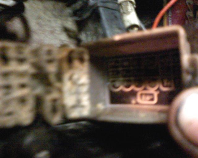

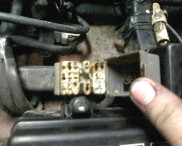

This is what your talking about
... i dont see just T
there is a fp w e1 ox1 ab opt
cc0 te1 te2 cc2 tc
+b vf1 vf2 ox2 ts tt
1g-
thats the inside of the cap
