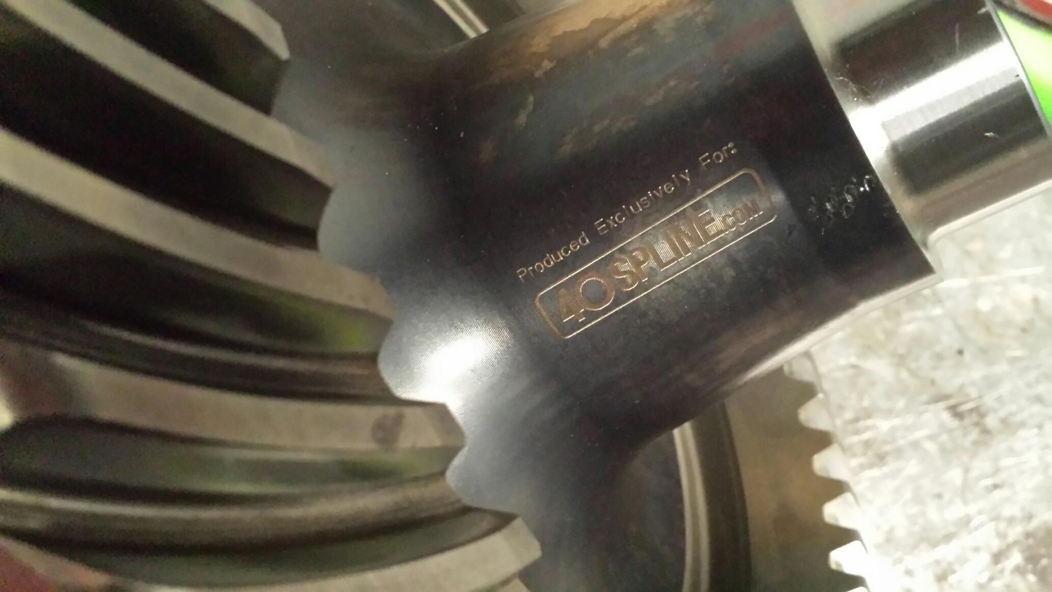

Couple questions for you. Did Ouverson start making cast knuckles? Last I checked, they were all billet. That has to have cut the price down substantially, and that's great! What spline will the rear 14 bolt be? 40-spline? Required new spindles?
Thanks for posting progress and explanation.
Yep they are cast knuckles. Both front and rear axles are completely new, custom housing 14 bolt. Axles will be all 40 spline.
