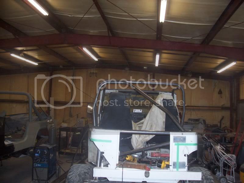

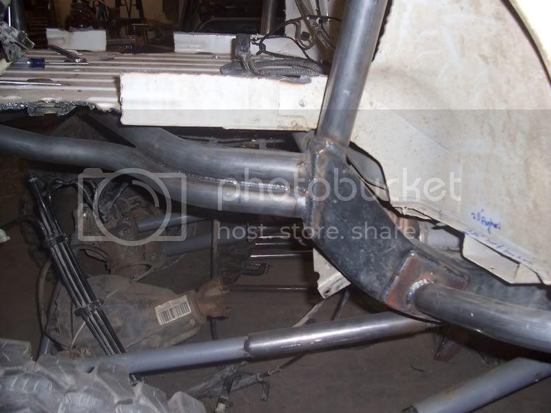

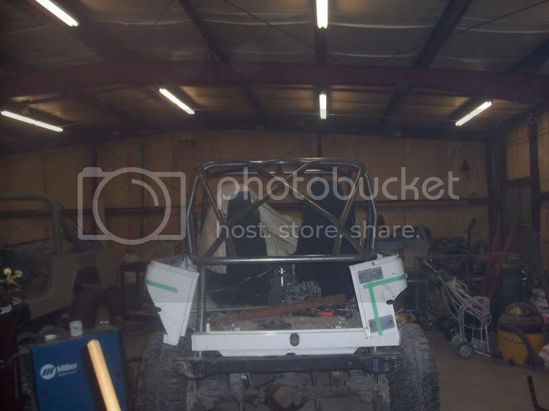

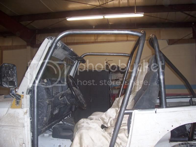

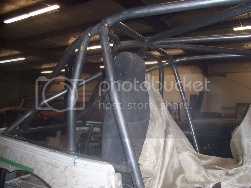

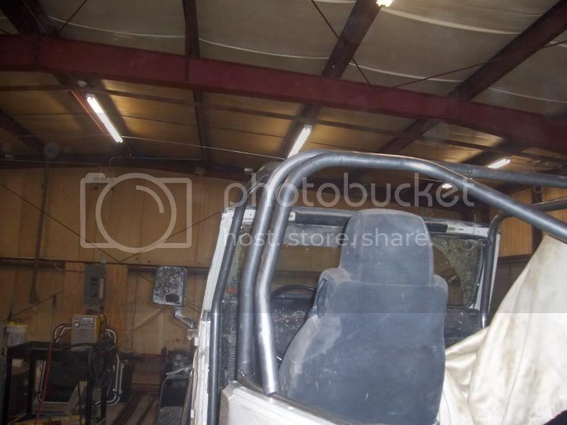

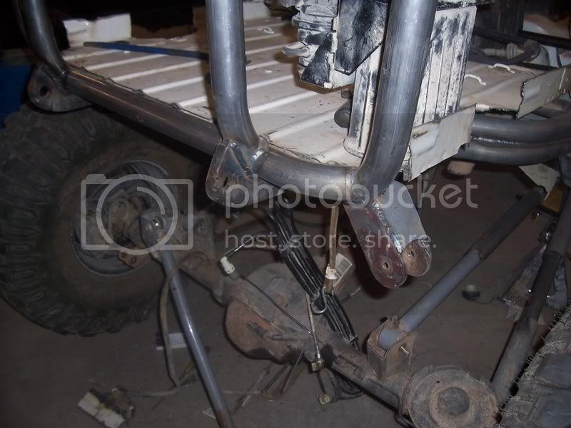

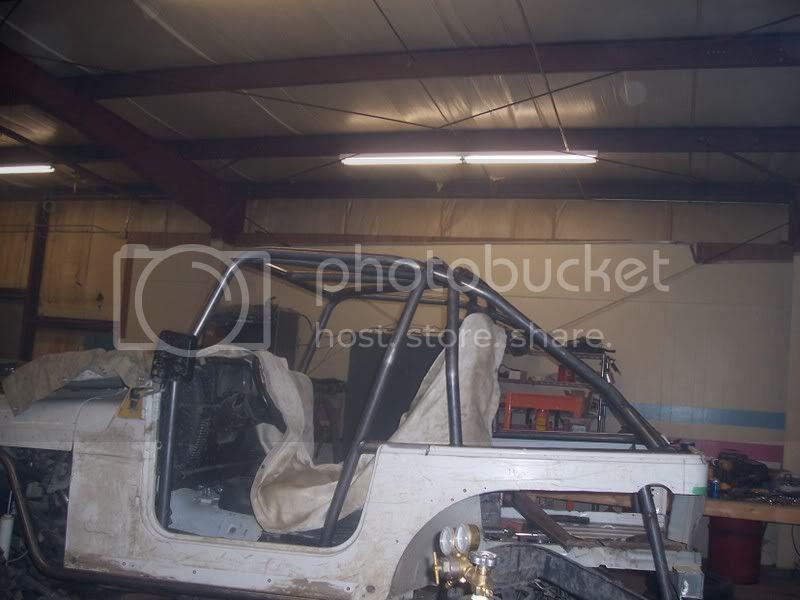

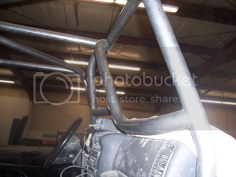

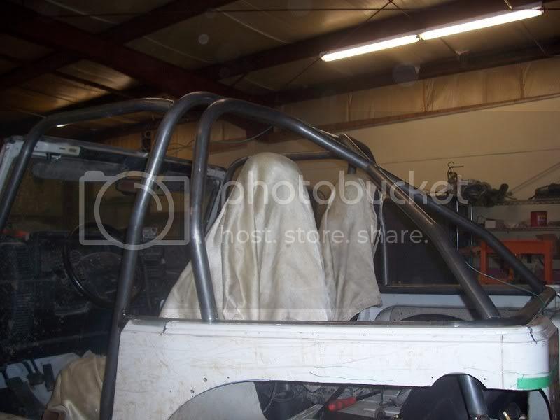

the double B is kind of standard, but I pushed the front B forward so its by your shoulder/head, yet far enough out you aren't running into it. I had the owner sitting in it when I was doing it, that helped. I like the feeling of being captured like in heath's when you're belted in. there is a tube beside your head that keeps the rocks from coming in or the head from coming out. little padding and you're set thumb.gif
I can SEE in that shop :eek: its awesome loller.gif
I miss some of my tools, but it'll work for now. he even has a heater if I need it :eek:

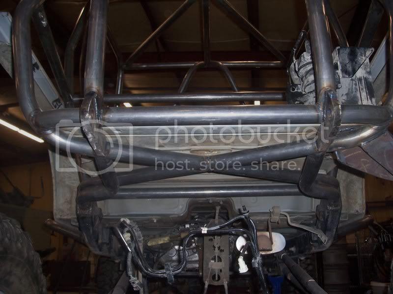

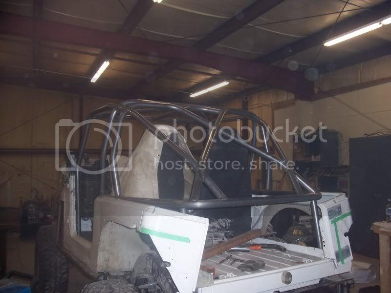

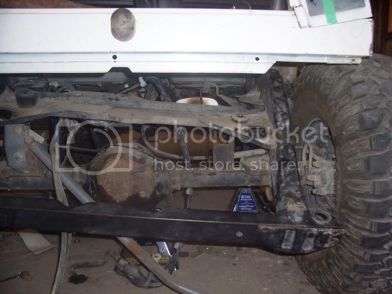

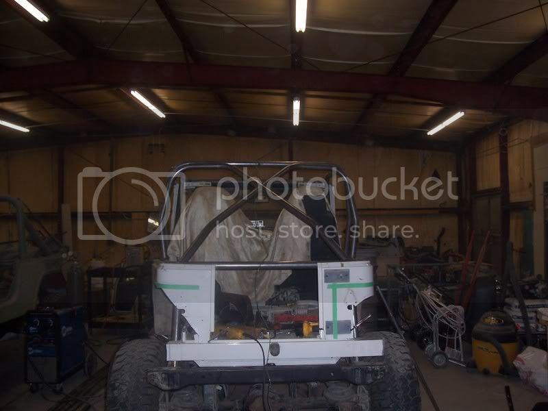

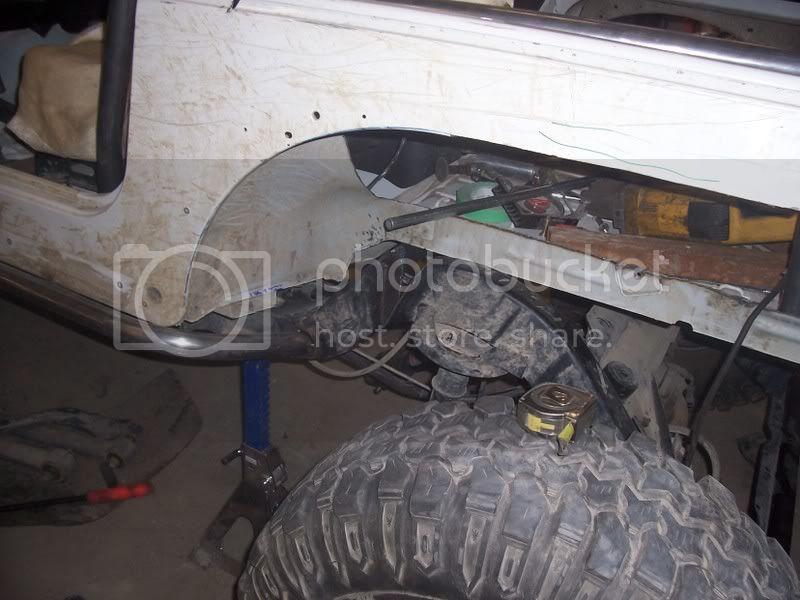

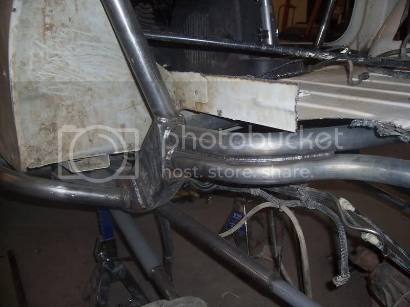

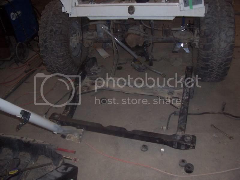

frame is capped, back is hacked off way more and backhalf tubes are half done. he is waiting on airs for the rear to finish it up neatly. loller.gif

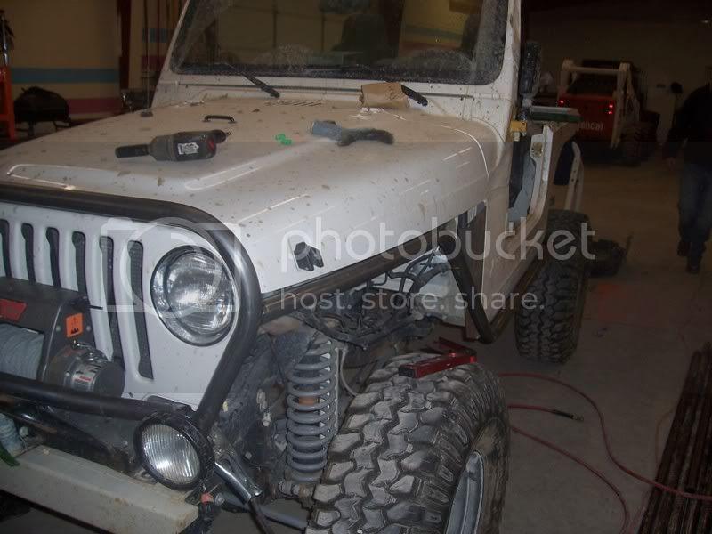

finally got back at it and the tahoe. lots of dodge work and scrapping going on right now. working on a 3K down payment for a certain truck

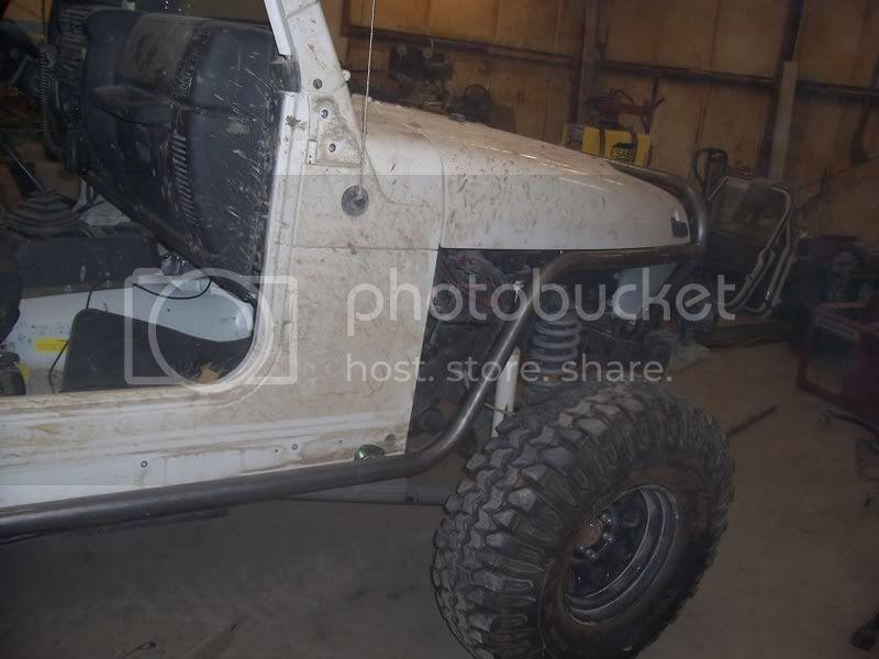

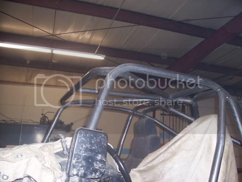

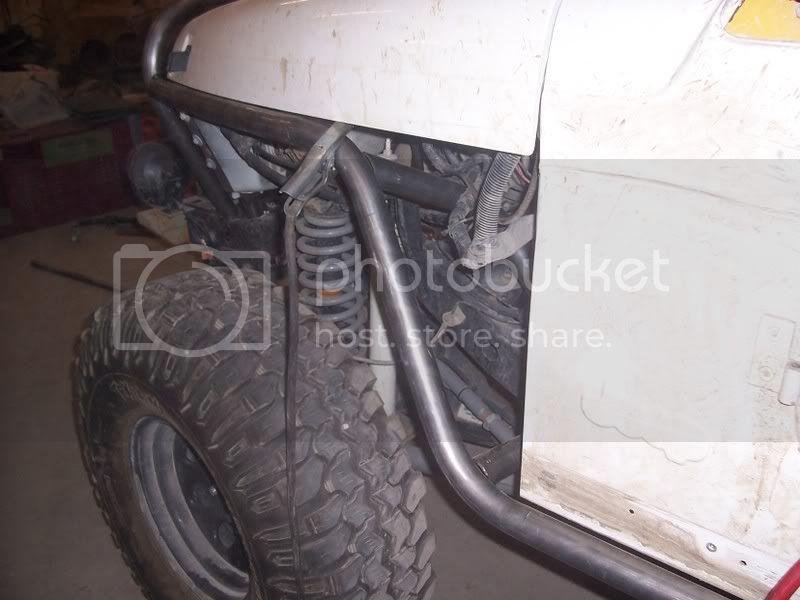

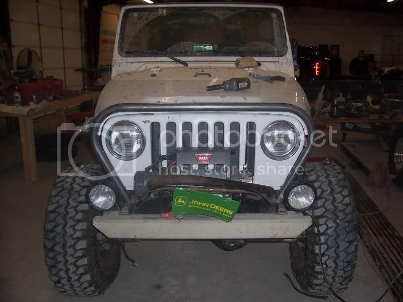

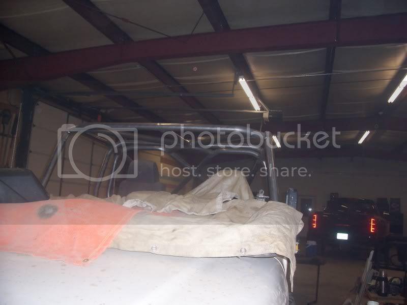

windsheild bars a little funny. the brow is actually in front of the top lip on the top of the windshield. when he skins it, it will dump the water forward over the drip ledge and out the sides instead of into the cab. now, for the windshield to come up, the windshield bars have to come around the corner to get there.
